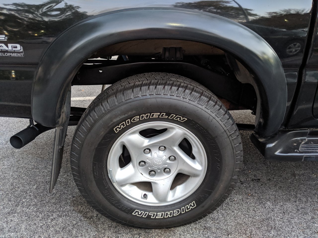

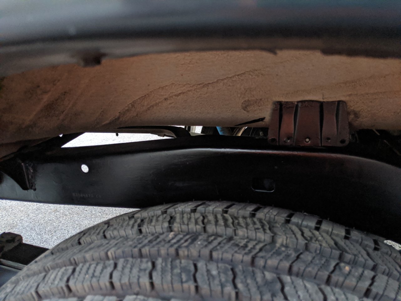

    Started painting the frame with some Eastwood frame paint and rust encapsulator in the areas that have any surface rust. This will be the first winter in salt country so I'd prefer not to take any chances. I already gave the frame an internal coating.
    Would've been nice to pull the bed off but I don't have the time/tools/space/labor to do it, so I'll just be covering what I can access by removing the wheels and crawling underneath. It's hard to see but I painted the brake drum as well while I had the wheel off since it had a lot of surface rust, and I sprayed the exhaust tip with some hi-temp flat black paint. In hindsight, using the rust encapsulating rattle can primer is probably easier than using the brush-on rust encapsulator for the brake drums, so I'll probably use that on the other side.
    Rest of the vehicle is tomorrow, maybe into Monday if it takes that long.

    what did you use for the internal frame coating?
    i had my drums blasted and powder coated a couple months ago for a reasonable price, just a few days of down time is all
    they were not bad, just a little dust no major crust, but they are smokin black now and will see how they handle the first winter

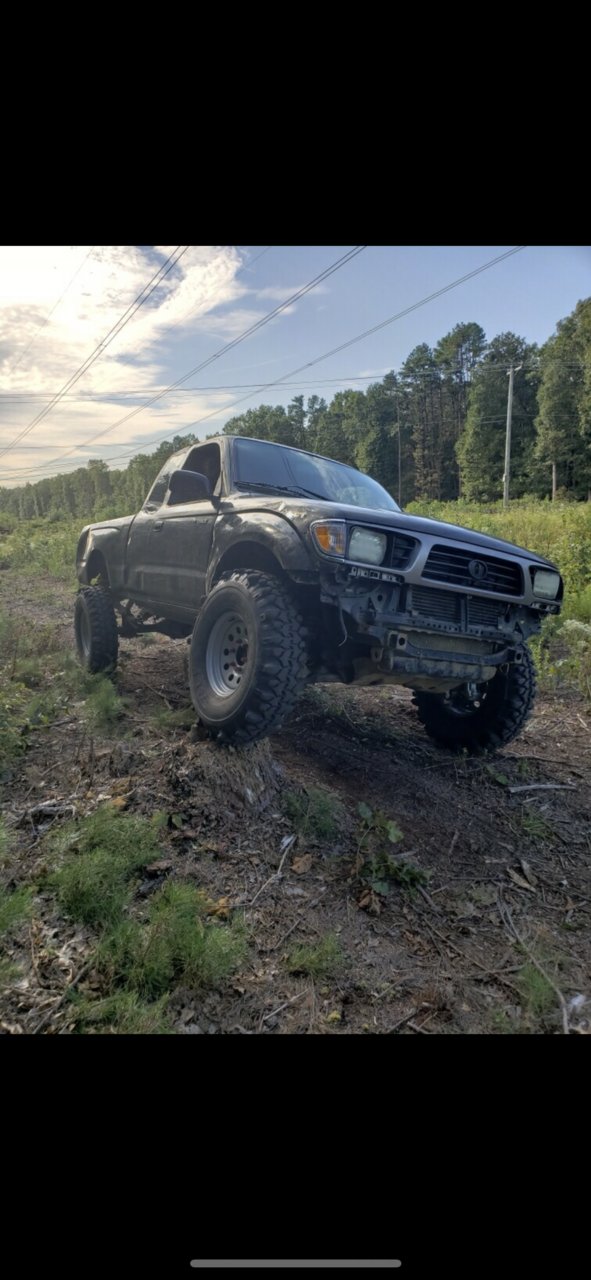

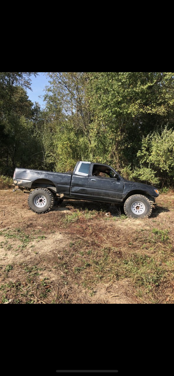

    Got new tires and wheels recently. ( don’t mind the duck tape around the window broke the mechanism but fixed it recently)

    Just a few cans of Eastwood internal frame coating. Had to wait a bit for the black to come back in stock but I wasn't interested in the other green color.

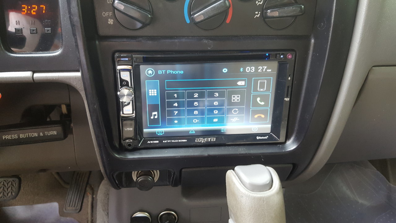

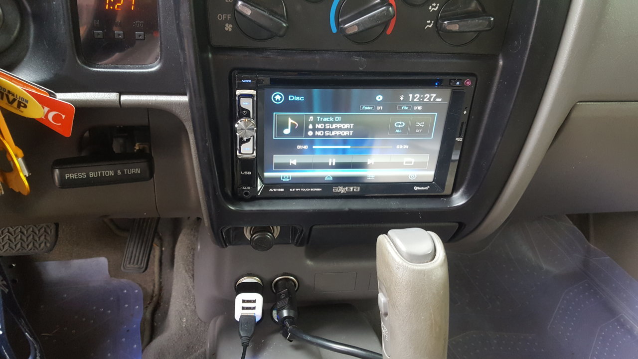

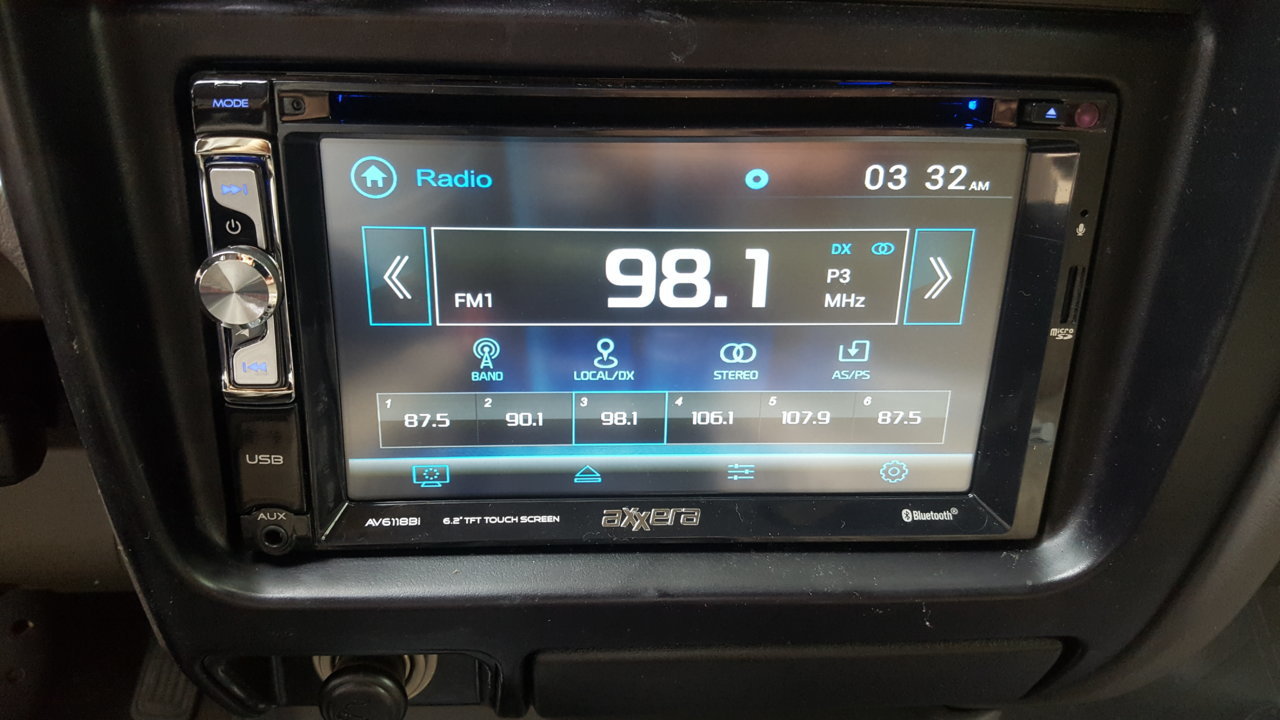

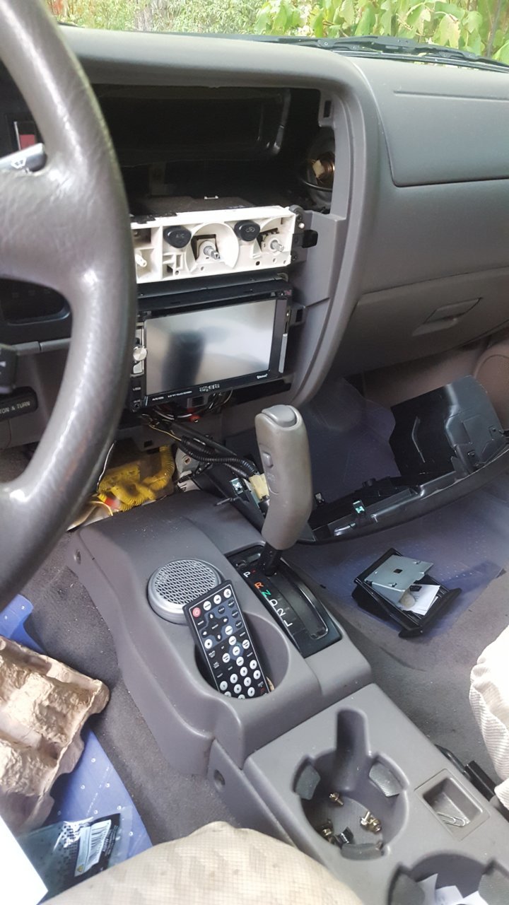

    About 2 yrs in the making. Finally switch the OEM radio to Axxera AV6118Bi DVD receiver, w/ integrated 6.2" touchscreen. Built-in Bluetooth for hands-free calling and audio streaming. Still playing around with it, but pretty good for the price.
