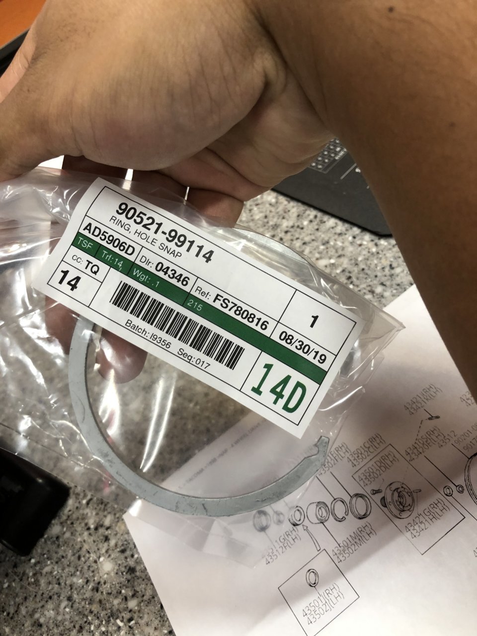

    Guess that giant snap ring the parts counter guy handed me instead of the CV snap ring was a sign. Was pretty damn funny when he handed me a 6” snap ring instead of a 3/4” one.
