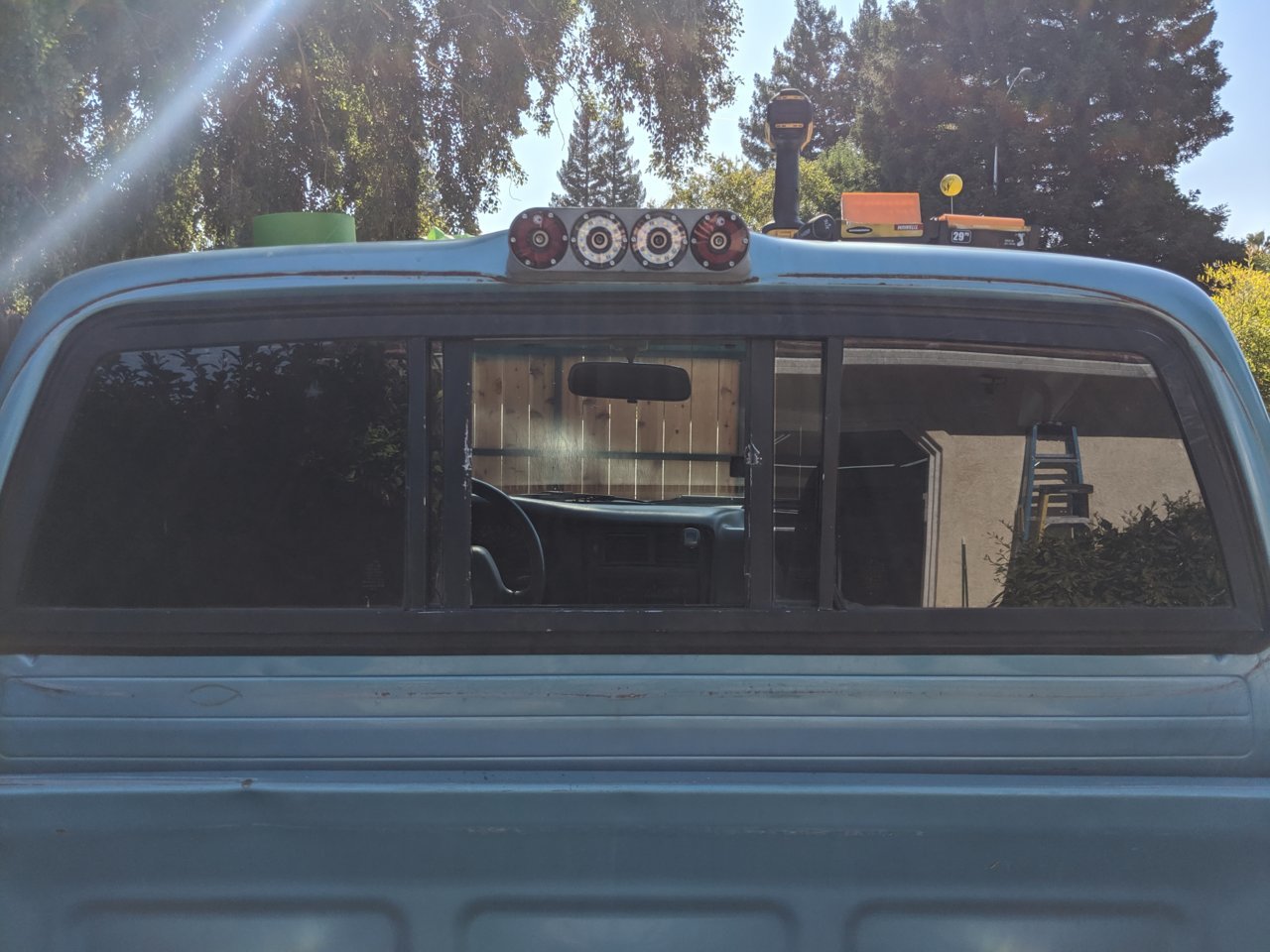

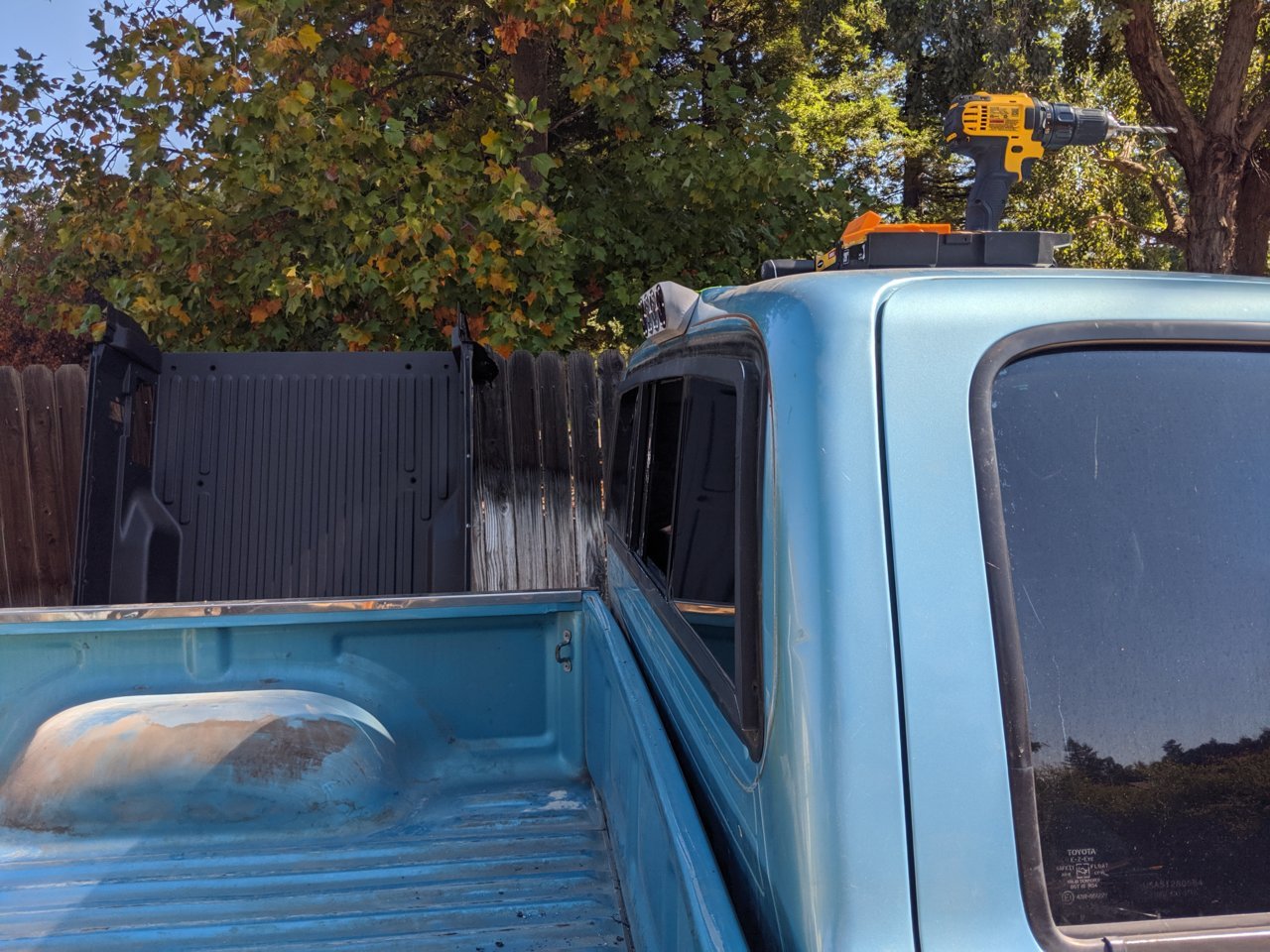

    Doing some test fitting with our KC4 brake light housings. I need to find some nylon nuts to screw into. So strange that each bolt hole is a different size from the factory.
    Pretty cool that it's the same size on Gen 1 trucks as Gen 2.IMG_20191014_124453.jpg IMG_20191014_124603.jpg
