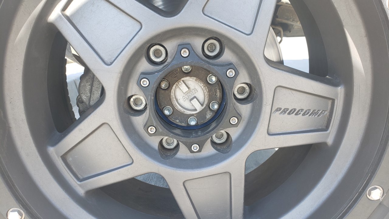

    +1 to the FJ80. Full float. Discs. E-locker. Strong af.

    It's less Tacoma and more mod
    I'll plus one it as well, built like a brick shithouse

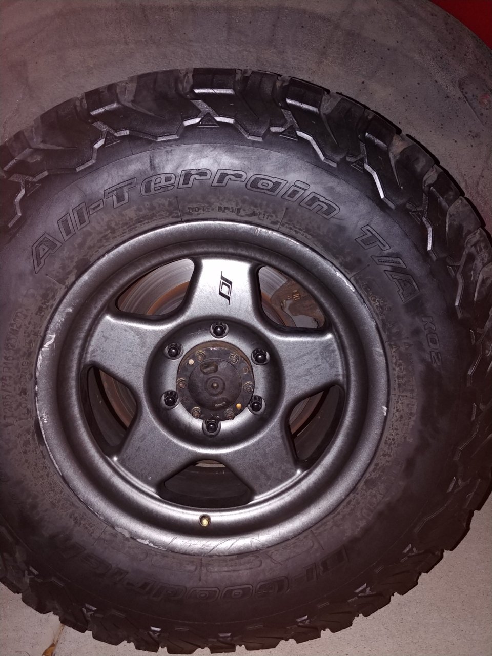

    What's the lug pattern on a FJ80?

    Same lug pattern as 1st Gen Taco?

    Yup, but they're full float so you have to have room for the hub to pass fully through your wheels.
    Some wheels don't bore all the way through for looks

    I believe mine would be good to go.

    @Speedytech7
    What specifics am I looking for, when searching for a FJ80 axle? Years, packages, etc. (I know literally nothing about Land Cruisers other than they are f'n badass and I wish my wife would let go of her Silverado and let me replace it with a LC)

    Yeah, these don't taper like a manual hub, they're the constant 106.xx mm diameter. But your wheels look like they are too so should be gtg. Id check with calipers or a bore gauge before committing tho

    Ya, my bore holes go straight through, and that black trim thing is removable as well.
    I'm almost positive the specs on these wheels said the bore was something like 106mm... but ya, you're right, that's something I'd need to keep in mind.

    Look for an 80 series 91-97 Land cruiser with ABS. If it has ABS it has a full floating axle with disc brakes and a cable actuated ebrake that you can adapt to your ebrake cable. 93-97 will more commonly have ABS. The huge rear hubs are a dead giveaway as are the disc brakes. The non ABS semi float axles have the same pathetic axle end as a Tacoma, and they're not worth buying and they have drums.

    Only issue and minor at that I believe, is the 80 series have an off-set pumpkin from the Tacoma axles I think. I don't think it's much of a concern tho from what I have seen.

    Its not a big enough concern, it's a common swap and I haven't heard complaints of vibes from it.
    Oh one other nugget of info. If you can find an elocked diff, great, but you'll pay out the nose for it compared to an open one and the open one has a stronger driver side axle shaft.... So paired with an ARB that would be the wiser choice id think. Unless you went to chromoly shafts and we're already wired for an elocker like myself :p
