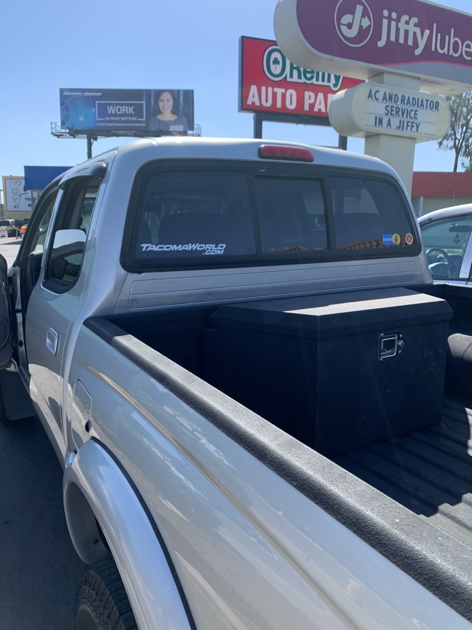

    Finally got my tw sticker! Heard it adds 5 hp:cool:
