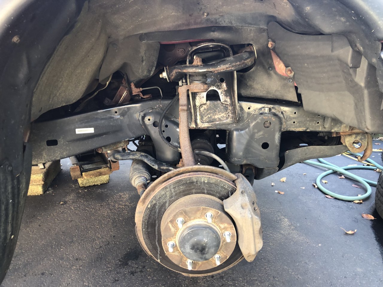

    Oh yea thats a bummer, I stripped all the rust off with a wire brush before painting! So no actual rust below the paint. Picture below IMG_2028.jpg

    oh ok i wasn't sure from the other post if you just painted over the top like por-15 is used for sometimes

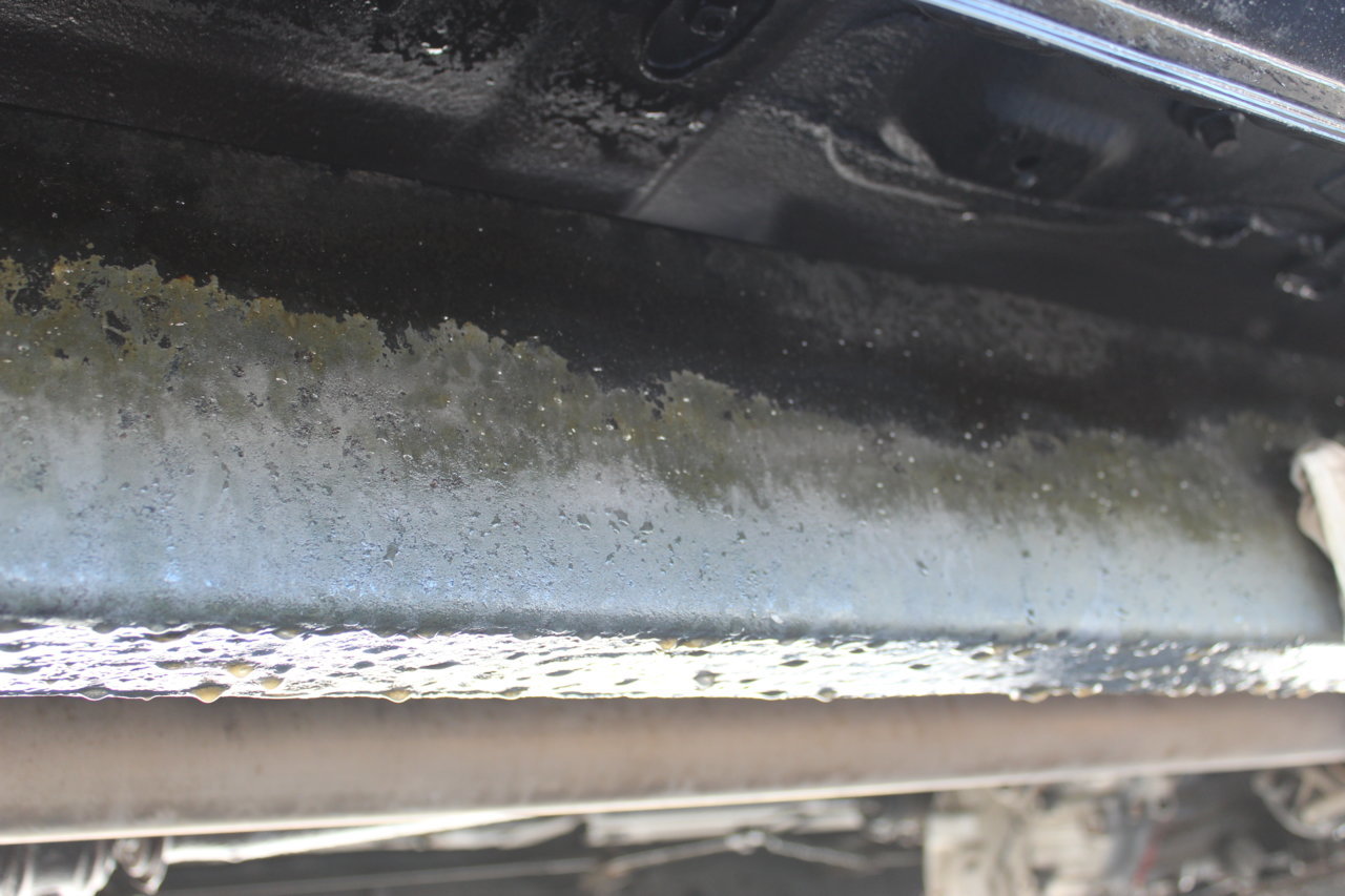

    testing the FF thorough the underbody pressure washer
    day 2 of fluid film testing for durability
    looks as though some spots are already wearing off after the drizzle it got :notsure:
    bottom looks ok, possibly because the underwash does not hit it with the high pressure like it does on the rockers
    wish there was some hard rain in the forecast to really test it out!

    How many cans did you use for your frame?

    maybe half a spray can so far, but i did not spray the whole thing, just where i had naked steel with a zinc coating on half the passenger side, (first time user it seems like i overdosed it lol, just gooped it on all over)
    trying to prevent flash rust until the weather gets over 70s for several days to primer and maybe paint weather permitting

    I don't know how you plan on getting all that FF cleaned off enough to be ready for paint.

    i don't either! i am going to see how the phosphoric acid works and what i get on the white rag wipe off
    somebody in St Louis told me to use hot pressure water :notsure:
