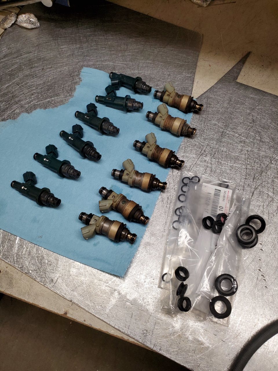

    Today I snuck some 440cc injectors in. Quick map adjust on the Fic and she fired up like nothing happened. Actually idles better than with the stock injectors. We shall see how long the stock pump can keep up. 20191018_134547.jpg

    You super charged?

    Yes. Stock injectors were maxed out, afr would start to creep in higher rpms, not that I really use high rpms, but want to keep it safe.

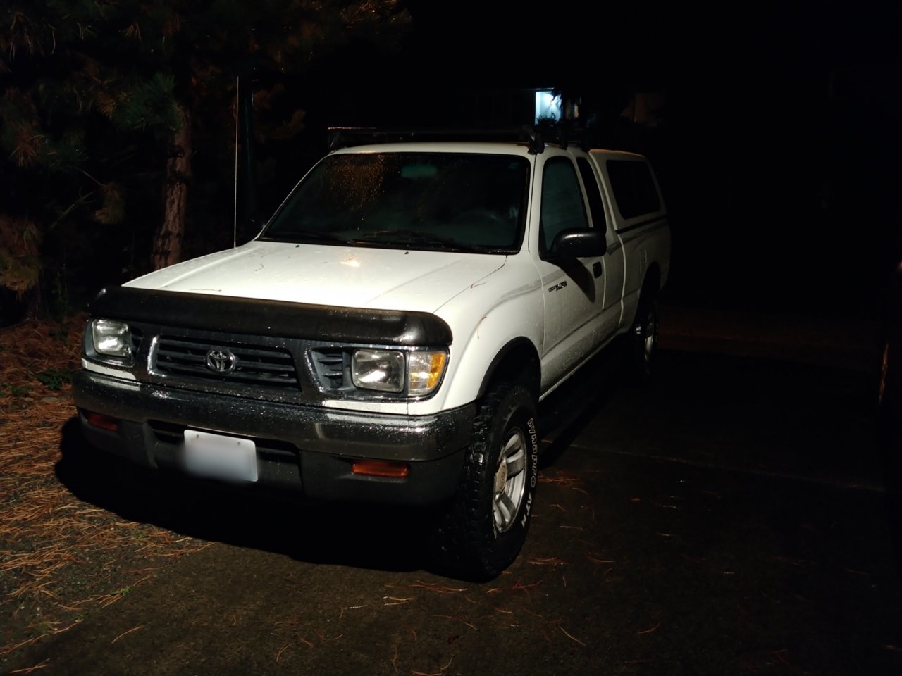

    Well, I got another one... So I guess I'm back in the Tacoma game....
