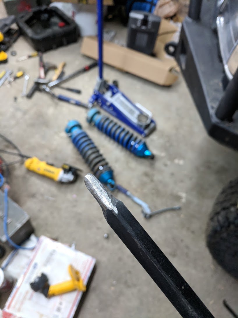

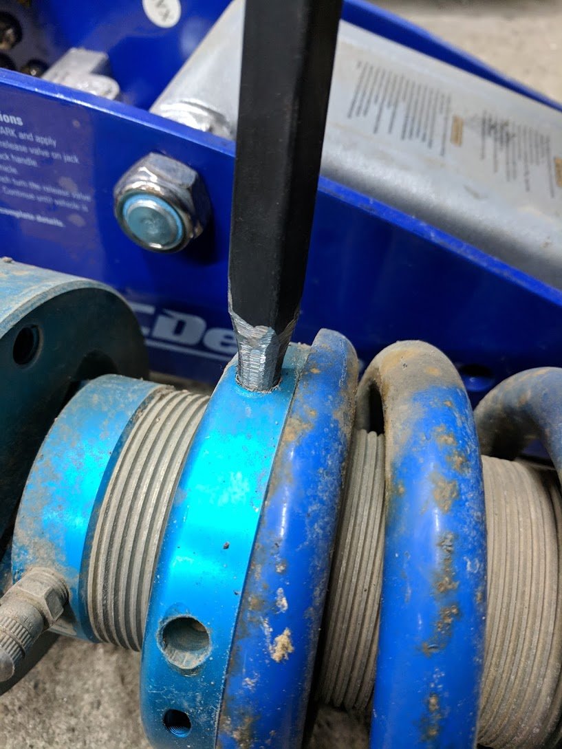

    if you don't have a good adjuster tool, don't buy one. They all suck.
    Make one from a cheap pry bar.
    2TEtWl377wv9sI5S0Ohn2lHzX26WPypYJlC3fwS8_d12de3b1d5da511b8e7901ab68a68d9577c839ac.jpg
    I just ground it down till it fit.
    nYZ0rd29LHU-JzsYUhTqXtdVBQks2MqTuEgOoqIc_d561d40a87e681f414de418c55289ff6afe48580.jpg
    However, I'd tweak the design by NOT cutting of the angled tip. Instead just grind the angled tip till it fits. This way you can fit the tool with the coil overs on the truck since due to the hole spacing and the restrictions of the wheel well you can't do it with a straight one.
    Works way better than anything else i've tried. Doesn't bend like every other thing i've tried.

    Right on :thumbsup:
    I've seen the space restrictions and trying to get in there with tools that don't work (on others trucks). Definately will remember that.

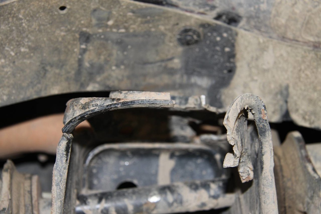

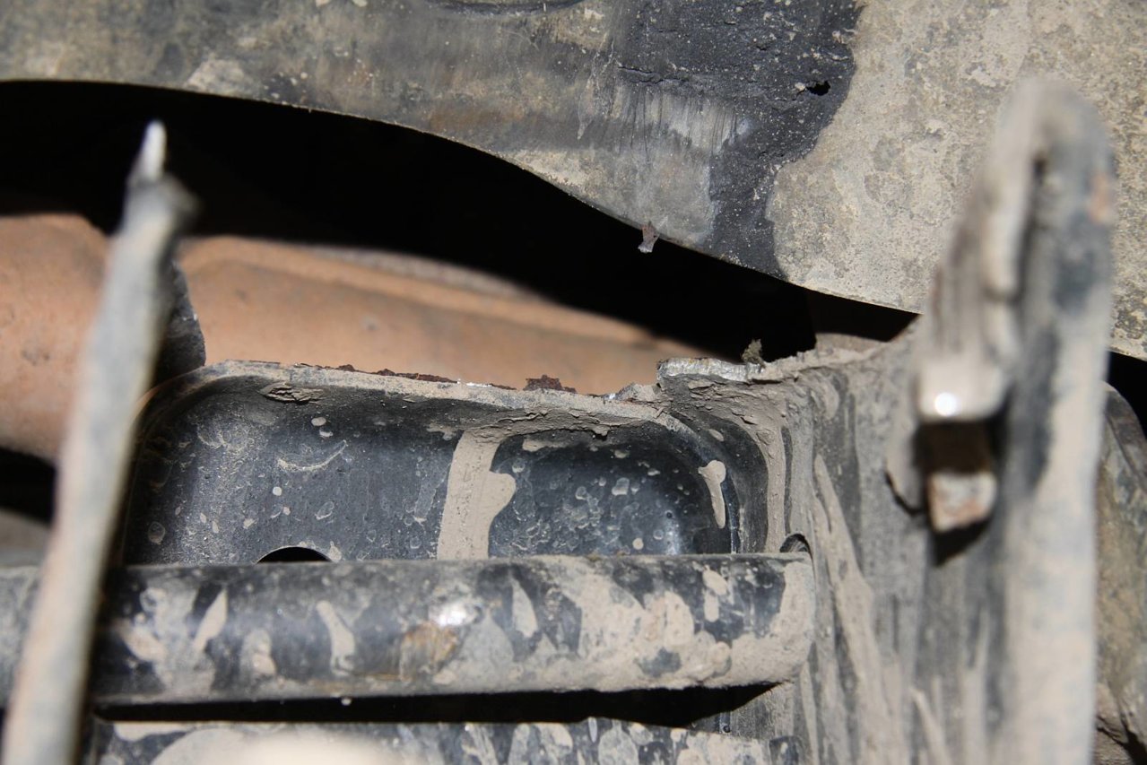

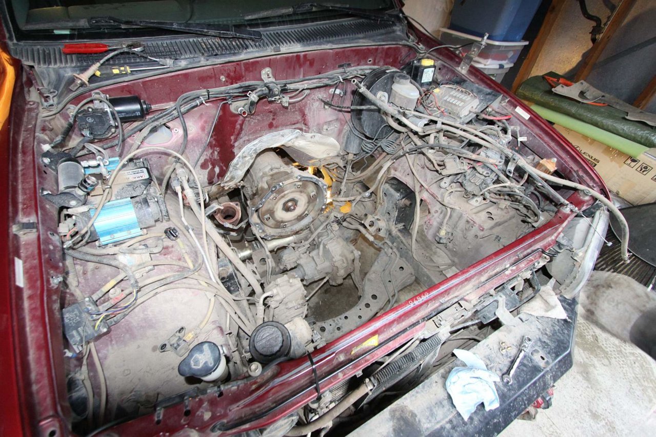

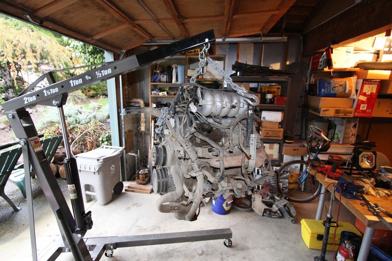

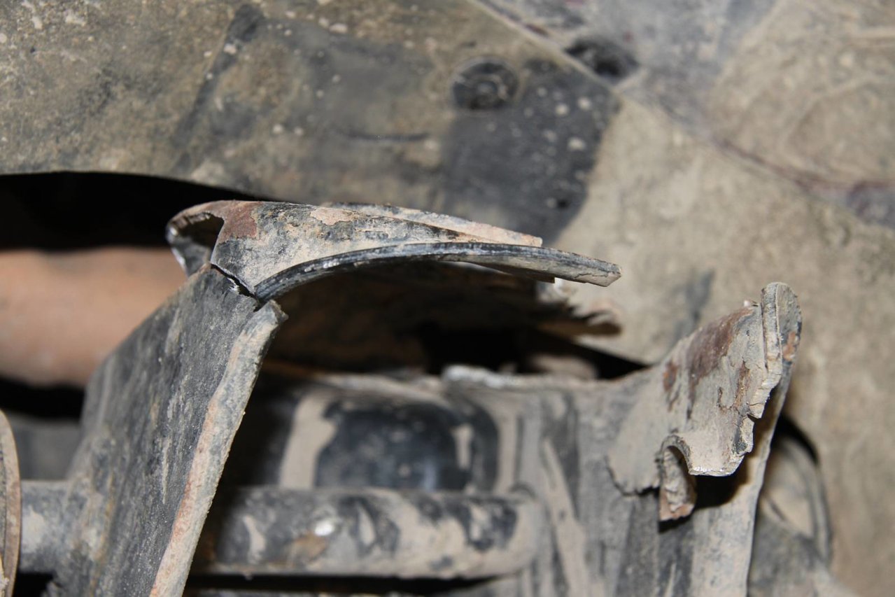

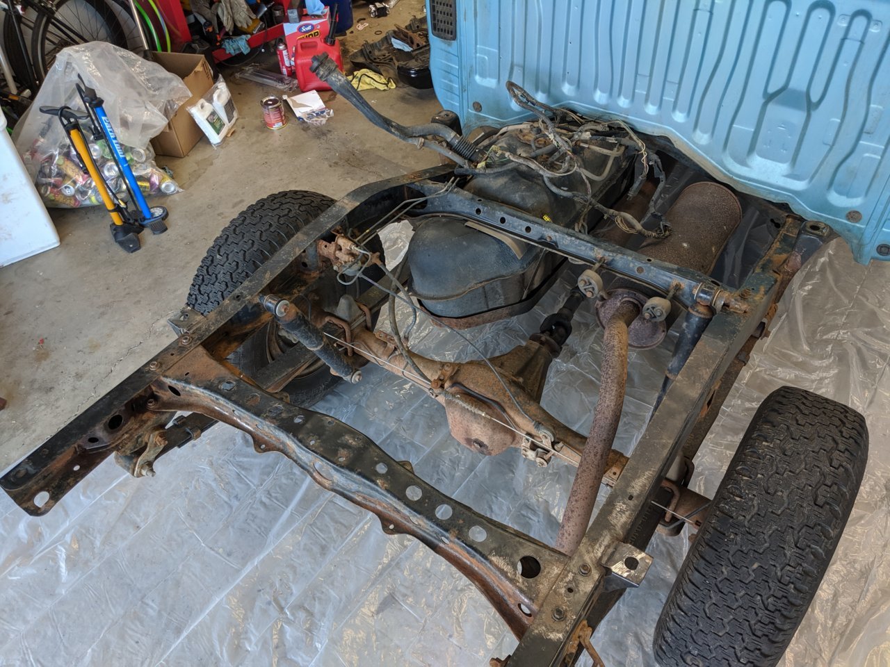

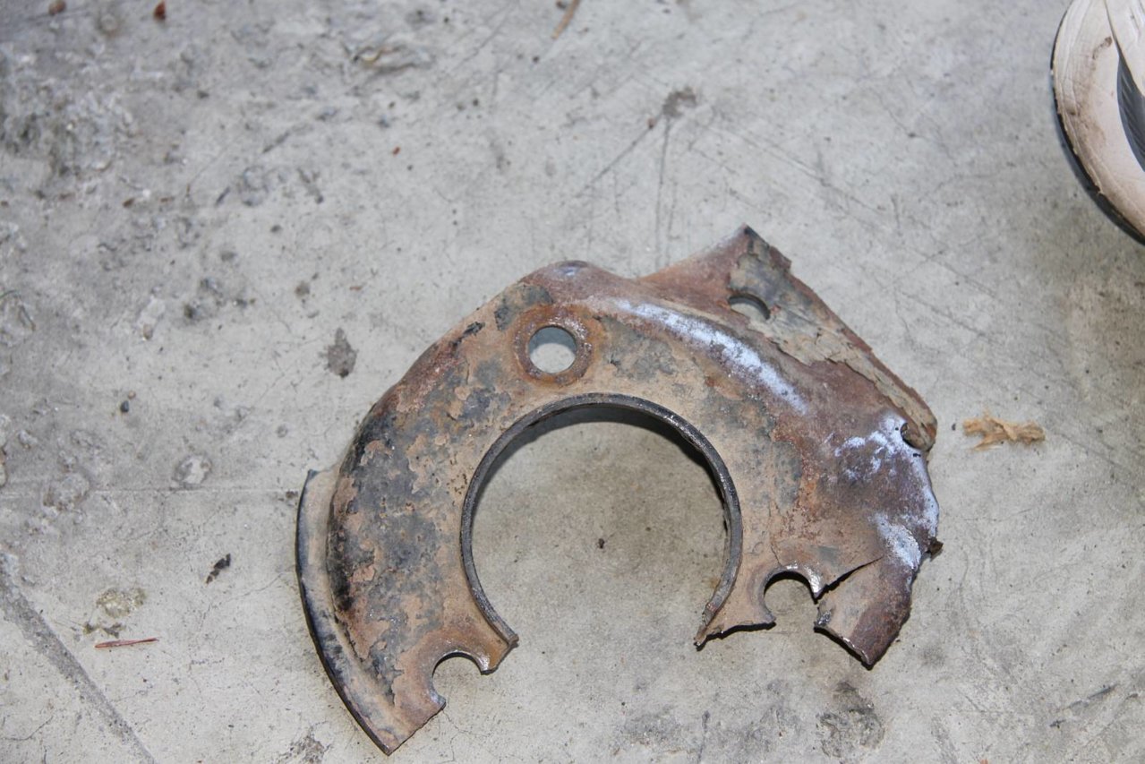

    I destroyed the passenger side coil bucket on our last adventure.
    We removed the engine to be able to access that area of the frame to facilitate replacing the coil buckets and the engine perches.
    The plan is to start repairing the frame mounted items this coming weekend. You are certainly welcome to stop by and check things out.

    holy shit, things destroyed!

    The good news is, parts are available to fix it. Thank you Mr. Toyoda.

    oh trust me i know the parts are still there (this dumbass has a brand new frame sitting in the garage...)

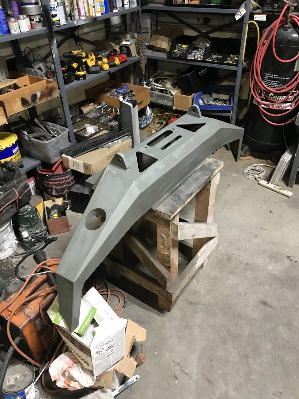

    Finally applied first coat of primer
