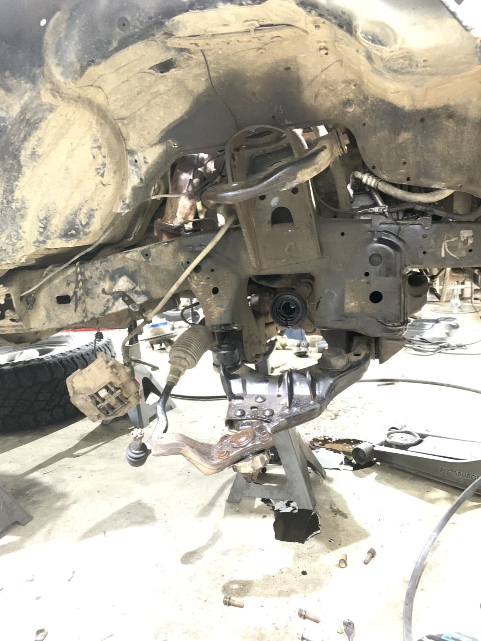

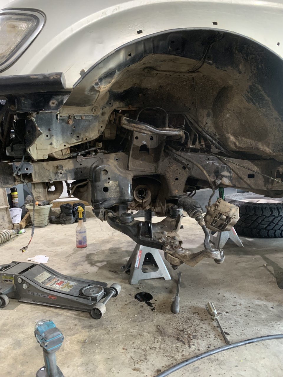

    Made some progress on the truck.
    0B7E1E09-C9F8-4792-9309-1CAAE72D3718.jpg 4458F630-2AAE-4B85-8932-A15738ECD6D9.jpg

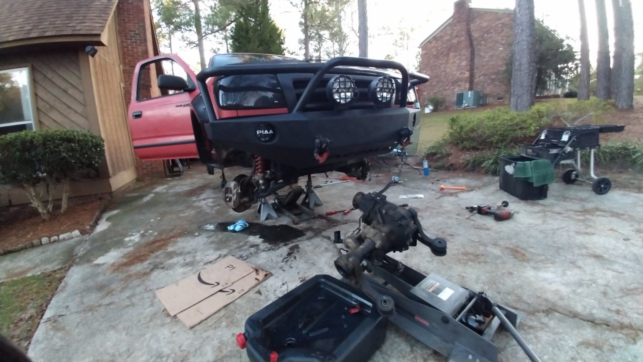

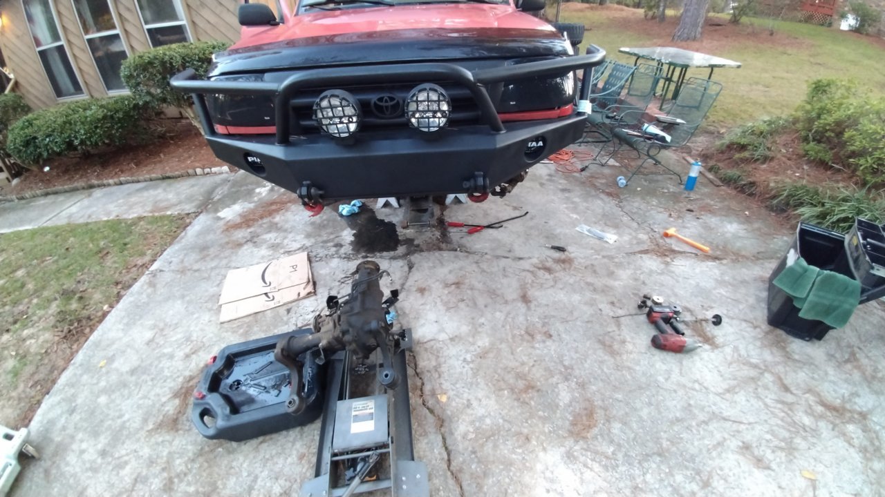

    Put in some work today.
    I'm expecting some damaged after being an idiot with the skinny pedal during my last adventure.
    But at this point I'm thinking 5.29's and a Spartan locker are going in regardless.

    Did you need to pull the rack to get the lca’s out? I’m going to be there soon.
    Uca’s and lca’s are next. Should the ITRE’s be able to hold themselves up? Or are they fucked? No play in the lbj’s but I’ll replace them and use these as trail spares

    I unbolted it but didn't remove the line and was able to do it. Might save yourself some frustration and completely remove it. I think the long bolt was what was annoying me.

    You’ll have to loosen all the bolts and nuts, it’s moved about 1 inch back on the drivers side and moved back clear of the mounting bolt on the passenger side. You’ll have to lift the rack up slightly to pull the rear LCA bolt out.
    I’m not sure what you mean with the ITRE’s, mine are hanging freely with seemingly no issues.
