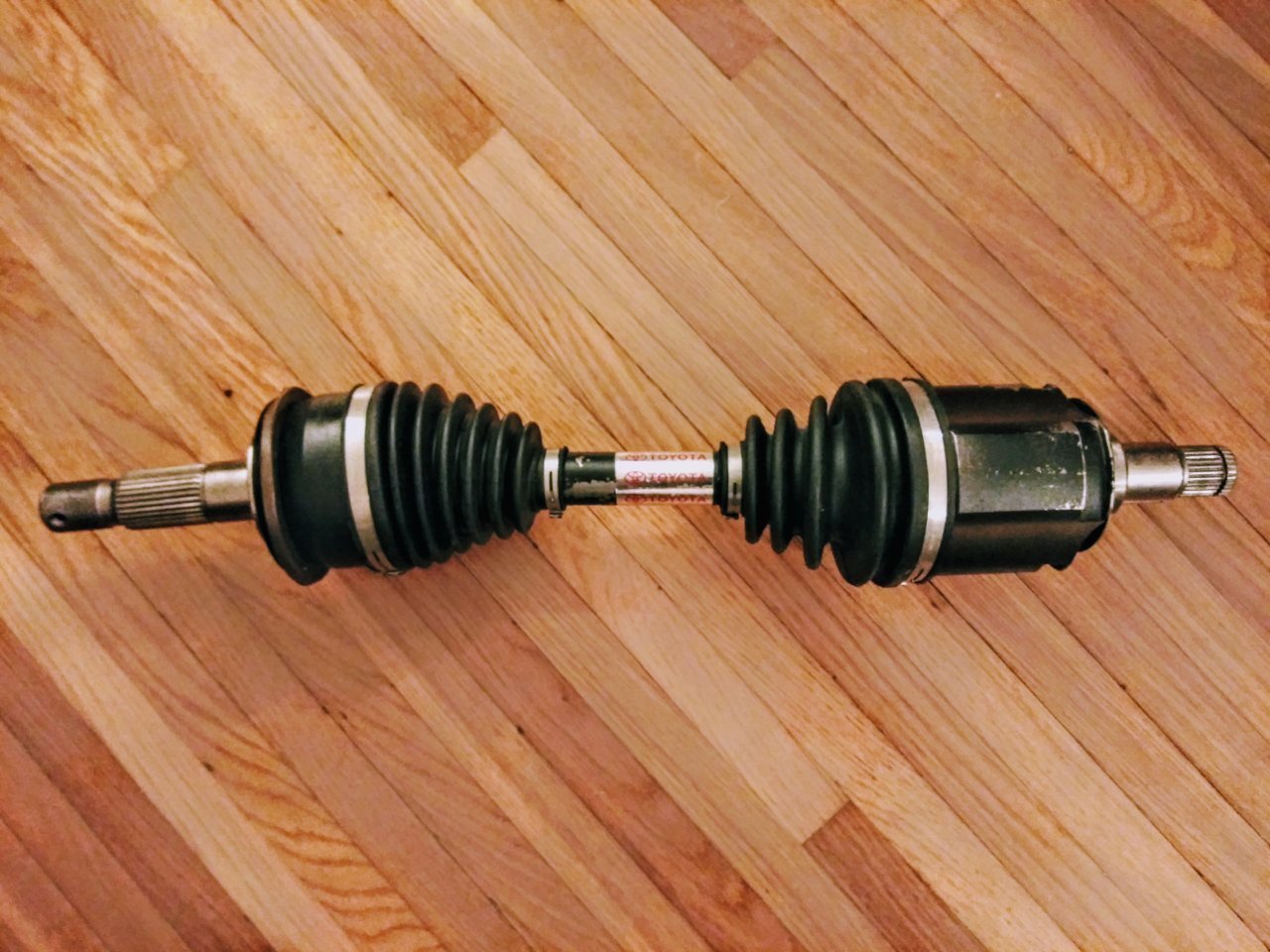

    #105887

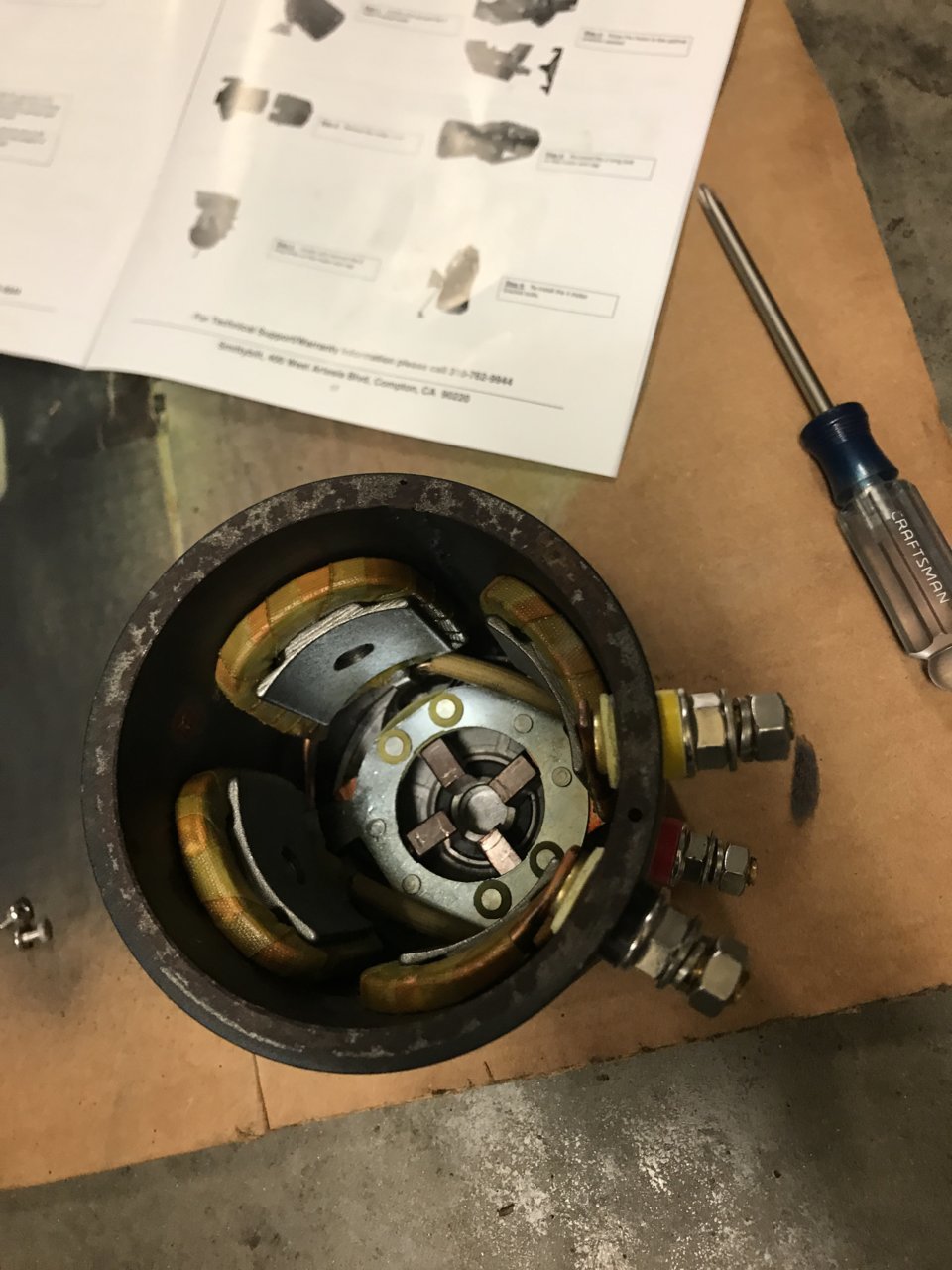

    Help! How the fuck do I get the motor back in?? Shittybilt x20

    I figured it out. Had to pop the cap off the other side to get to the brushes.
    Now the solenoid won't fit where i mounted it. Have to make a homemade bracket for it to sit on the bumper :( or just use industrial Velcro lol

    Can you use a pick and push back each brush from the other side one at a time while applying pressure
    from the coil come through? Or can the brushes be removed and reinstalled after the center section is slide in?

    Weird thing though is their website didn't specify manual hub or ADD axle when I ordered, but the part number was correct, so I placed it. Of course they sent me a manual hub CV. So I called them and they sent me an ADD reman instead. Not sure why they don't make it clear online but it might be best to call before placing the order to make sure you get the one you need.
    the ADD remans look like this...the green decal is taken off and replaced with a silver Toyota logo sticker.
