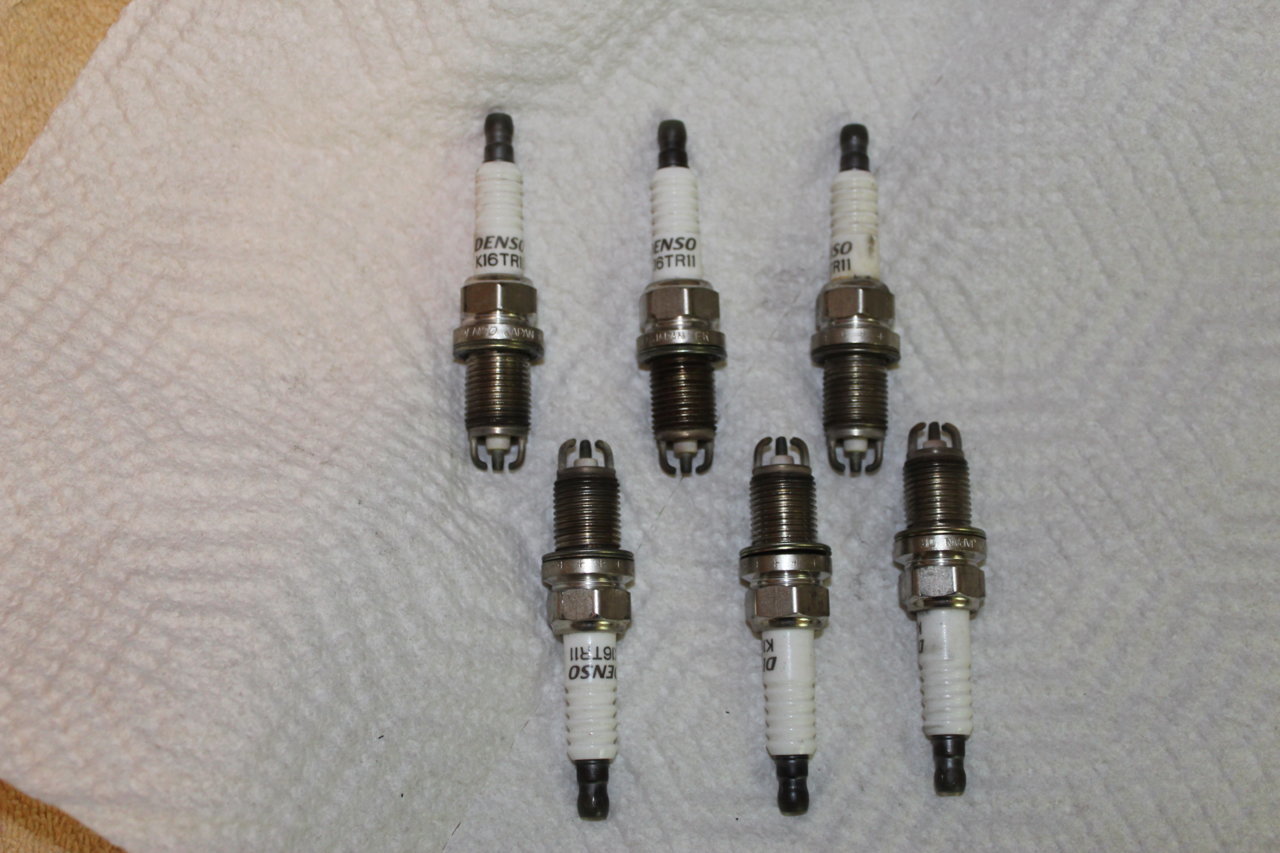

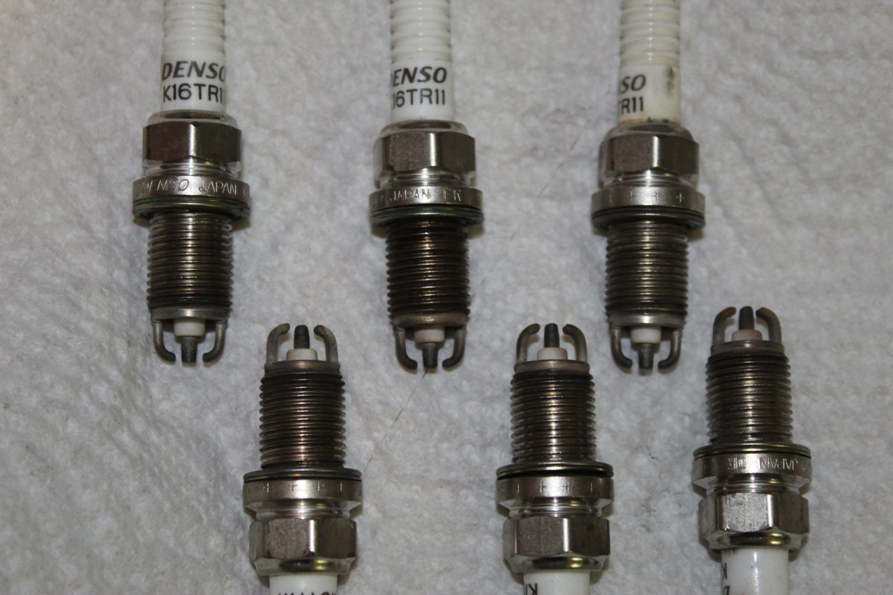

    got these plugs changed earlier this week ... about 39k miles on them
    i do not have the foggiest clue if these look 'normal' or not after that amount of usage :notsure:

    Those have 40k miles on them? They look excellent. I'd easily guess that the engine cylinders are in very good shape. The plugs don't look oily at all. They don't look hot, or like they're run over temp. The porcelain around the center electrodes are nice and clean and uniform.
    There's you an analysis, just be careful though, the analysis might only be worth what it costed you :rofl:
