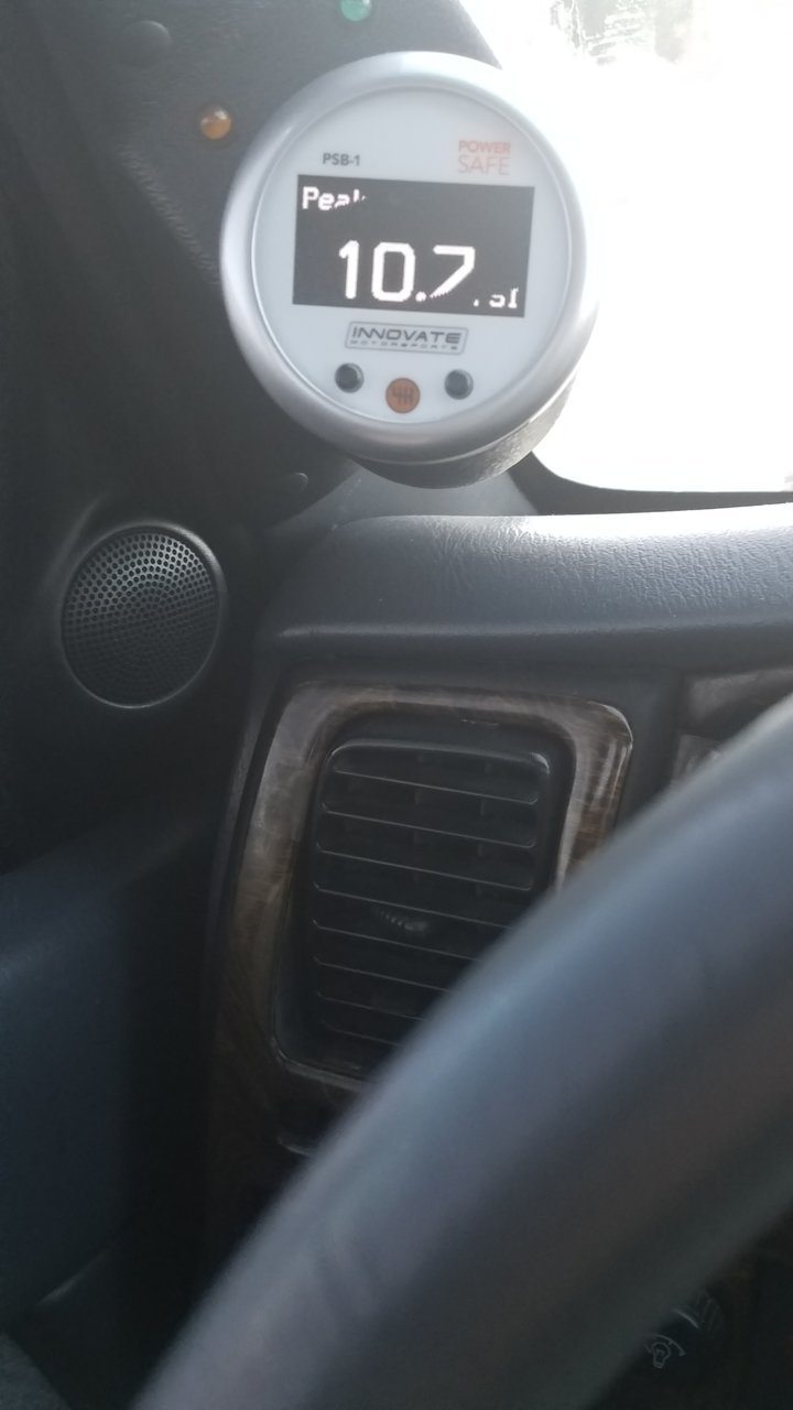

    Had a fun day pushing my supercharger to 10.7 pounds today.
    After replacing the fuel pump and getting a new OEM MAF sensor.

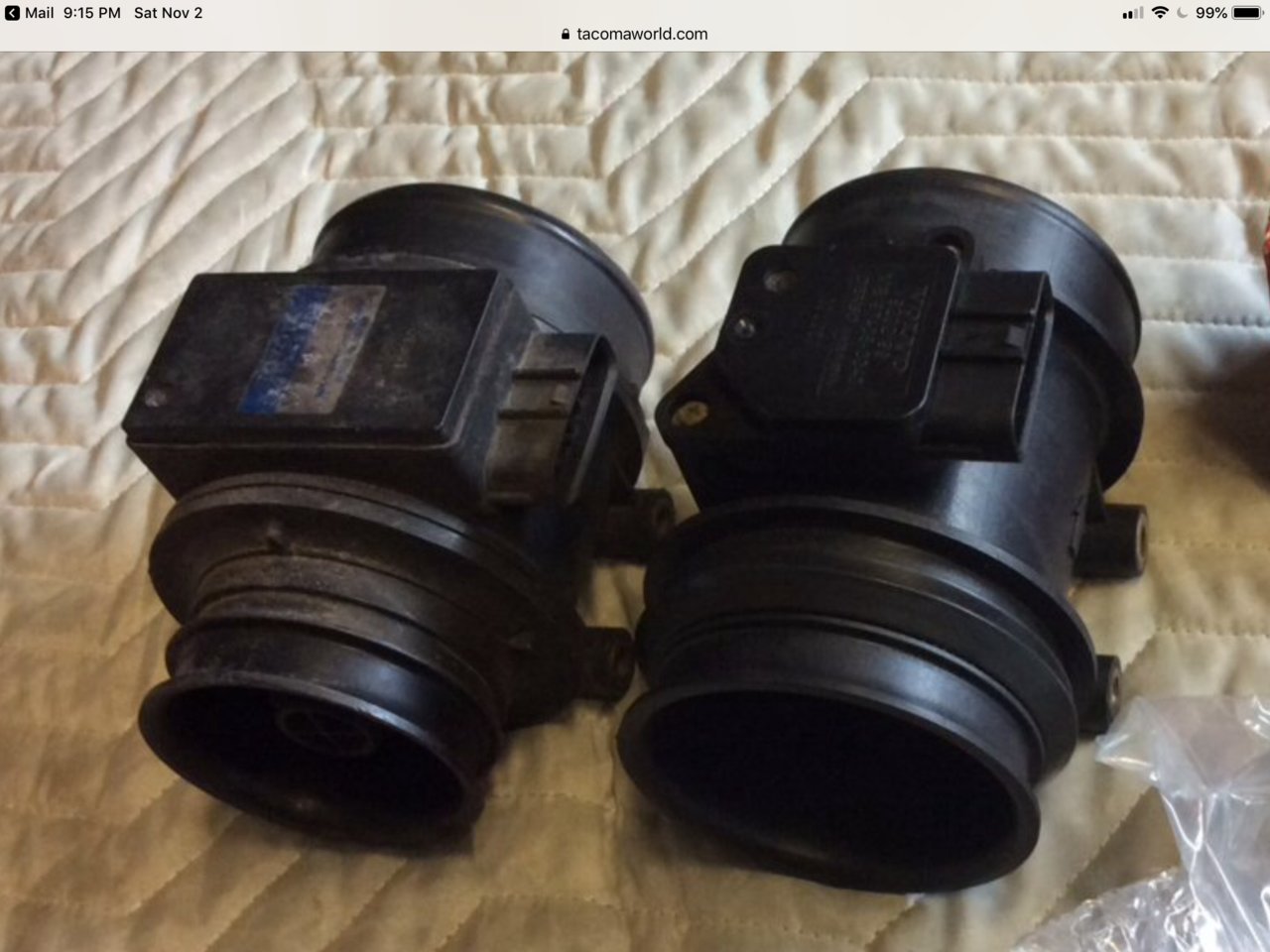

    So uh, why the OEM sensor?

    Because I bought 3 others, two off eBay one from Napa, DESNO part and none of them proved out
    to keep my trims correct with good power until I got the OEM sensor.
    Frinck truck runs better now than it ever has with the OEM sensor.

    Well I figured as much on that, I meant vs the Volvo one?

    What happened to the Volvo swap one?

    I’m still using the Volvo housing setup with the 2001-2004 MAF.
    Volvo housing lets you use the 2001-2004 MAF sensor

    ah I thought you had swapped the entire maf to a volvo one. Gotcha. So OEM 01-04 sensor. Cool.

    I did swap the entire unit. They are very similar.
    Difference is the Volvo on the right you can remove the MAF sensor with two screws like the 2001 Tacoma and the OEM on the left the MAF is part of the whole housing for my year. So you have to buy the whole unit if it goes bad and Toyota wants 800 or so for that part.
