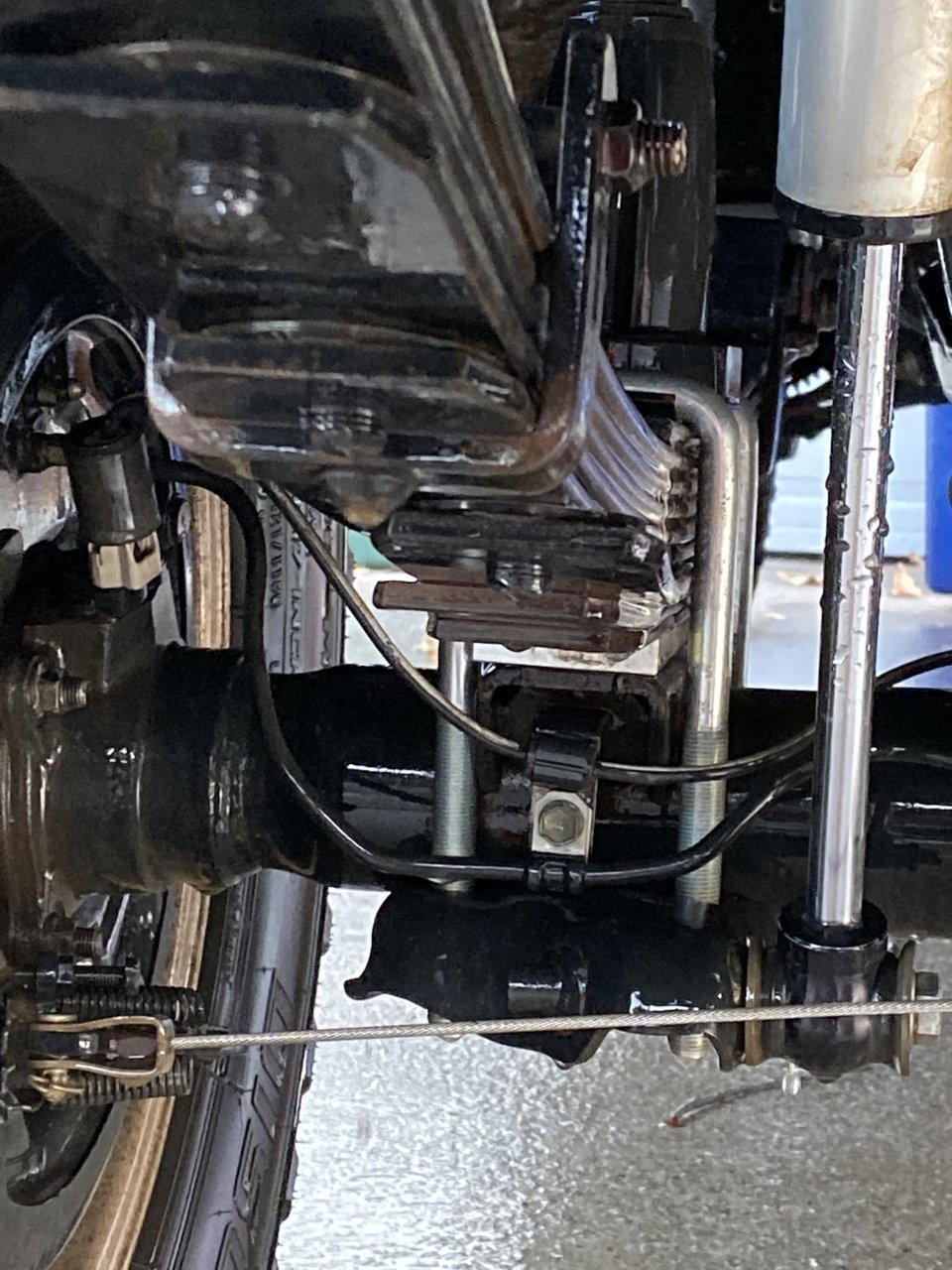

    Did notice this today, that’s lower leaf is out of line with the rest of the pack

    not really.
    Axle wrap generally happens from torque of the axle. If the brakes weren't working they wouldn't be applying torque to the axle like if they were. Generally axle wrap happens during acceleration. Are you experiencing it when you stop or when you go?
    It's fine. Mine twist all the time.

    Axle wrap occurs from braking. Weak springs allow the axle to torque during braking. The jerk felt is when the stored energy in the bound up (torqued springs is released. This is especially true in autos where the brake is held when stopped then released when the light changes. I am not saying it can't occur during acceleration but it is far more likely and common for it to happen during braking.
    Having said all that, I find it very unlikely that the classic axle wrap symptoms are occurring with newish alcan springs. Especially custom ones designed for extra weight.
