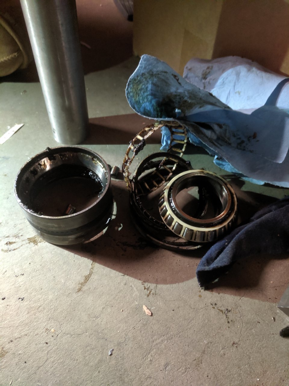

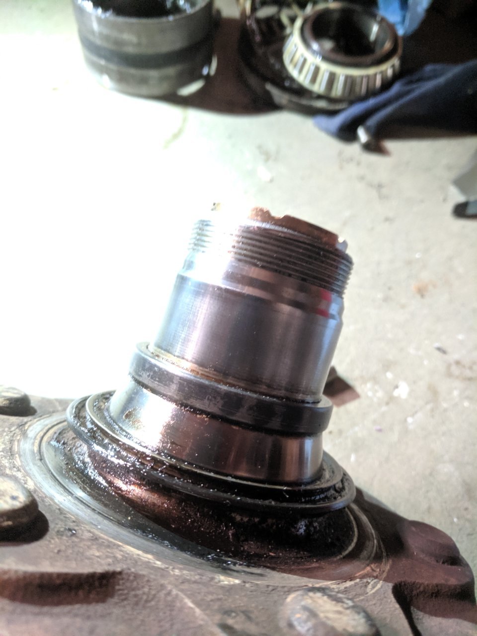

    Yea it was crazy. Started bending my 3/4" press plates. Had to weld on some gussets.
    Now this piece is stuck on the hub

    Oh thats normal.. just cut the thing at an angle and get it close to through and whack it with a chisel.

    I ended up using a bearing splitter.
    But that's 1 side done, hopefully the next side is more straight forward

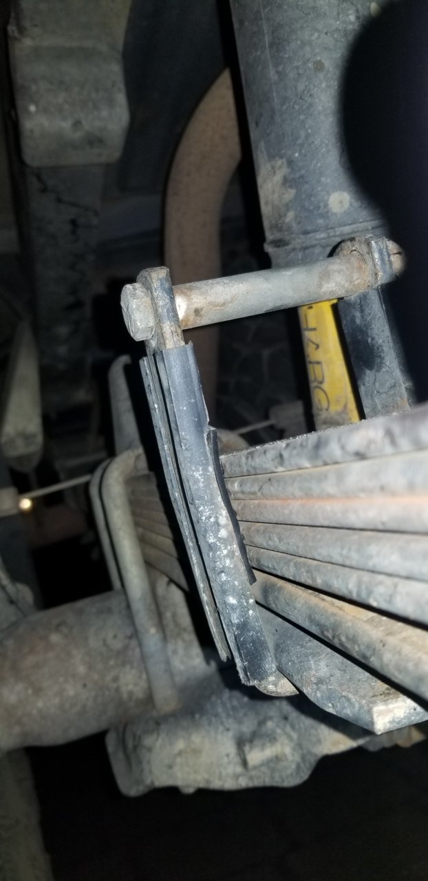

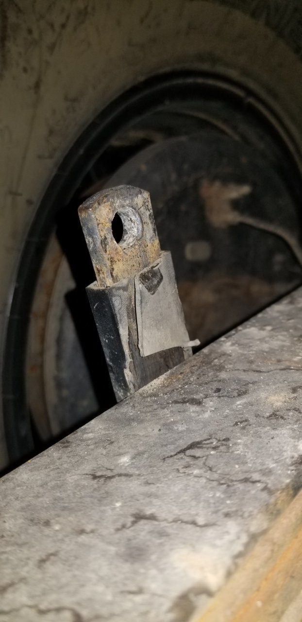

    anyone know what this plastic part is called? The plastic sleeve thing that goes between the "keeper bracket" (or whatever it's called) and the leafs on my dakars.
    Had a squeak when I was braking and accelerating and tracked it down to this.
    For now I just cut a piece of rubber and put it between them.
    Anyone run into this before?

    Nope...
    Careful of the width AND where the seatbelt connects to the seat or slider...

    Yes that was my super annoying squeak. Except I lost the bolt and the pack twisted. So I now have a very subtle squeak and it’s not as noticeable so I’ll have to fix that

    Might reach out to ARB/OME to see if that's something I can get as a replacement.

    Let me know, I'll more than likely need some as well
