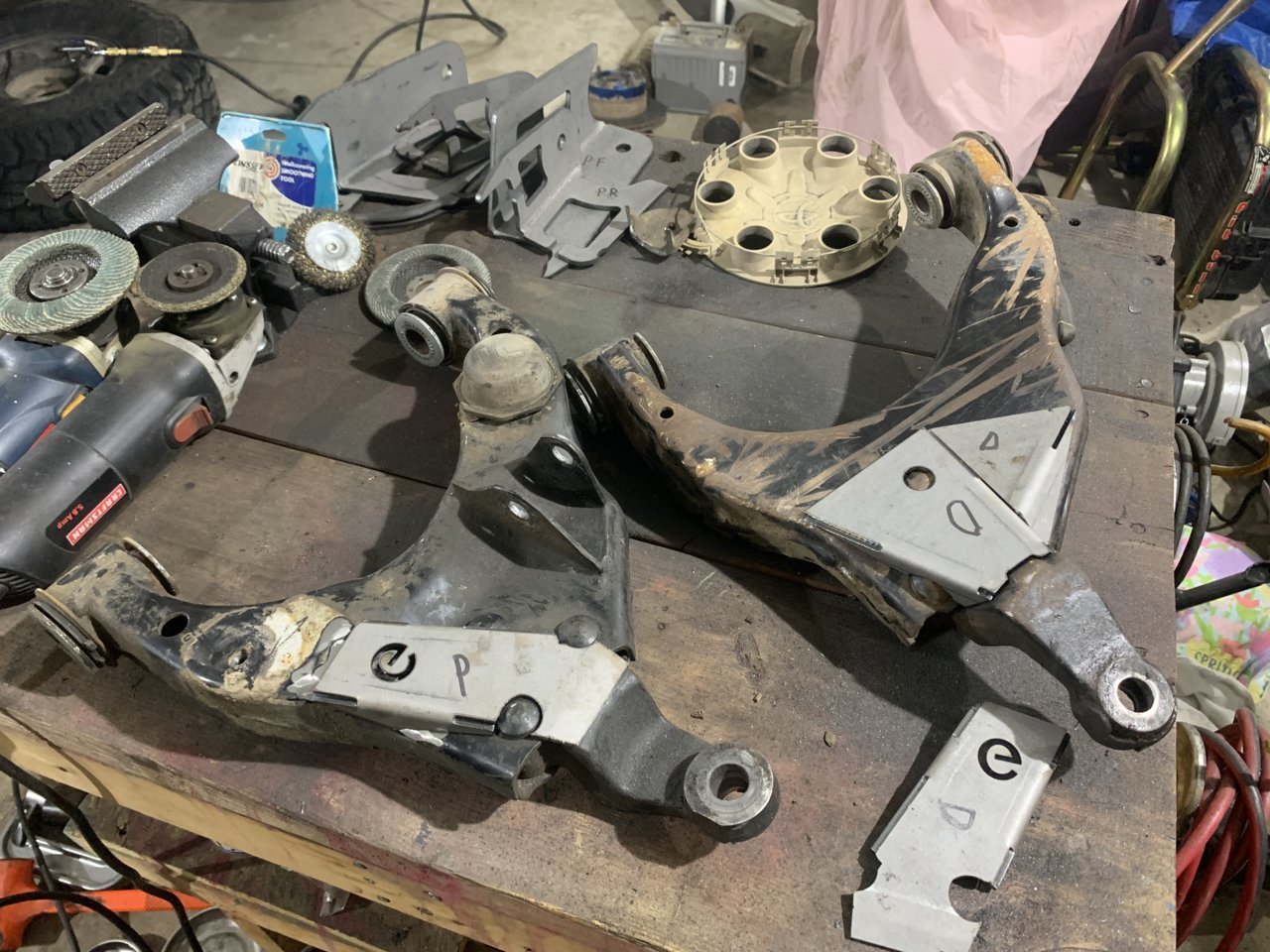

    Drop bracket lift and booger welds
    Finally started prepping these suckers.

    Custom gussets for the lower arms or does someone make those?
    @eimkeith makes them

    Curious if those are actually needed. Was pretty sure our LCAs were already pretty damn stout

    I've bent mine before :anonymous:
    but then again I did something stupid.
    Hard abuse usually leads to cracking around the rivets and shock mount. Limit straps should hopefully prevent the shock mount cracks though. I’m trying to get ahead of it all.
    Plus a flatter sliding surface on the lca ftw.

    Yeah, mine are cracking all over the place.
    Looking to have a more permanent solution to that problem though. :spy:
