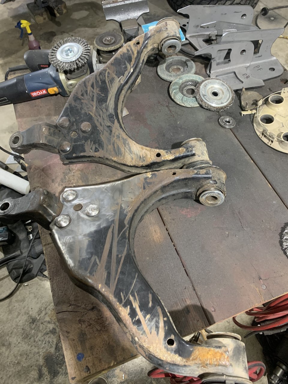

    It brings the surface gradually flush with the pins. So instead of sliding on the lca’s and they sticking on the pins, it can gradually slide up and then down. Typically if you are just barely sliding on an lca you can push through, but not if you hit a pin. The increased height is marginal compared to that of an lca skid.
    And if you look at my lca’s you know I’ve used them pretty hard. They are only three years old.
