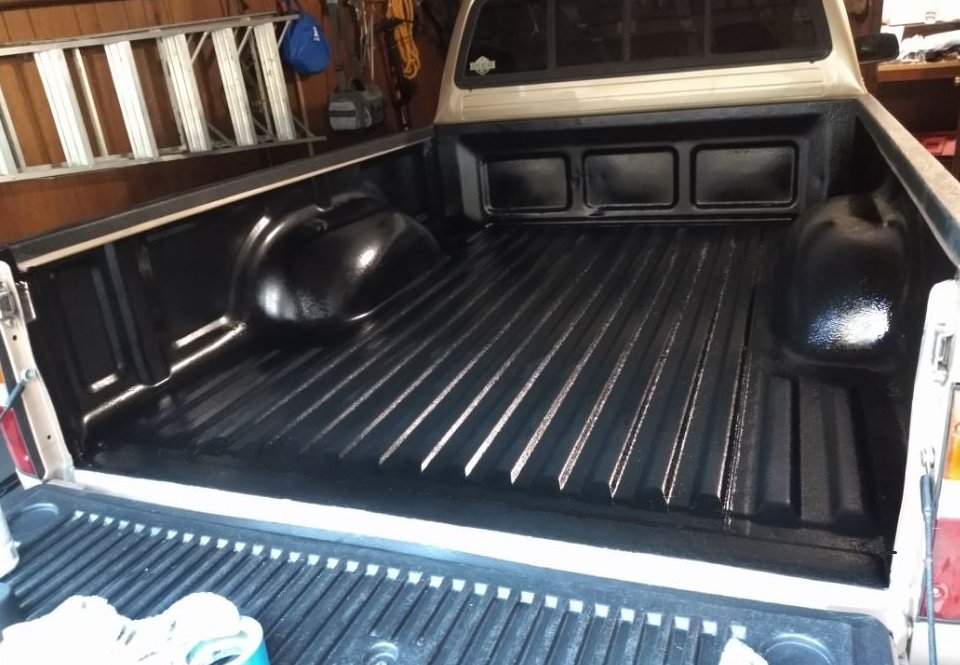

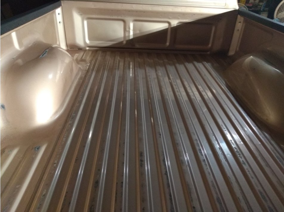

    Sanded, primed, painted, and then coated the bed with Rustoleum Truck Bed Liner. I used a big thick texture paint roller to apply the material to the bed.
    Before
    After

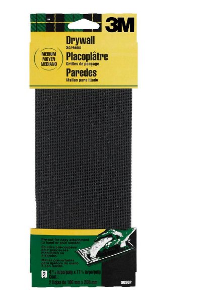

    Drywall Sanding Screen - Flexible to use for for the rail ridges.

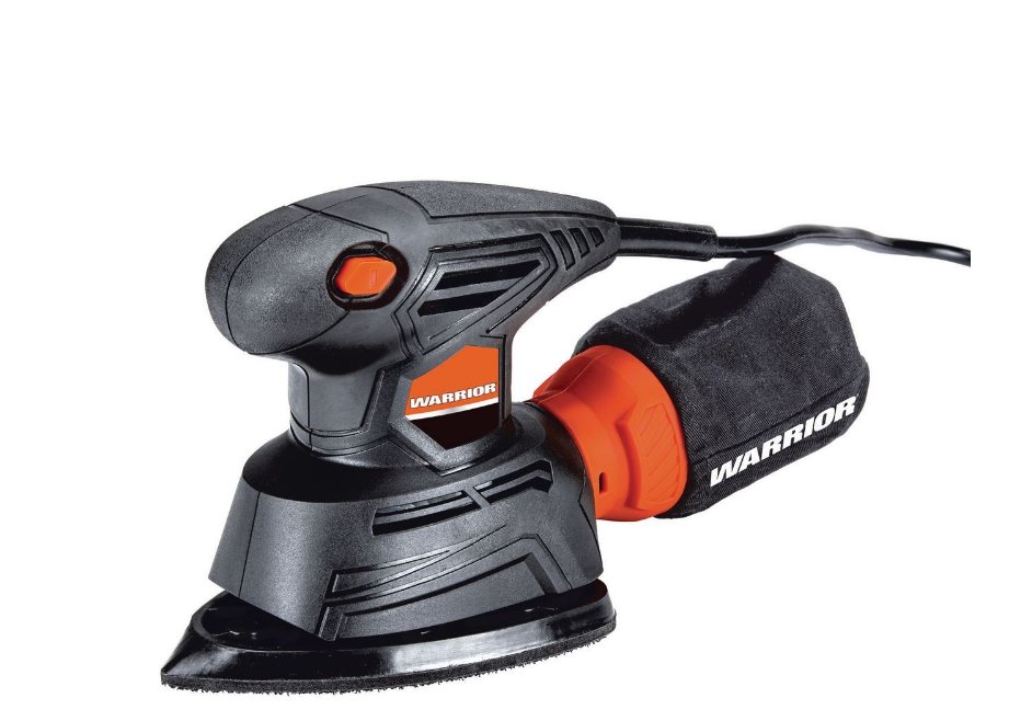

    Harbor Freight (Pointed) Palm Sander

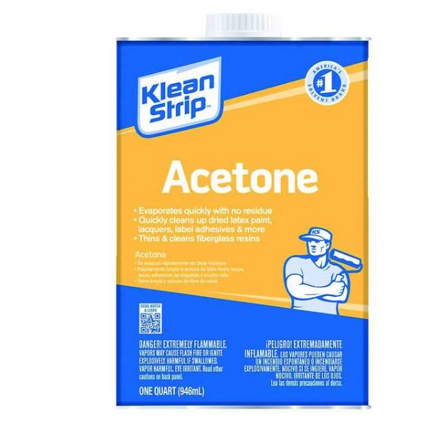

    Acetone to clean the surface before priming.

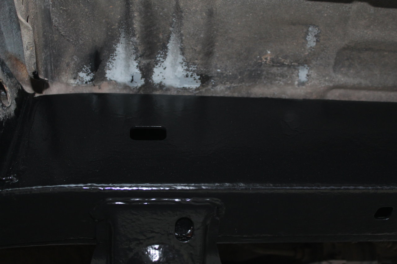

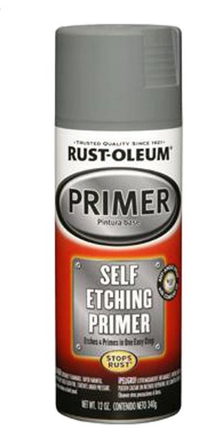

    Self Etching Primer for bare metal areas and the bed floor after sanding. I used this on my frame restoration project.

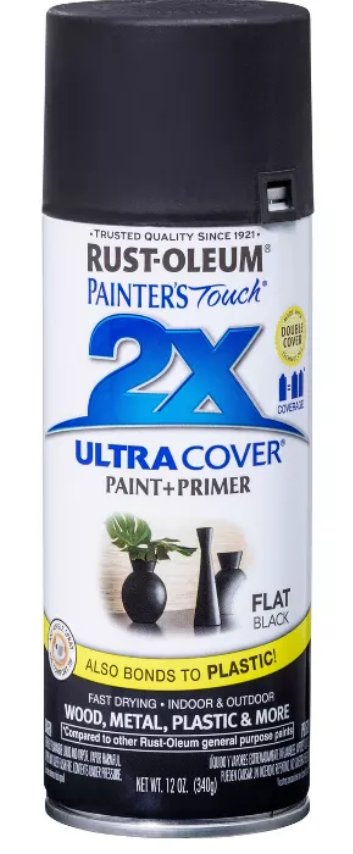

    I sprayed the bed sides with this paint to get into areas where I knew the the bed liner paint would not go. This paint is very thin and likes to run. The temperature was in the 50s so it might have been too cool for painting. I used the foam brushes to fix the runs. I'm not crazy about it, but it did the job.

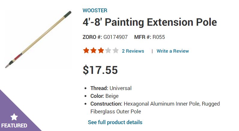

    Roller extension

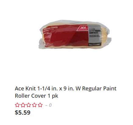

    All paint roller 1-1/4 Inch - Rough Surfaces --

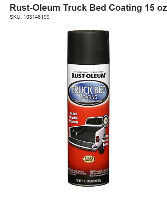

    Used spray on the areas where the roller cannot reach.

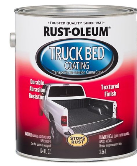

    Note this is the ORIGINAL FORMULA that is NOT like the plastic coating used in the Professional version.
    A number of reviews about peeling plastic kept me from using the PRO formula.
    Only used 1/2 Gallon - Purchased for $65 from Tractor Supply

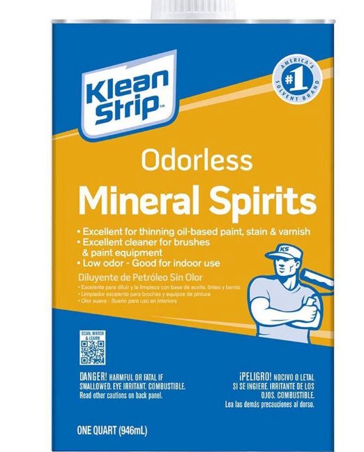

    Mineral Spirits to Clean Up Afterward

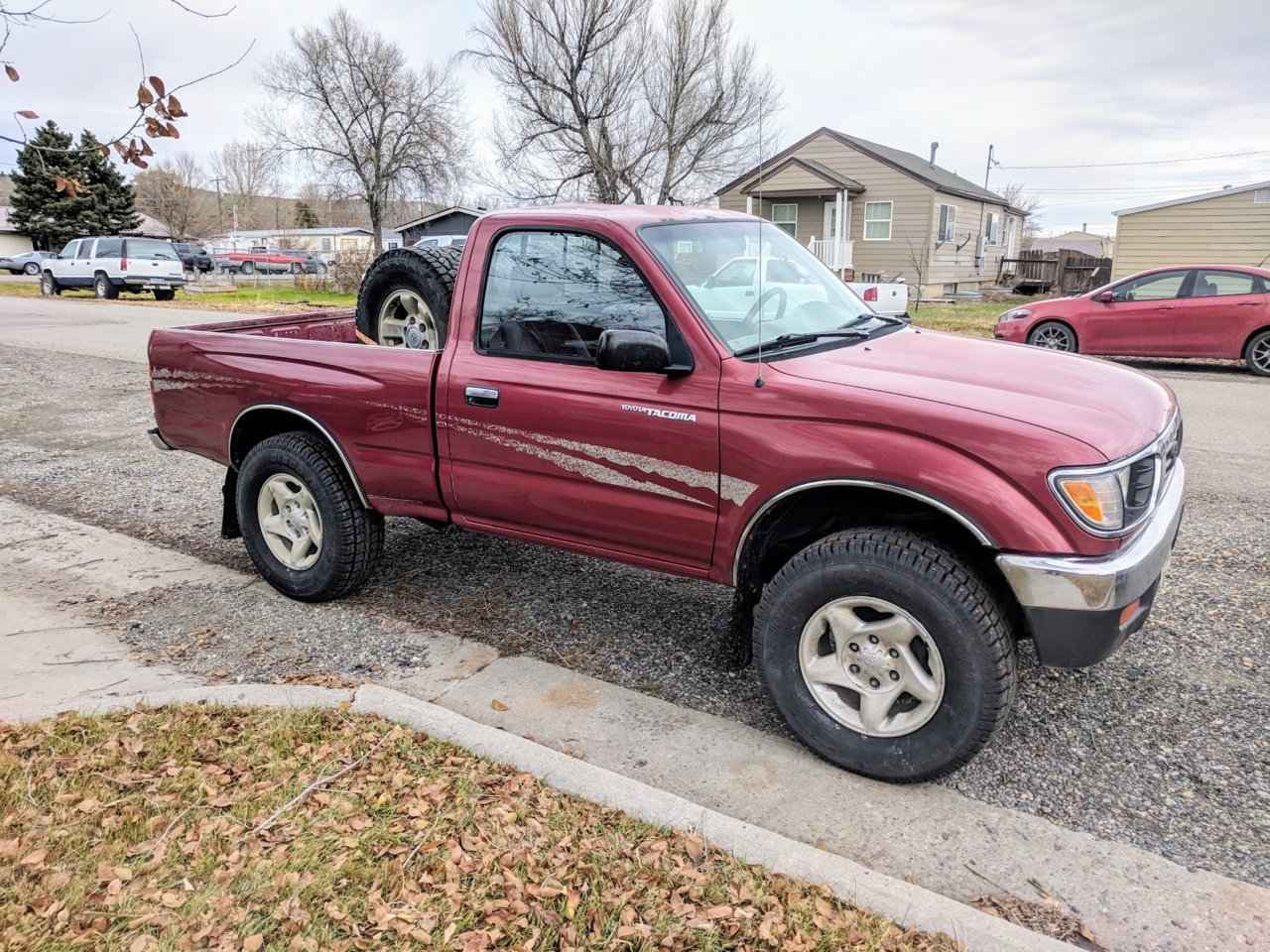

    Used it to haul Igor's stock wheels to the store and put some new Cooper m+s winter tires on them with studs. Then swapped them on the daily. Bring it on winter. Already have had some sketchy winter drives.

    Your bed coating looks great. Have you tried Corroseal yet?
