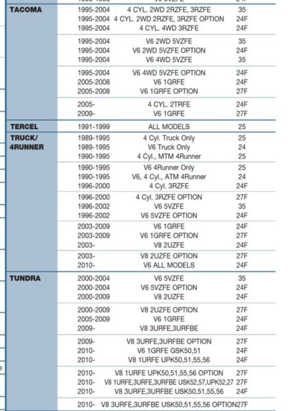

    24F is the smaller of the two. 24F and 27F are the same height and width but the 27F is 2" longer. I have a 24F Megatron II and it takes up the entire tray.

    I have the Northstar 27F in my truck.
    It fits no problem, but it is not perfect.
    I removed the plastic tray at the bottom.
    The battery is not as wide (front to back) as a 24F só the clamp doesn’t hold it secure at the 90 degree pieces. I put some small pieces of cut up mountain bike tube (rubber) there to take up some space.
    the battery has shifted a little bit after some off roaring, but not too much.

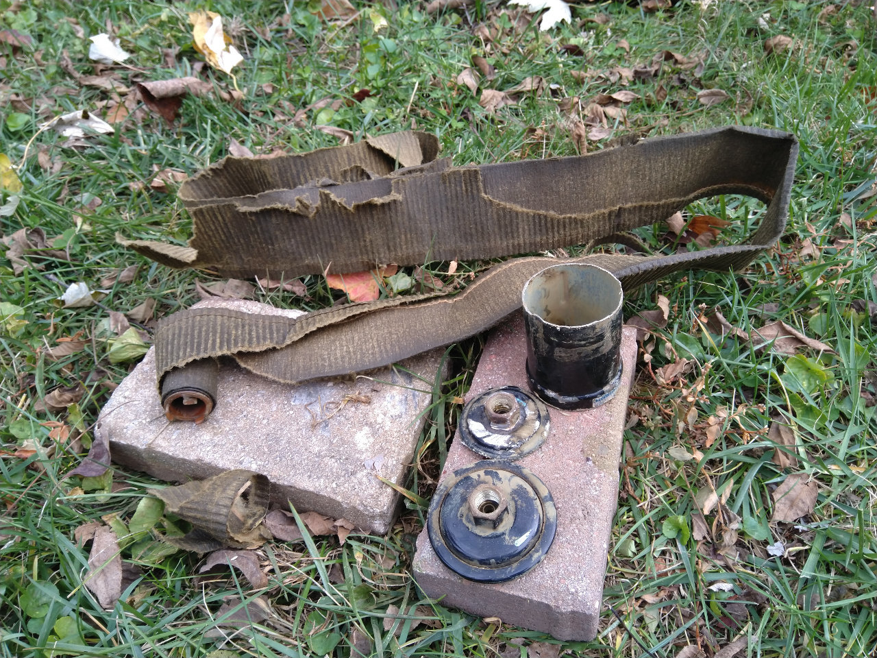

    Went wheeling this past weekend, the puddle looked about as deep as the others we had been going through, turned out it wasn't ha. Going to dig into it more today now that I'm home as well as rip out my interior and clean it up

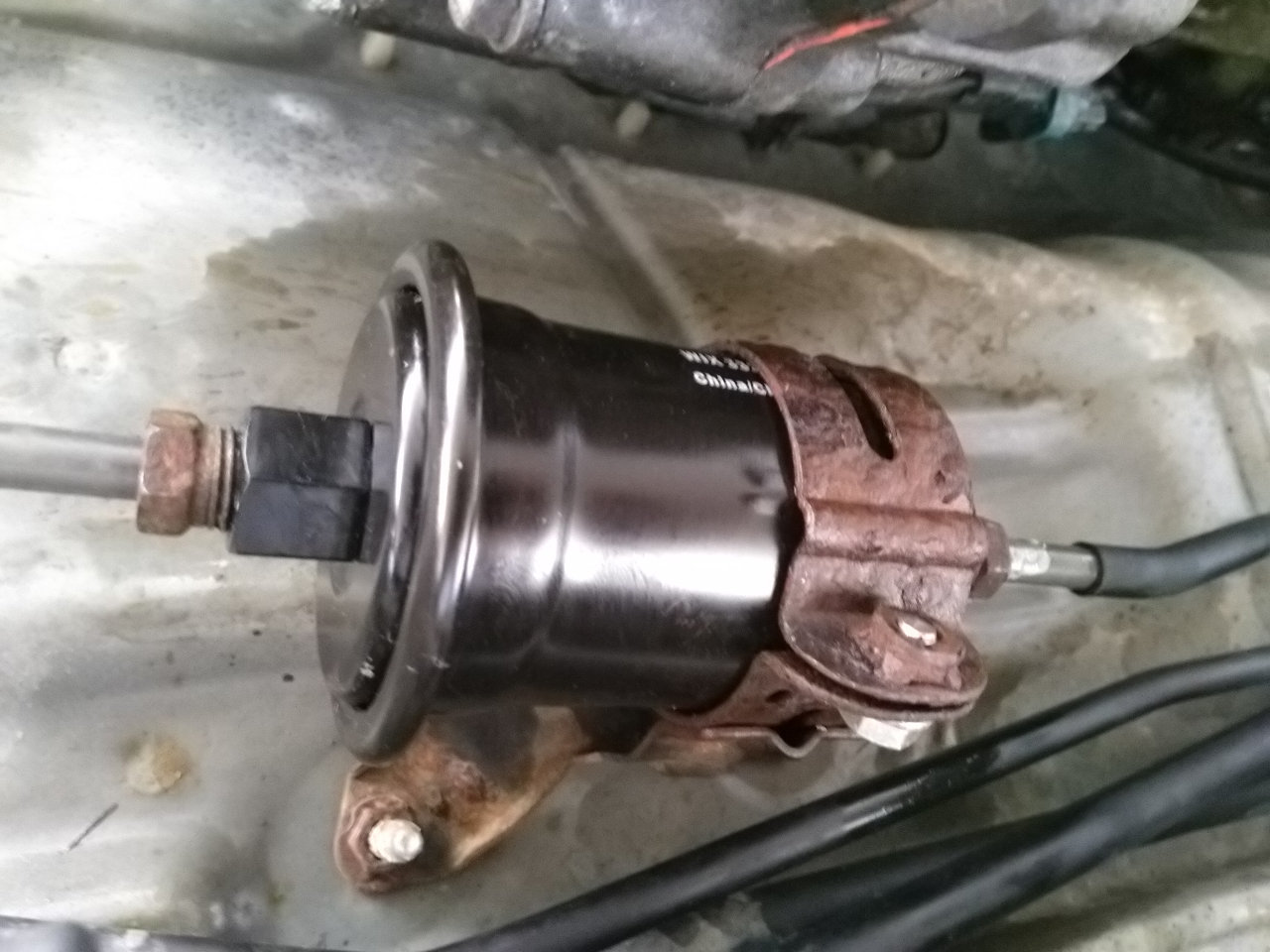

    Installed a new Wix fuel filter. Was inspired to cut the old one apart because of this Chrisfix fuel filter video: https://youtu.be/92TfTQTmuq4?t=329
    Would have spent the extra $25 for the OEM Denso part if I knew it came with a shiny new bracket. Replaced the 10mm bolt with a new stainless one at least.
