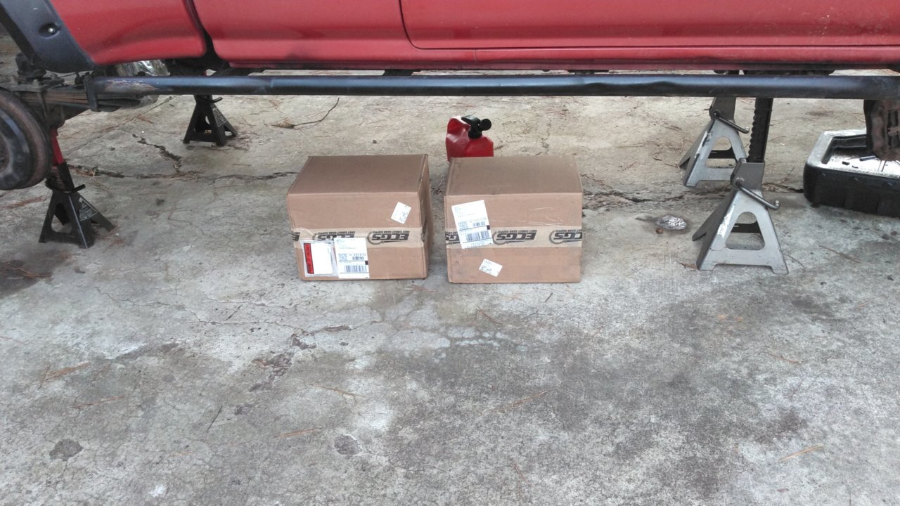

    I've heard a lot of great things about ECGS but to have sent out and received my rebuilt diffs back in 7 days is truly impressive.
    5.29's and double locked is just around the corner :transformer:
