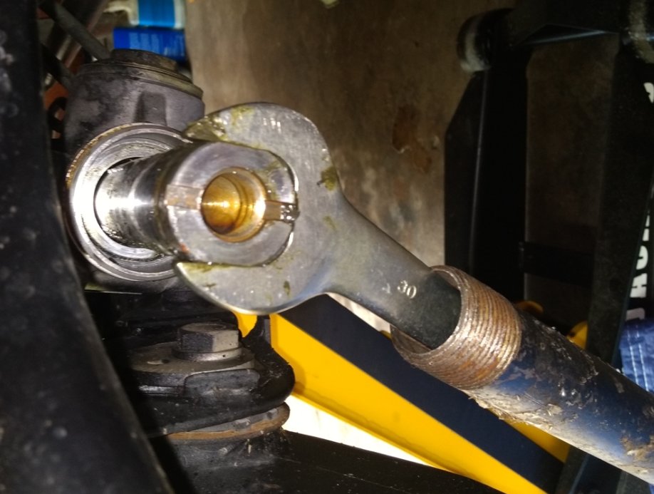

    Ok how hard are inner tie rods and lower control arms? Are we talking physical strength or finesse?

    Inner tie rods aren't that bad. Just have to separate the outer tie rods from the lower ball joint then unscrew them out of the inners, then take the inners out of the steering rack. To loosen the inners you need a big pipe wrench or adjustable crescent wrench which can be kind of a pain to get them loose with, but otherwise it's all fairly straightforward. Count the turns it takes to get the outers off so you know how many to put the new ones on...so your alignment is somewhat normal when you're done. Will still need to get an alignment after though, especially if you're doing LCAs too.
    I haven't done my lower control arms but from what I gather the hardest part is replacing the bushings, but if you're putting new LCAs in with new bushings in them then you don't have to worry about that.
    If you don't have a lift to work under then it's a lot of being on your back under the truck which might be an issue with that shattered elbow of yours

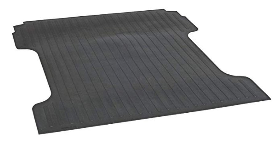

    The Dee Zee DZ86501 Heavyweight Bed Mat arrived today. It actually fits. It needs to set in the sun to straighten out from being rolled up in sub-freezing weather. This thing is heavy. I like it.

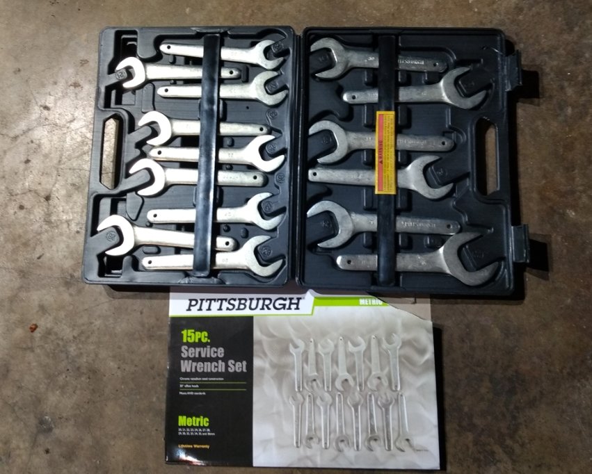

    For inner tie rods this little Service Wrench Set from HF came in handy for the places where you need a slim open end wrench.

    Pretty sure I have the same one. Just be warned it stains really easily.

    What kind of stains? Oil?

    I left a piece of steel back there that was a little damp overnight once. Now theres a big orange rust stain on it. Also the previous owner spilled some chemical and that left a good sized puddle. Just be leery and wipe up stuff that gets on it asap.

    Thanks for the warning. I'll probably mop it with some 303 Protectant as soon as the weather warms up.

    I take mine out and blast it with the pressure washer maybe once a year. Does a good job, didnt think of using 303 on it. Maybe next time.
