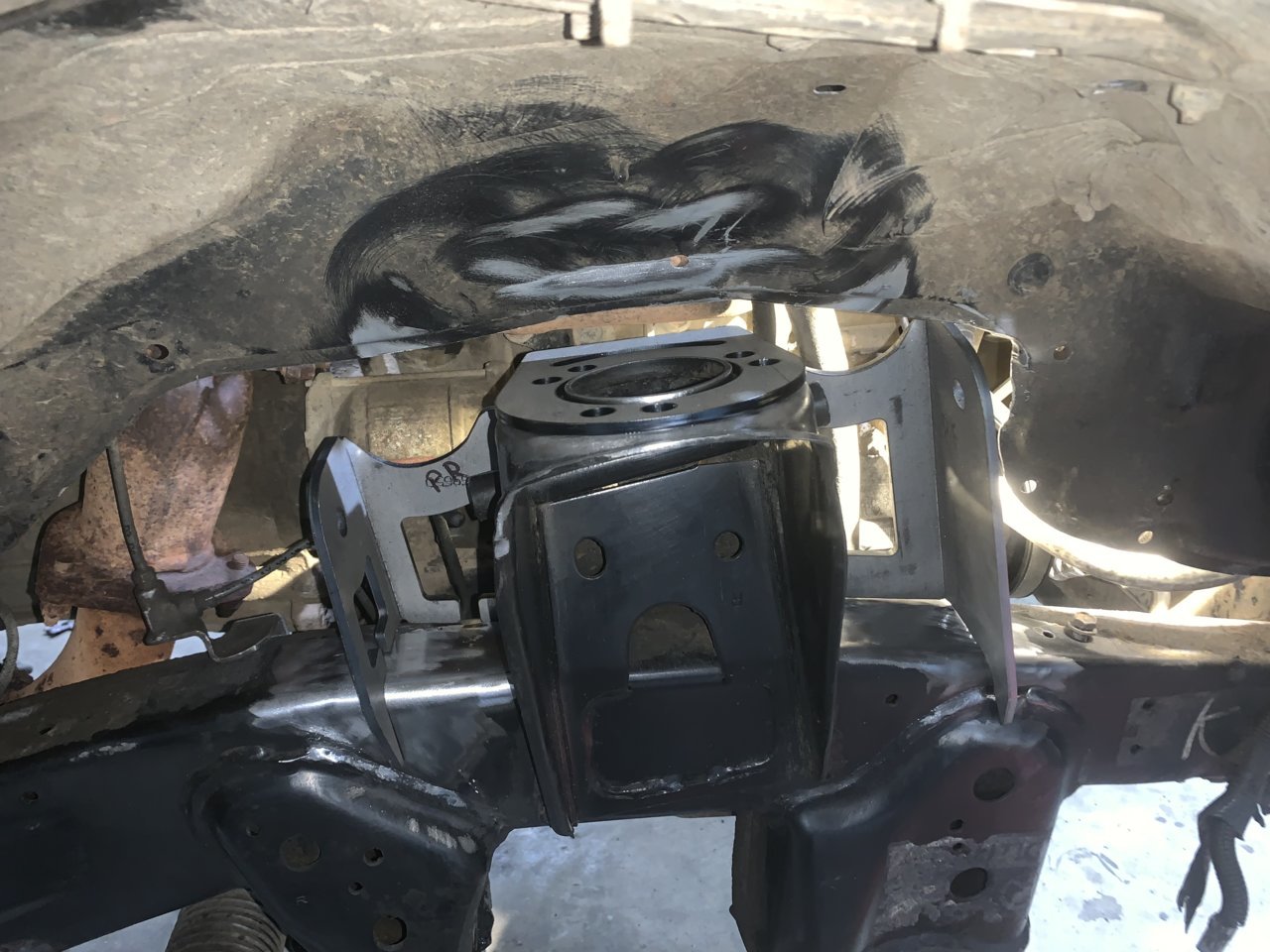

    Drop bracket lift and booger welds
    Stop tempting me while I have the lca’s out...
    Got the second tower prepped today.
    Now need to test fit a bajillion times to prep for welding.

    WHAT ARE THESE? Is someone making and selling them?

    do it man. They aren't that much money. Will articulate better too.
    And nice top plates, where you get those?

    FOUND THEM. @eimkeith is making them. https://eimkeith.com/buystuff/stk/

    :thumbsup: his lca gussets are beef too.
    While I think they will definitely help especially combined with limit straps, I feel the most bullet proof solution is like @Squeaky Penguin mentioned and that’s a cross brace or some sort of downward force on the bucket itself.

    for sure a cross bucket brace is the way to go. Could easily start with these plates though.

    At a certain point, with all the welding and grinding and painting and ... Wouldn't it be better to just cut off the OEM tower and replace it with a stouter one that is more reinforced against the frame?

    Agreed. This is something we discussed for Mike's truck, his coil bucket cracked basically right where the welds for that top hat would be.
