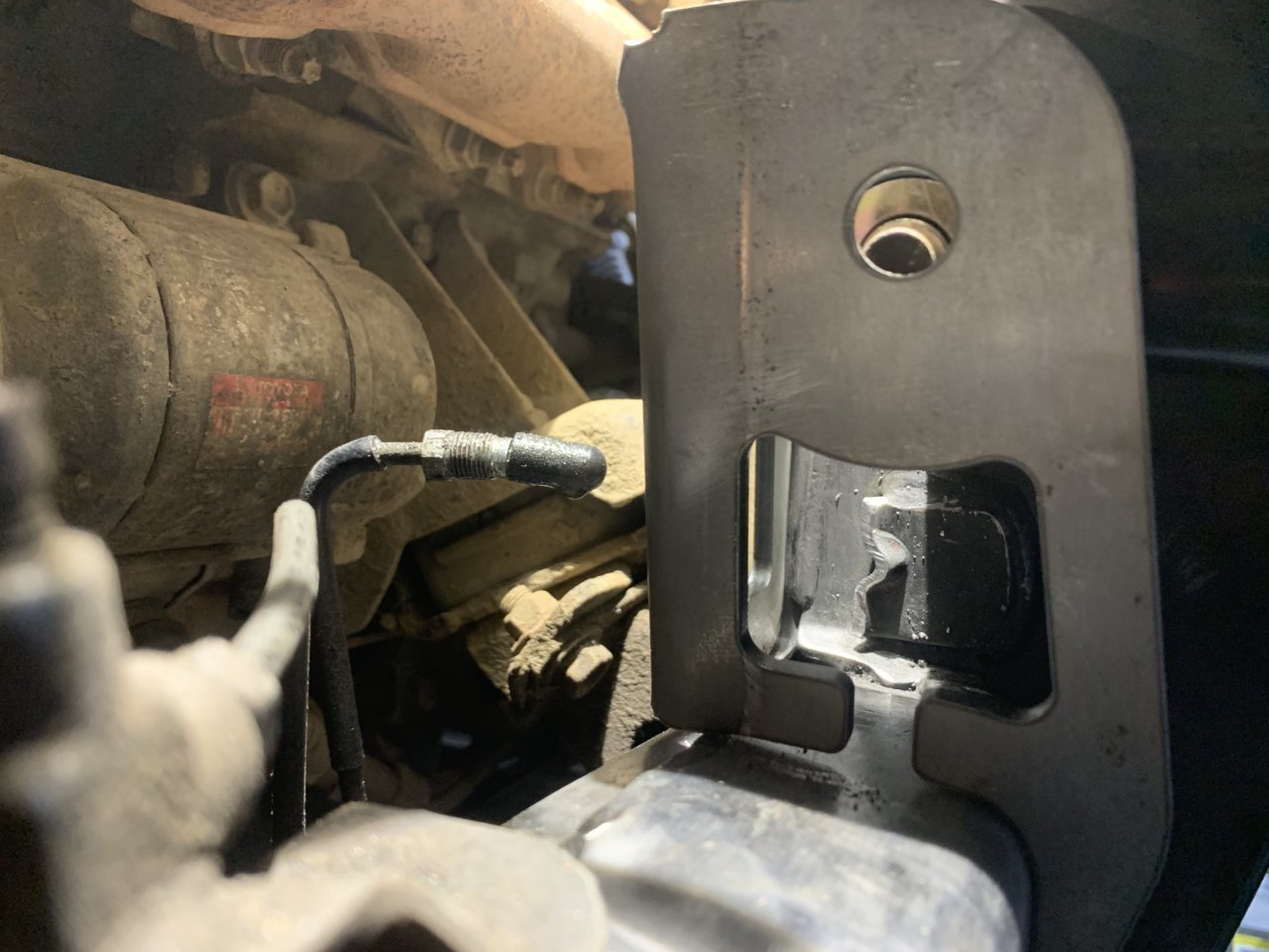

    Drop bracket lift and booger welds
    Not solid mounted like tacking, like plates that are drilled and positioned a certain way. So you can still adjust, similar to the way you adjust SPC's.
    https://www.*********************.com/index.php?threads/alignment-cam-eliminator-kit.181/ <-- replace with the site TW hates
    Basically depending on which way you flip the plate, is which way it pushes the cams. Or are you saying even a setup like this, things will basically be "crossed up"?

    Yeah, I don't have an issues with my cams moving after adding the cam tab gussets.
    The problem is the rear cams are all the way out, and the front cams are all the way in, causing the LCA and bushing to sit crooked in the mounts. If I had an adjustable upper, I could put the LCA in a more neutral position, and then make some plates that fit in where the cams used to go.

    We’ll see! Digging into it in a couple minutes. I needed to grind a bit on the other one to get it to fit nicely.
    Roger, makes sense. :thumbsup:

    Right side is actually money, left side needs heavy grinder love.

    well, there's a lot of trimming/fitting to do - you should always tack these in with the bolt & UCA in place, IMO. They don't fit right out of the box (at least mine didn't)

    Is it necessary to remove the engine to get to all the points that need welded?

    Ideally, yes, imo. I know a bunch of folk who have welded what they could reach and have been fine, though. I'm planning on welding the back-side of mine when I have the opportunity; fwiw.

    I welded mine without.
    When I did eventually pull the engine, I decided they were plenty well welded. I added a few little beads on the back, but they probably weren't needed.
