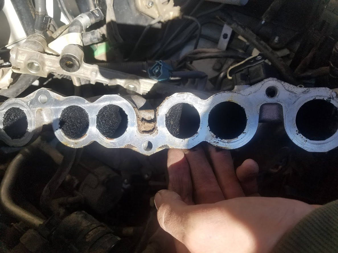

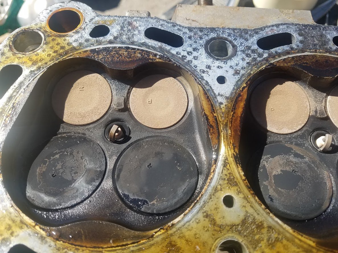

    Installed a reman head from cylinderhead.com on my buddy's 98 3RZ. I helped him buy the truck back in the summer of 2000 and he was my best man, so helping a friend like that out and doing it right was important to me.
    It all started this spring. He said the CEL was on and the truck was down on power and idling rough. He brought it over to me and I scanned the CEL. P0300 and a few other codes I didn't write down. I knew the P0300 could be a few different things but that it likely wasn't good. I did a compression check. Cylinders 3 and 4 were in spec 185ish but 1 and 2 were way low.
    Did a leak down. Cyl. 1 and 2 were leaking badly out of the exhaust valves
    Turns out he had the usual crack in his exhaust manifold and in 169k miles had never checked the valves. Everything pointed to burnt exhaust valves and seats. In doing research here and Yota Tech, all the above symptoms pointed to the head casting likely being cracked too. There are zero decent machine shops within a few hundred miles of our town and after talking (or not talking; one didn't return my calls) with the machine shops around here for a valve job and possible cast aluminum welding, I quickly came to the decision to order a remanufactured head. Because of the low cost, ease of returning the core and solid reputation, we ordered a head from cylinderhead.com
    No turning back now!
    With the head old off, I was expecting to see super-burnt valves and crack(s) in the casting but this one looked really good. I likely could have done a DIY valve lap but the new head had already shipped.
    What do you pros think? The pic doesn't show that exhaust valves on 1 and 2 are not seating the same way they are in 3 and 4
    While I was waiting for the new head to be delivered, I did some other maintenance. The intake plenum was FILTHY!
    I cleaned and re-o-ringed the injectors, installed new belts, new fuel filter and cleaned the throttle body and IAC valve too.
