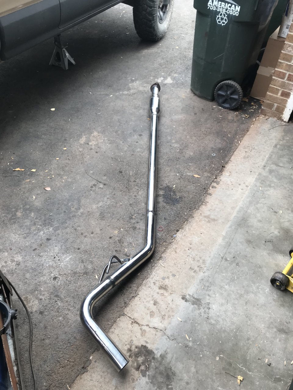

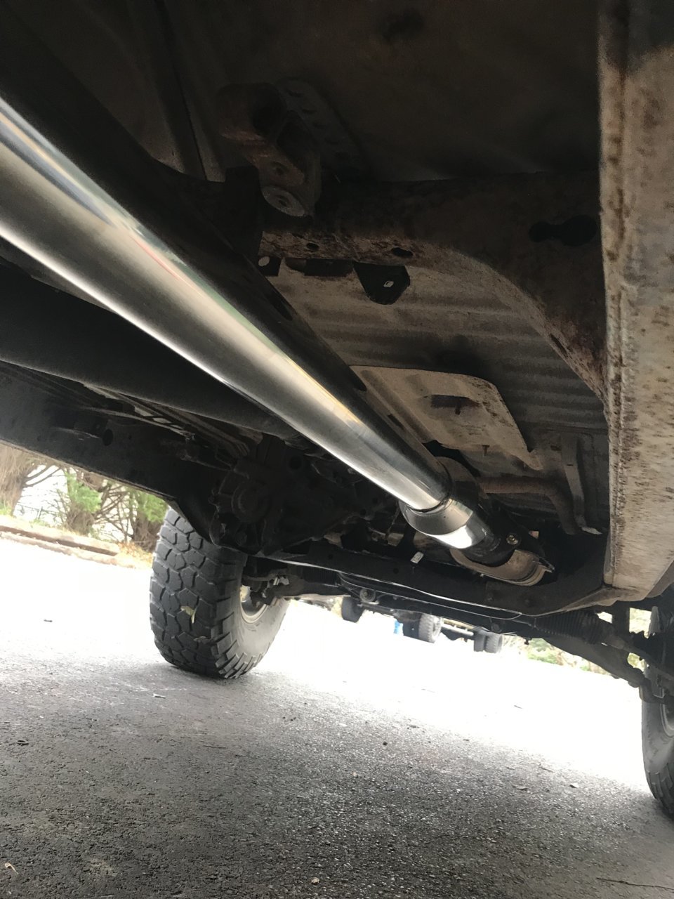

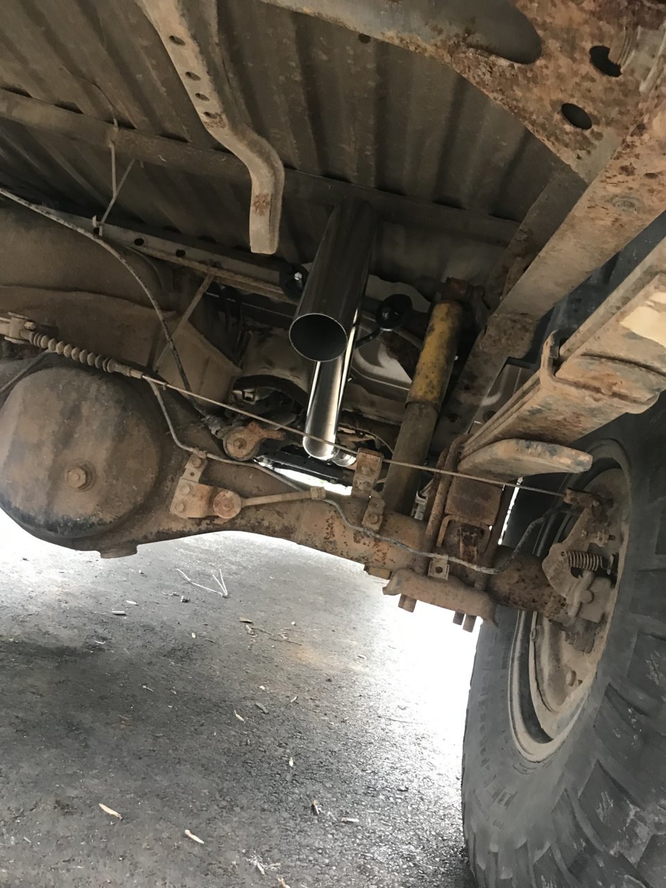

    Made an exhaust for mine today after my old one rusted off. About $70 on eBay piping and rubber hangers

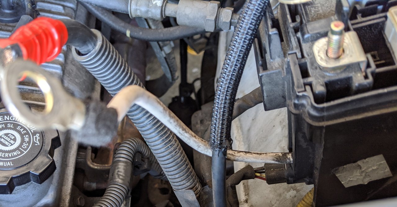

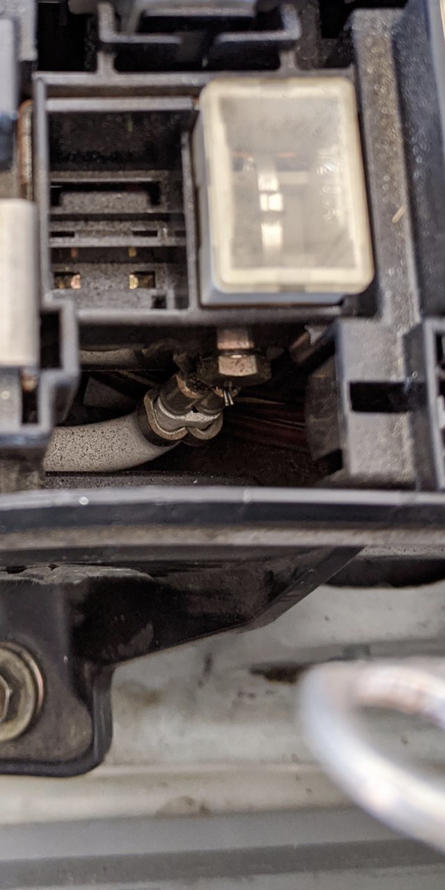

    Anyone have info on removing this lead? It's coming off the positive cable (into the side of the fuse box) to power the fuse box.
    Can't access from the bottom of the box...

    Neighbors are gonna love you

    Split the fuse box off the bottom and the plastic guard that blocks access to the bolt will come off with the bottom.
    Be a window in the side of the box to get to that bolt.

    The box splits in half

    He's got a resonator and a cat, it'll be fine. 2.7 sounds better than the 3.4 anyway

    Muffler does what
