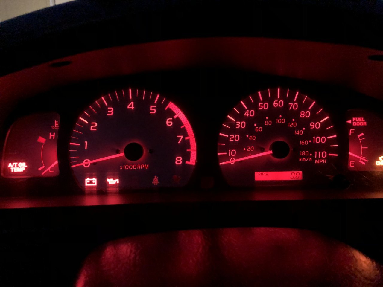

    It comes on at 300F, if it's coming on often that's bad news bears, something's not right. That's beyond the point where fluid breakdown occurs slowly, at 300F it's happening fast and will do damage if that continues.
    Digiratus likes this.

    Yeah, I don’t think I’ve seen mine above 200 since adding a cooler and shift kit.
    Speedytech7[QUOTED] likes this.

    Mines come on twice and shit still works fine, I think.
    I did stop and let everything cool down though. Hasn’t happened again since someone told me to use 4 low more :oops:

    Which is great, 200 is solid.

    The AT warning comes on way to late at 300F.
    At approximately 235°F, vital transmission fluid additives start to boil. This results in varnish build up inside the transmission.
    At approximately 255 to 260°F, the internal seals begin to harden, which causes both internal and external fluid leaks. Internal leaks equates to pressure loss, which causes slipping and a variety of shift problems.
    When the fluid temperature reaches 295°F, the fluid continues top breakdown at a rapid pace. At this point the fluid no longer provides adequate lubrication and the clutch plates burn up and slip badly.
    At the next 20° temperature increase, (approximately 315°F), the seals and clutches are completely fried and the transmission is doomed. Catastrophic transmission failure is eminent and will occur very soon if it has not already failed
    https://streetsmarttransmission.com/transmission-fluid-application-guide/
    Silver02Taco and Fernando like this.

    This is one of the reasons I don't actively seek out automatic transmission vehicles. Never know what the last idiot did. And also the reason I'm glad that even while grossly overloaded towing in Phoenix heat the huge cooler on my Land Cruiser kept the trans below 208°

    My light went on and shortly after the trans started having issues. Lasted about a year until it finally went. After I had it rebuilt, bad idea, lasted about another 2 years. Manual swap.

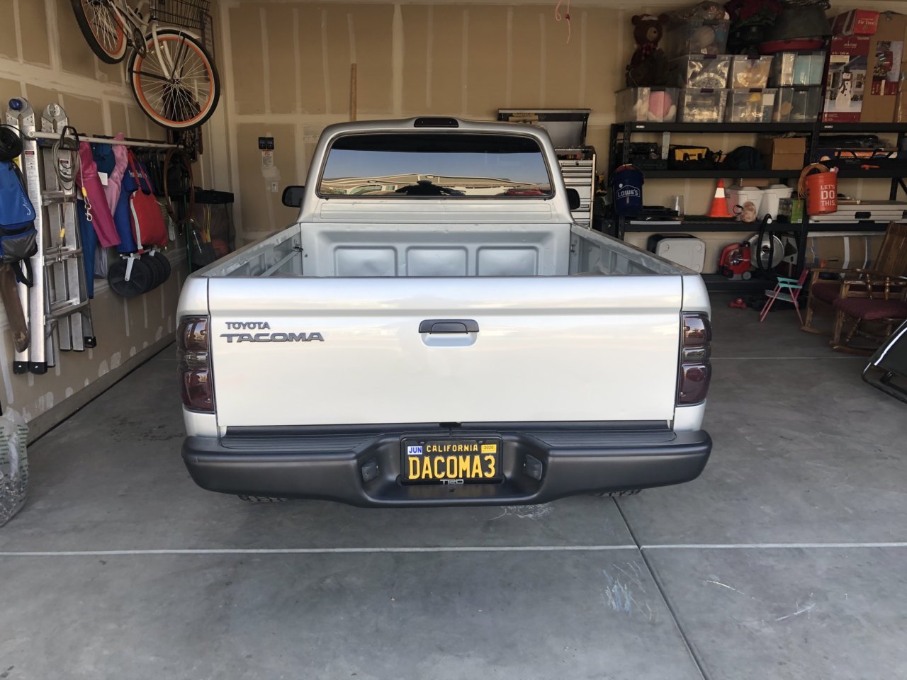

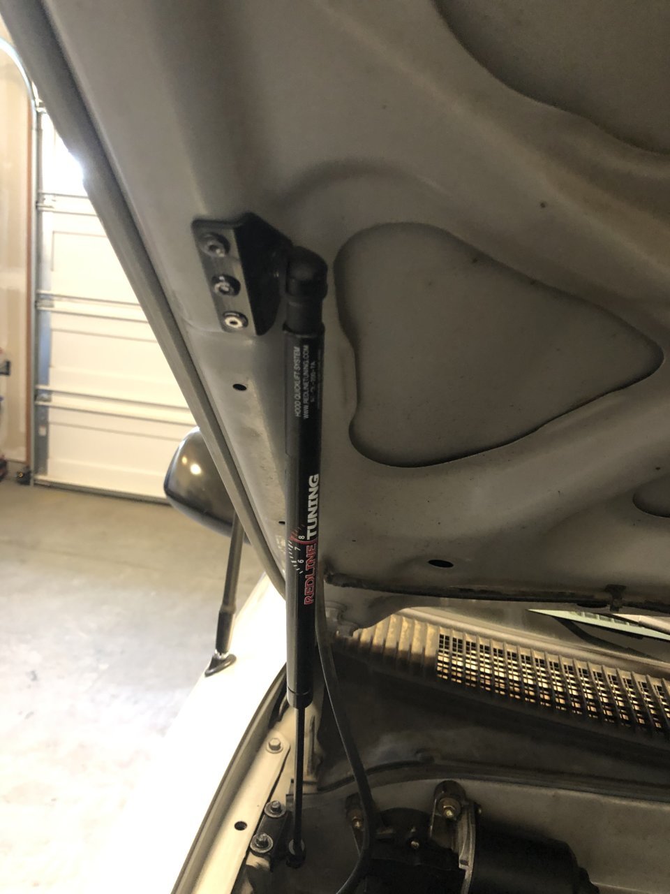

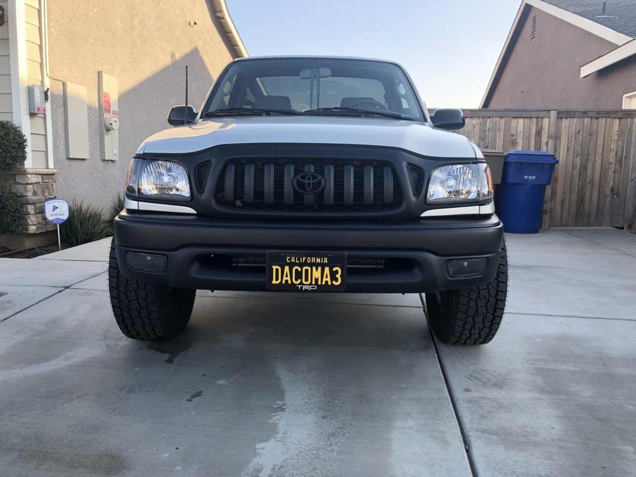

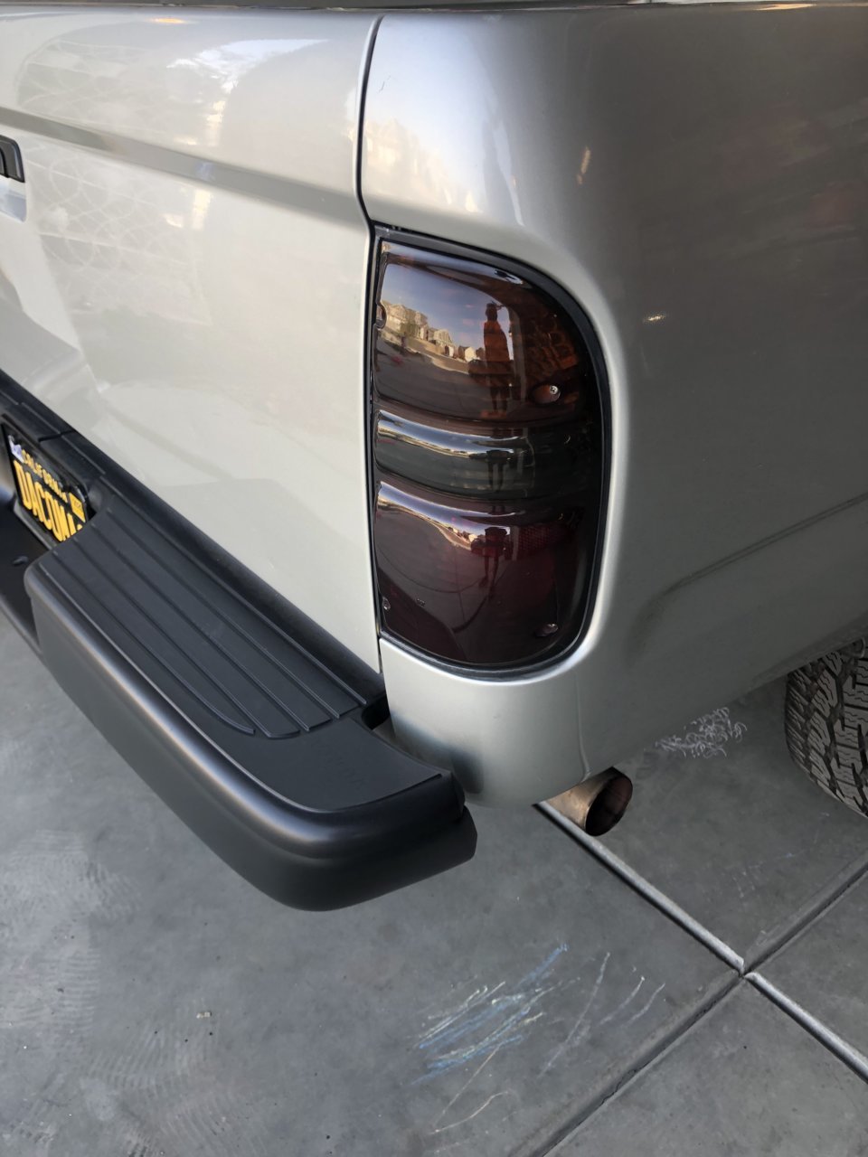

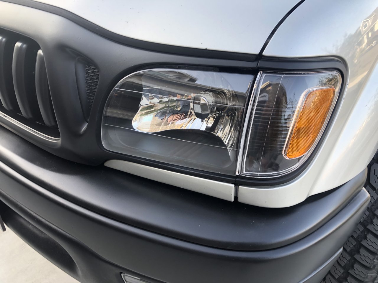

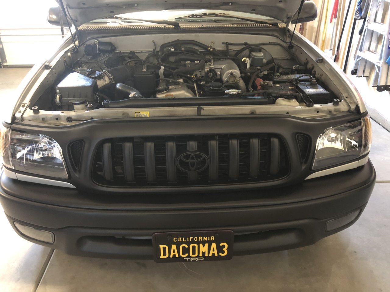

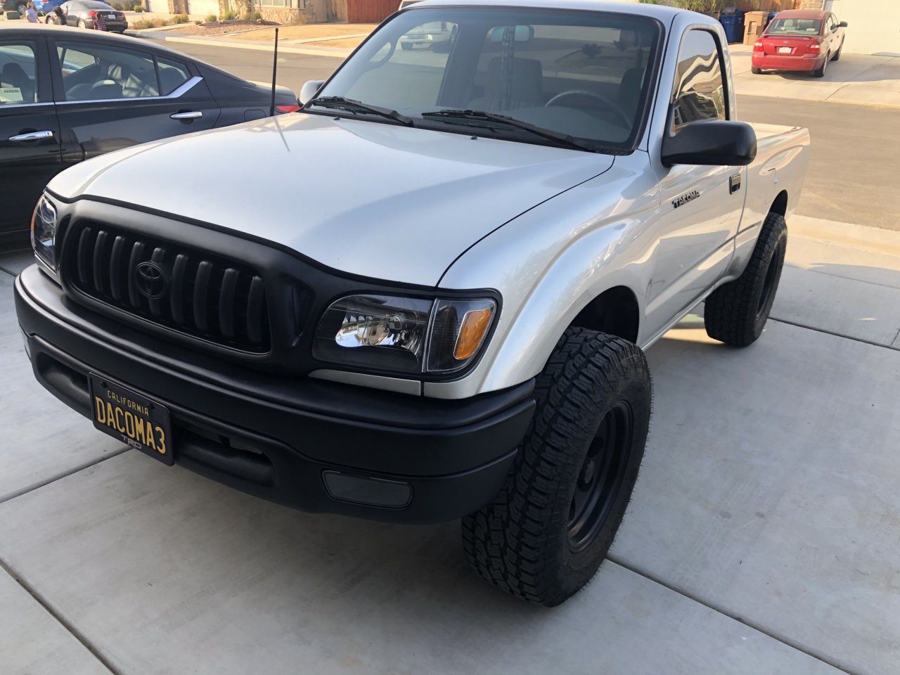

    Installed the Redline Tuning struts on my 5 lugger. I know I know there is absolutely no need for them but hey who cares, it’s my truck right? Also added some after market headlights and since I had to take the grill off I trim blacked the grill and front bumper. And since I did the front bumper I decided i might as well do the rear also.E69AD082-67AC-4A44-8186-72876635C81F.jpg908E9244-E98C-41EA-A002-FB7390CC11E6.jpg 92B7CF73-1285-4AFD-968E-0CB3ABDEE2F3.jpg2A86DB1D-D603-4465-915D-1A4B1CBD475D.jpg E907EB7D-5FDE-4335-864B-8521DBEA83E3.jpg6E8BF661-2D44-4F5B-A1C3-CFAD898FE8D3.jpg 9C8242EA-EE50-49E3-B6D3-40C40A34D0EF.jpg Im also waiting on my lights from superbrightleds so that I can do the LED cluster and A/C dash mod.

    Oh Hood struts are absolutely necessary! If you do any work on your truck it makes it so much easier!
    One of the best add-ons I've done.
    DACOMA3[QUOTED] likes this.
