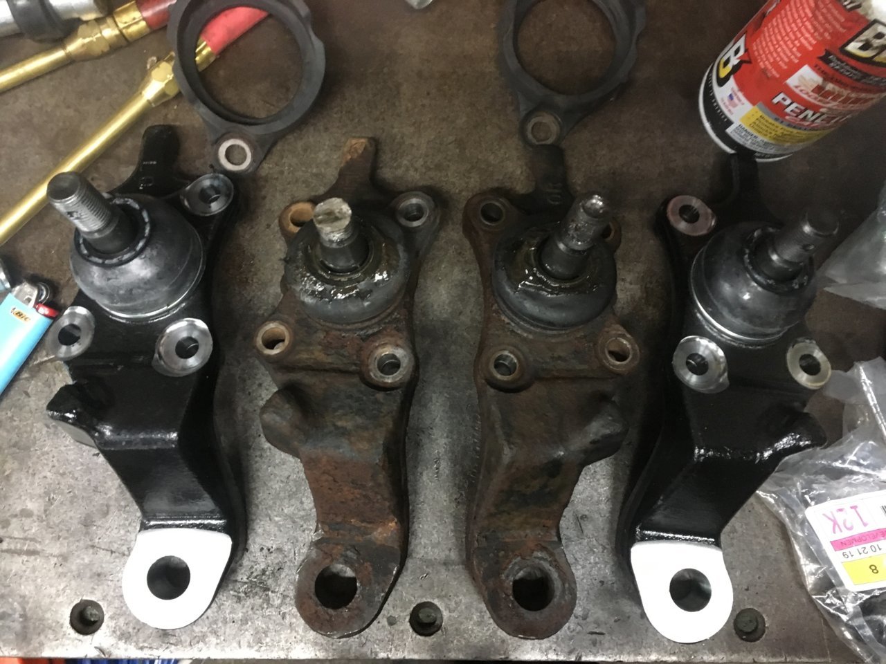

    I am stupid. I have read all of the warnings and still did not respond so .......today I am replacing a failed LBJ. also doing the uppers and anything else in there as I inspect. Both sides. AND every 100k miles hereafter.

    Woof. That sucks, I hope to never have a failure.

    good luck. i just did this job yesterday, thankfully before a failure. i had to beat the crap out of one of the stems, a result of using the wrong puller. once i got a pitman on there square, it popped off. lots of pressure needed. have a long breaker handy.

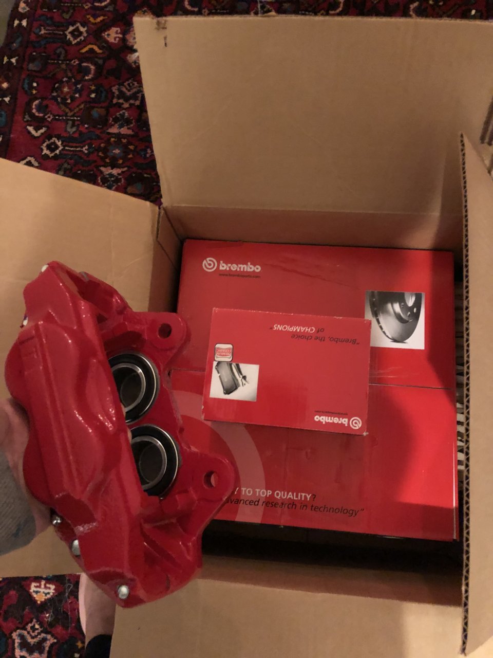

    What are changing to?

    400 but get the wheelers lines. I had to fab hardlines from tundras

    @turbodb sells a hardline set. I plan on going wheelers tundra lines and his hard lines eventually, but I don't want my banjo bolt lines to go to waste.

    Ah got it. I’m only running 32’s with no armor but I think I’m going to redo my brakes. Idk if I want to go oem or this kit:https://shop.advanceautoparts.com/p...N9sYhC14qLRopq4eGCQYqSYG6sz0bUWRoCg_oQAvD_BwE
    The tundra brake swap is awesome but more of a headache if you don’t need the stopping power.

    I disagree. 100% disagree. The stock brakes are not very safe unless the truck is completely empty and has no gas in the tank.

    Huh? Aside from the people that post on here, the overwhelming majority of 1st gen owners are rocking the stock brakes. If they are unsafe as you say they are, there would be more accidents reported/recalls etc.
    I see zero reason for tundra brakes on a truck unless its heavily loaded down, on bigger tires etc.

    Even with my front/rear bumpers, larger tires (285/75/16) and the rack and tent on the truck, the stock brakes, when working properly, are adequate. They will get the job done and stop the truck. I have done a panic stop with the truck loaded before so know that they work fairly well. I do want to upgrade to the Tundra brakes but I can live with the stock brakes for now because they DO work.
