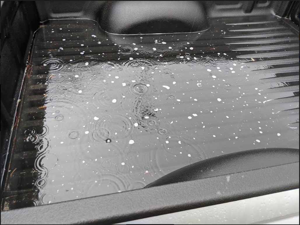

    lol yeah my cat wasn't too enthralled to go out on my porch this morning to piss, he wanted back inside REAL fast. Can't wait to get some rake out of my truck here soon bc it sucked driving with the bed filled with water this morning until it all dumped out :rofl::rofl::rofl:

    Are your drain holes plugged from the liner or crap blocking them?

    However dumb it sounds I didn't realize there were supposed to be drain holes lol. The PO did a spray in bedliner so I'm hoping they didn't coat the holes like boneheads. where are they located and I can check once I'm done with my shift. Was just out on lunch and snagged the pic

    Front corner on each side. Hard to get a pic since I have boxes in the way but the tip of the screwdriver is in the drain hole here.

    Thanks for the help and the picture for reference on location, I appreciate it! Will get back about this once I check, how would you recommend I get bedliner off if the PO really covered them?

    Looks like a spray in liner, guessing LineX. Just jam a flat blade screw driver thru there or maybe take a razor and try cutting a little bit of the liner out and then jam a flat blade screw driver in there. Either way, shouldn't be too difficult to open them back up. Just needs enough to be able to drain the water.

    Ya it's spray in, not line x, but some other company I can't think of. They have their emblem sticker on the bed but I can't remember it lol. Okay I'll jam it if that's the case, thanks again!

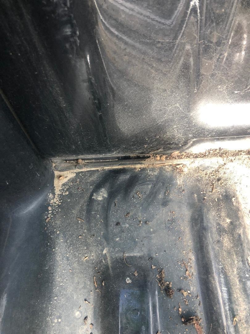

    i am fortunate this spot was not all rotty and crusty
    the LineX guy caulked it good before it was sprayed over so it will be covered up as it always had been under a plastic drop-in liner
    2 decades of dirt and stuff under right there
