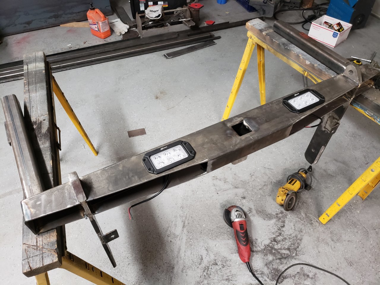

    I flush mounted LED back up lights directly in the bumper (lights are on a switch, not connected to the reverse lights so I can have them on any time)
    The License plate is just bolted to the bumper (for now). I drilled and tapped for the bolts. I will be mounting the license plate with a hinged bracket, but haven't gotten around to it. I want the plate on a hinge because the plate hangs down lower than my bumper and if I catch it on something the hinged bracket (should) allow it to flip out of the way.
    The license plate lights are just motorcycle LED lights that I mounted in the bumper. The LED back up light holes allowed me enough access inside the bumper to wire them and tighten the nut that holds them on.
