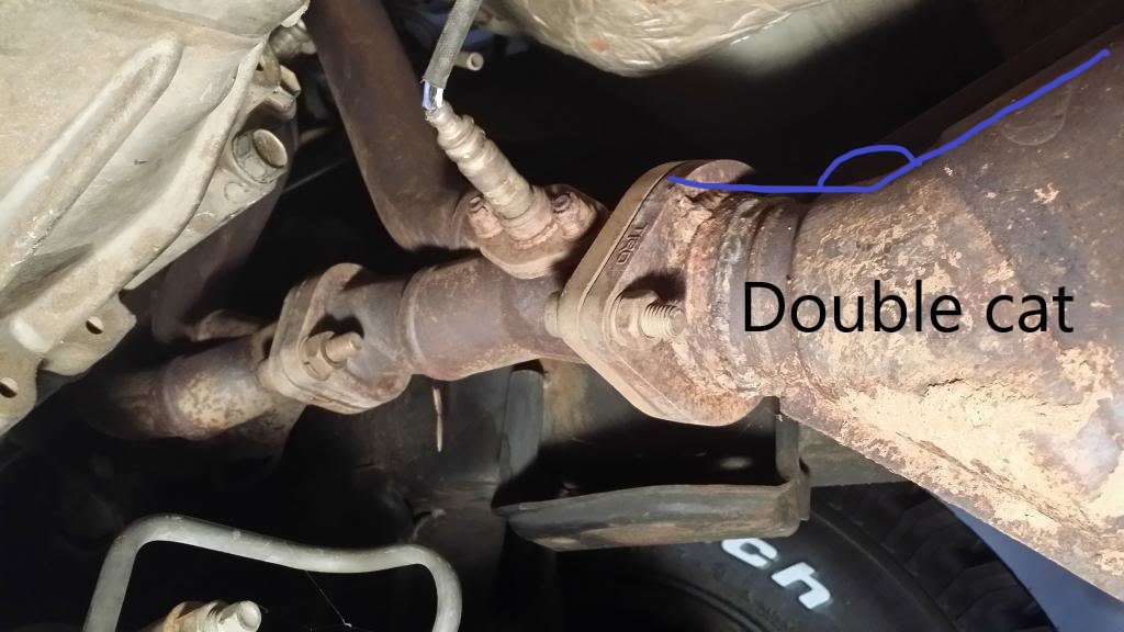

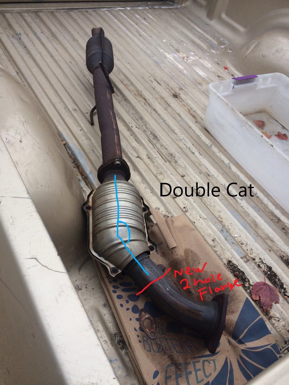

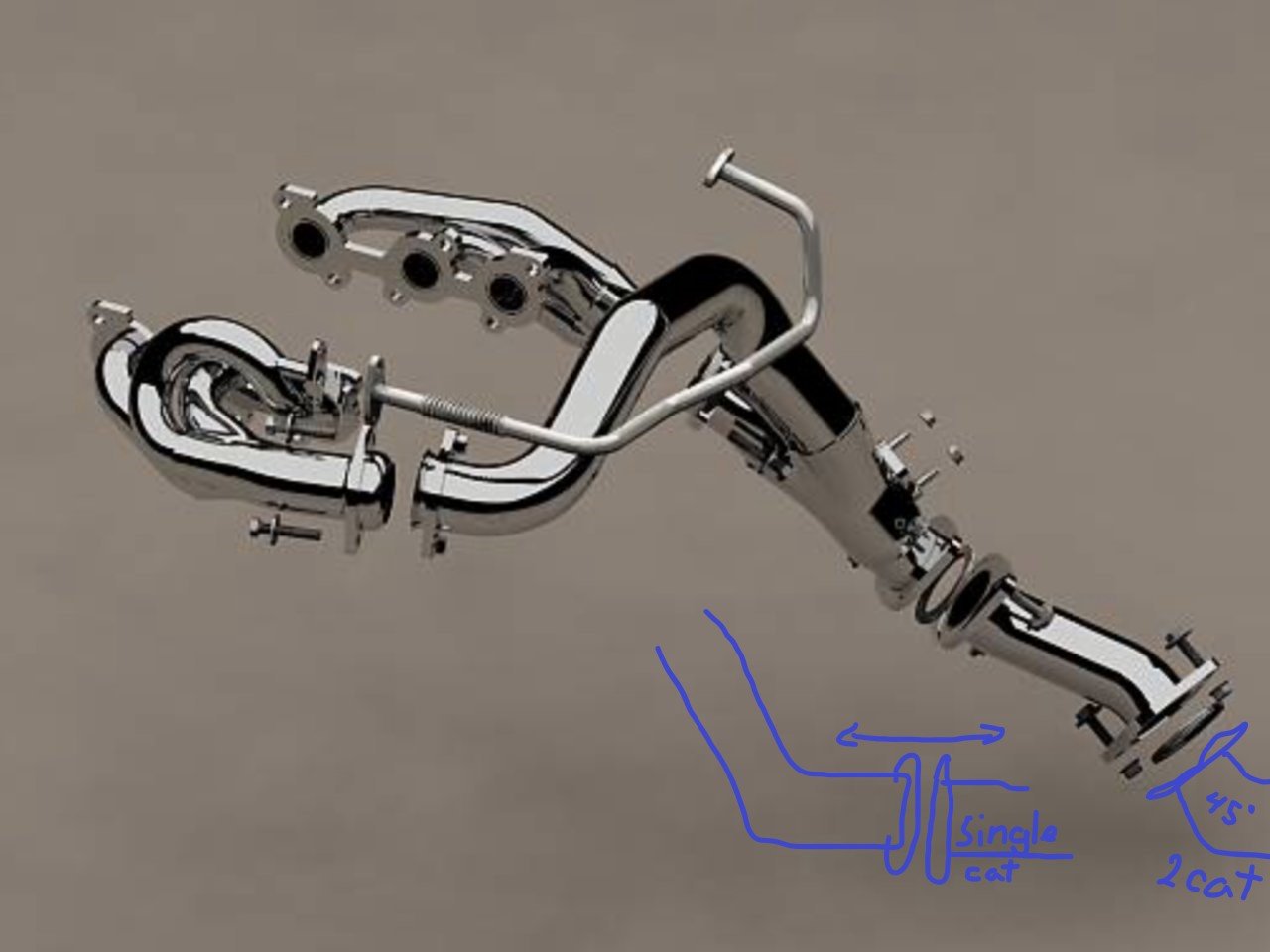

    I just installed a set of TRD headers on my truck and I think it would apply to your situation. My truck came with 2 cats. My plan was to install the headers and cut the old cat and weld a new flange as others done in the past but when I installed the headers it turned out that the space for the 1st cat wan no more. I ended up with a 4'' gap between the down pipe and the 2nd cat. From doing some research it looks like the headers I bought are for an older truck with a single cat. If the main design is the same the way to tell is the 2 cat truck the angle lines up around 45 degrees where the single cat is a straight connection. here is some pictures to help better explain. Hope this helps.

    I don't think he needs to do any welding at all as the headers should bolt up to the single cat.
