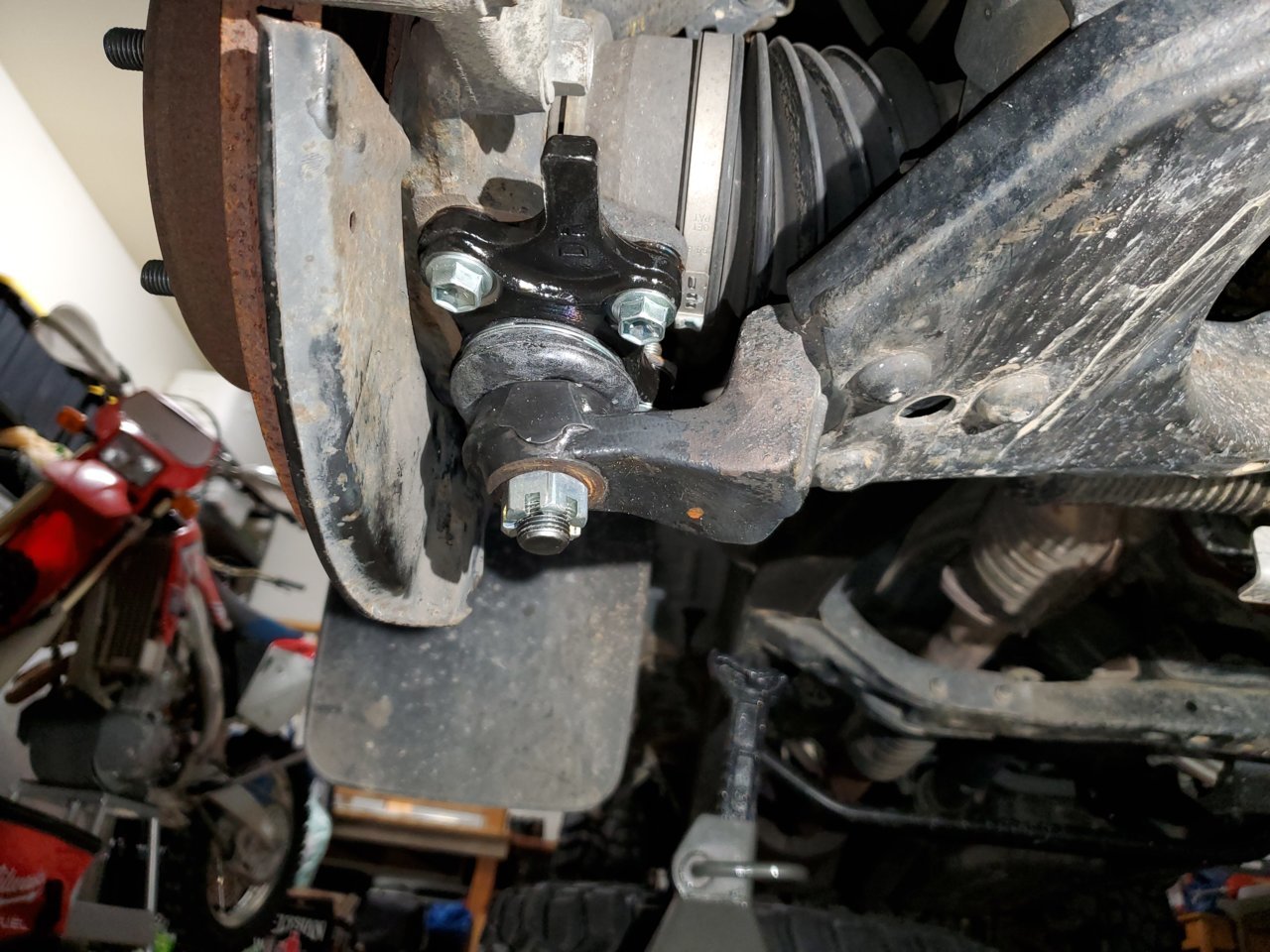

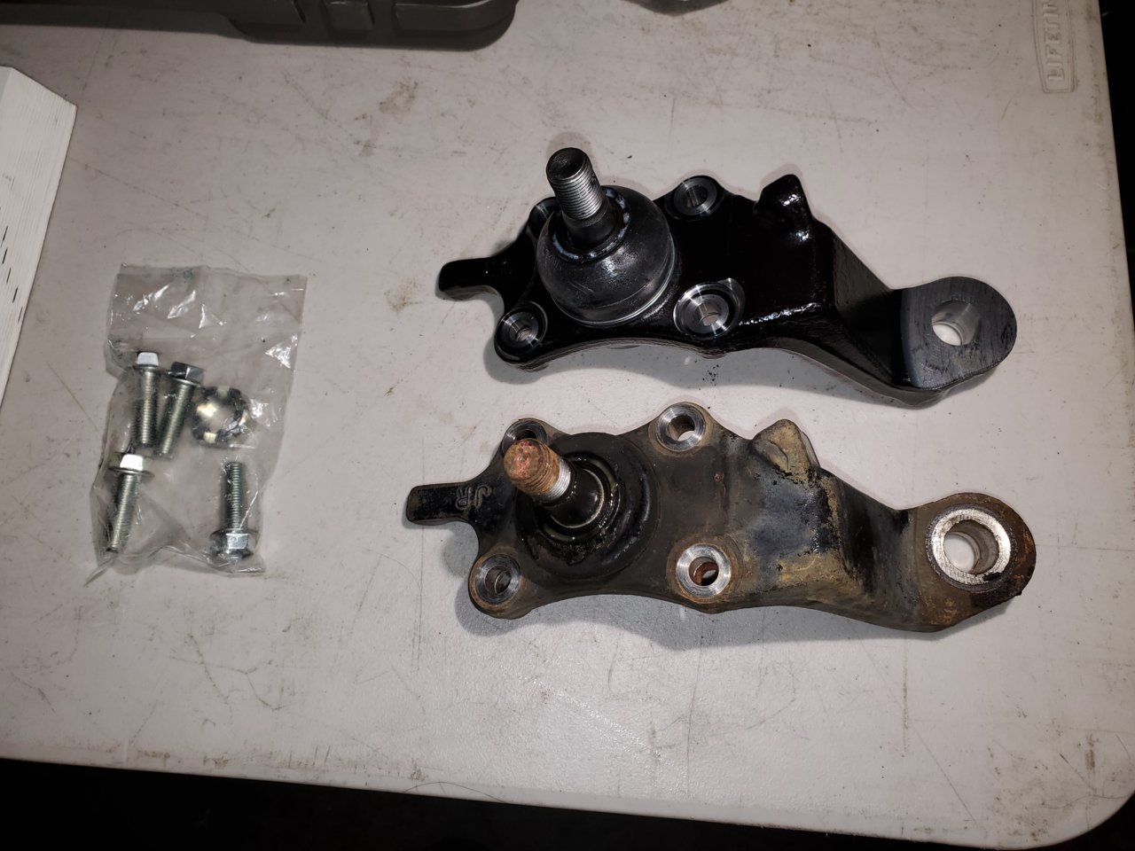

    Drop bracket lift and booger welds

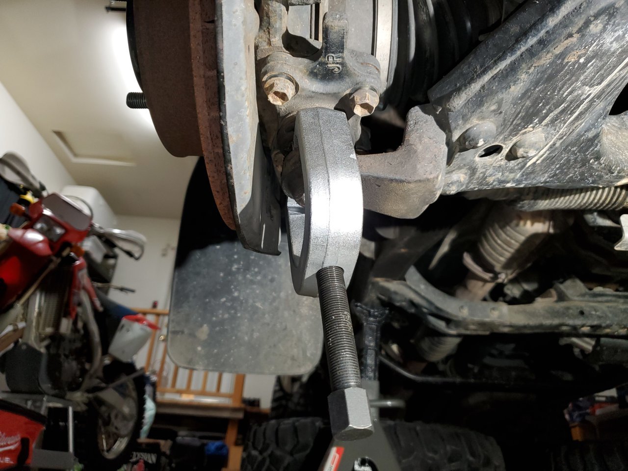

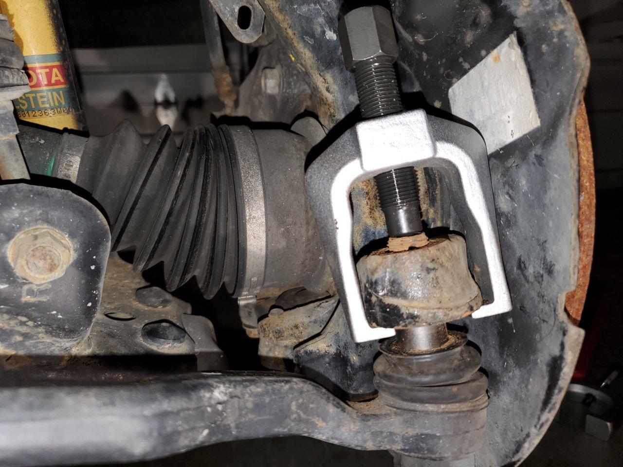

    Which kit? My normal Pitman puller worked well on one lbj but I had to mill a new smaller one for the other and I’m still not happy with the fit.

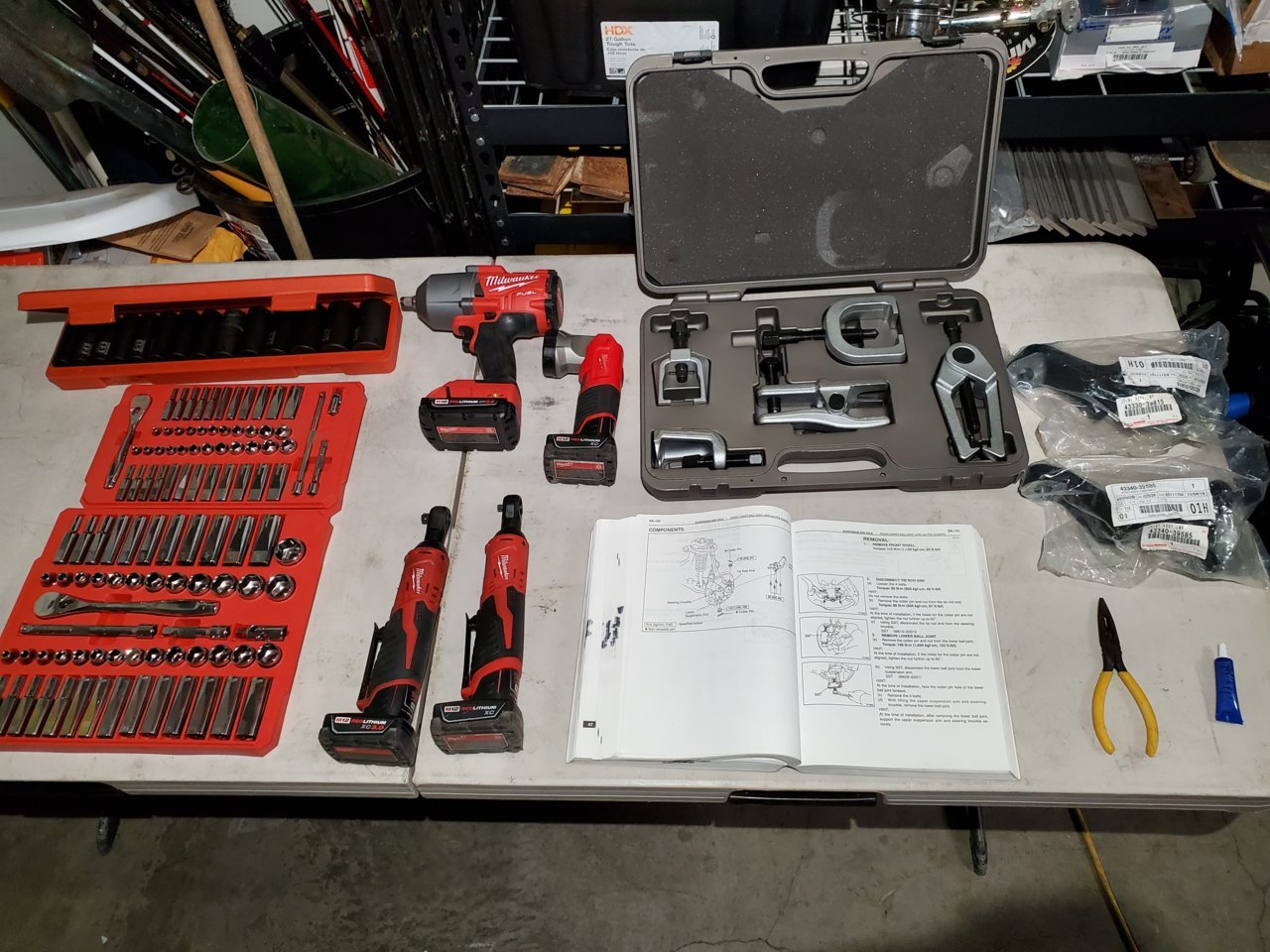

    i looked up a pitman puller tool @ HF for about $15 will fit into tight spaces (not as much as i was expecting!), will that be inadequate for this procedure

    Nice photos, tackling this tomorrow. Looks like I'll go rent a puller, looks like it'll save a bunch of time!

    If you're talking about this one: - I suspect that would work. I bought mine at Advance Auto for $16, it has approximately the same size opening.

    yes, that is the one
    looks like it can also be used on tie rods if i need to replace those at some point as well?

    Yep. It's a required tool for front end work IMO.

    Pickle fork+BFH will work too if you want to replace things since they tend to rip boots.

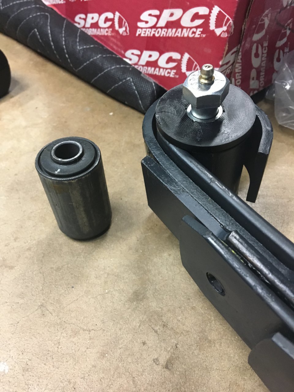

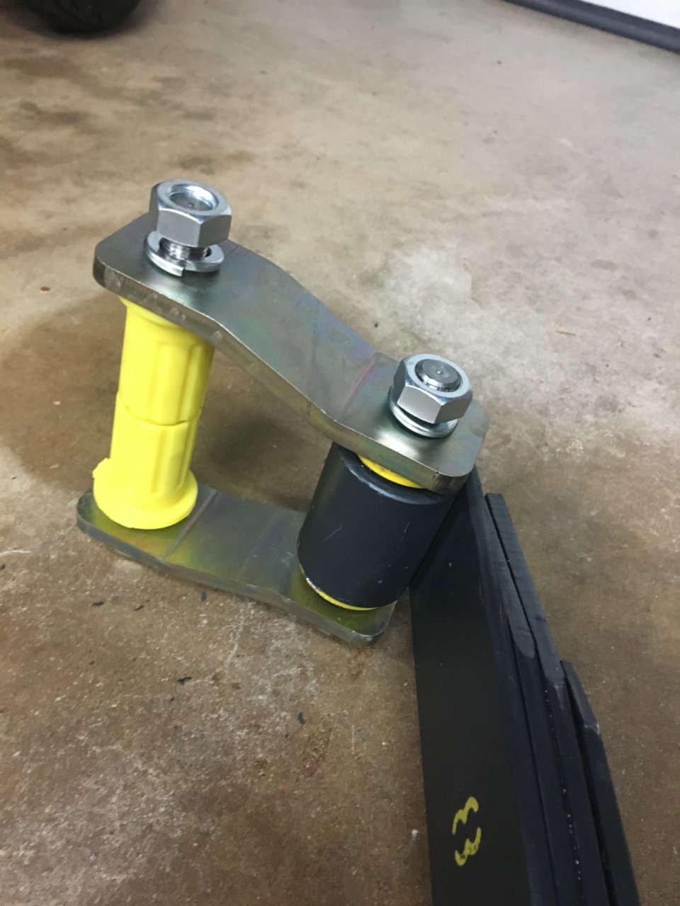

    Getting closer... finally starting lift tomorrow. Took apart the Dakar leaf pack and added the AAL, Got the shackles built up and popped out the stock OME front eye bushing and replaced it with the grease-able day star one. Next pics will be progress shots of the install! HAPPY THANKSGIVING!
