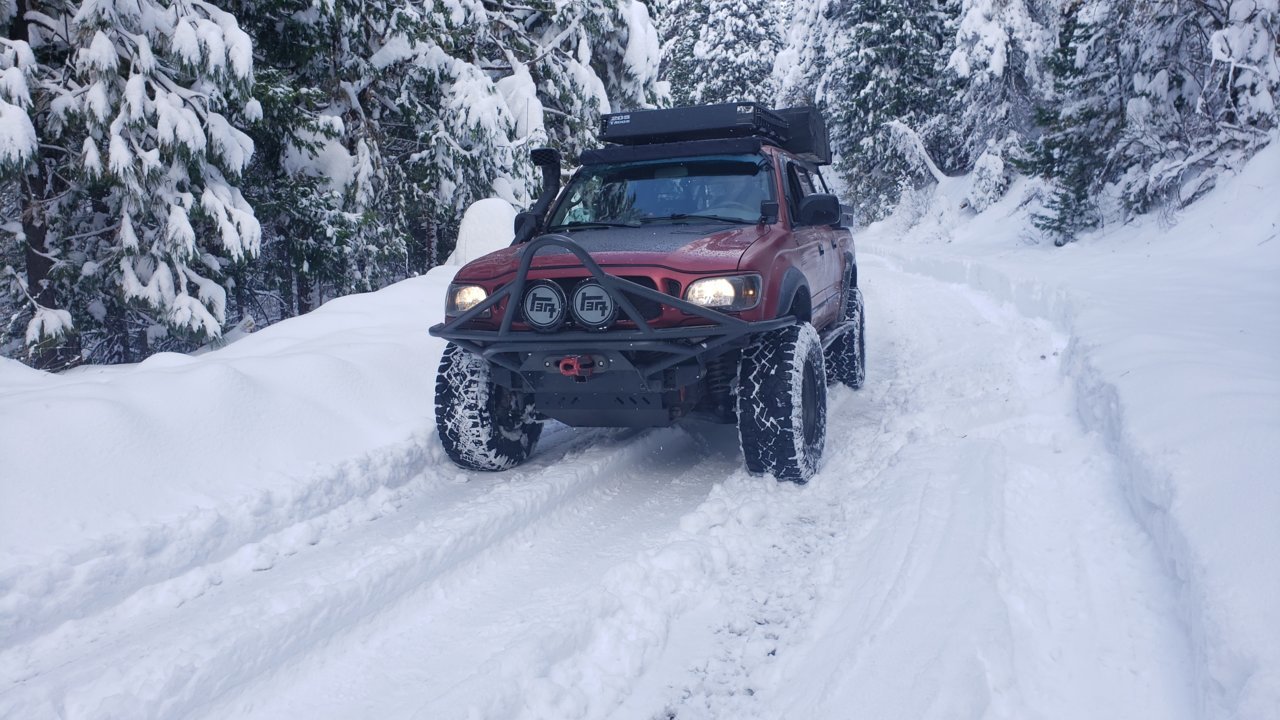

    Found some white stuff to play in.

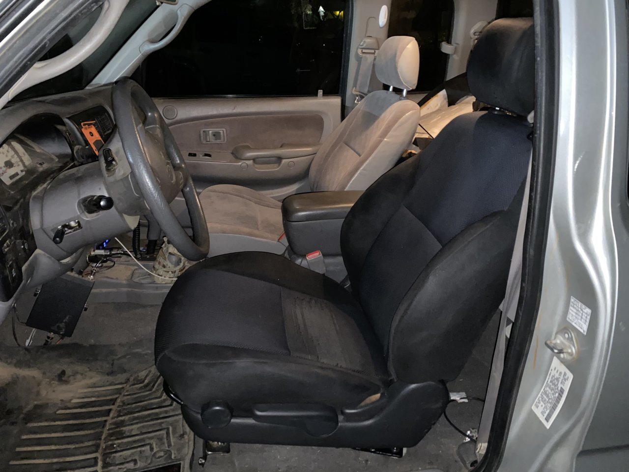

    Swap that damn cushion!

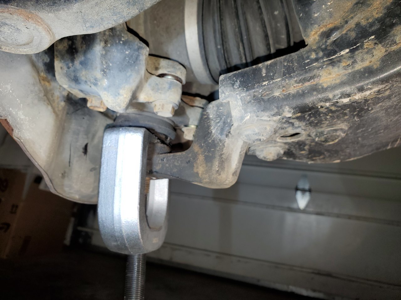

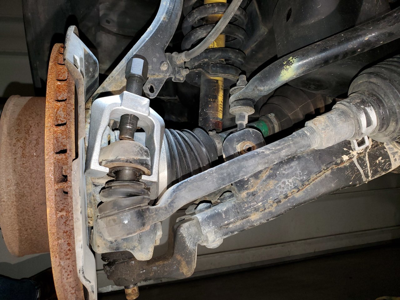

    Completed the driver side LBJ replacement.
    Old joint, greasy...
    Pullers worked great again...

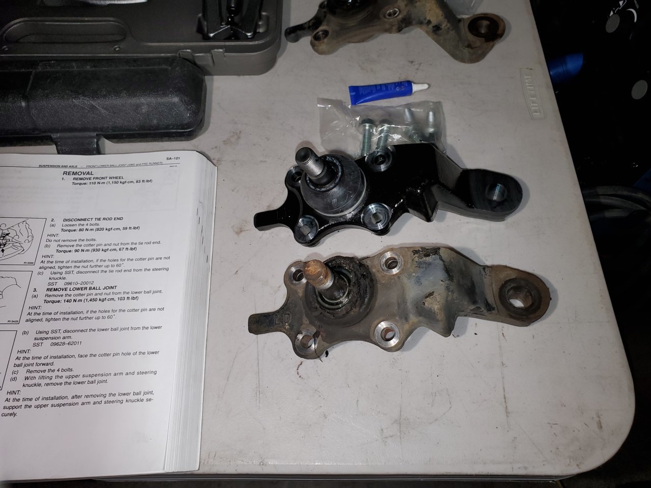

    Old vs. new...
    All installed and torqued...

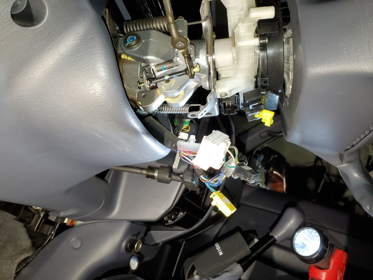

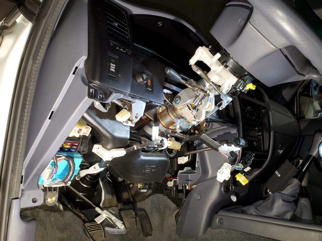

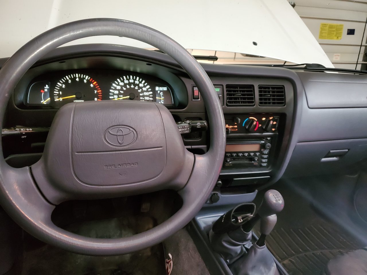

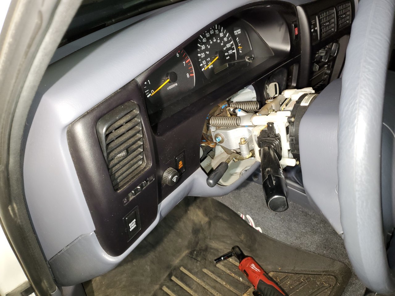

    Got around to doing a few things I've been meaning to do for years. Tack weld the slip joint and install LED dash lights.
    Removed steering trim, turn signal cluster, detached electrical...
    Removed trim panels under dash, stereo bezel and cluster bezel...

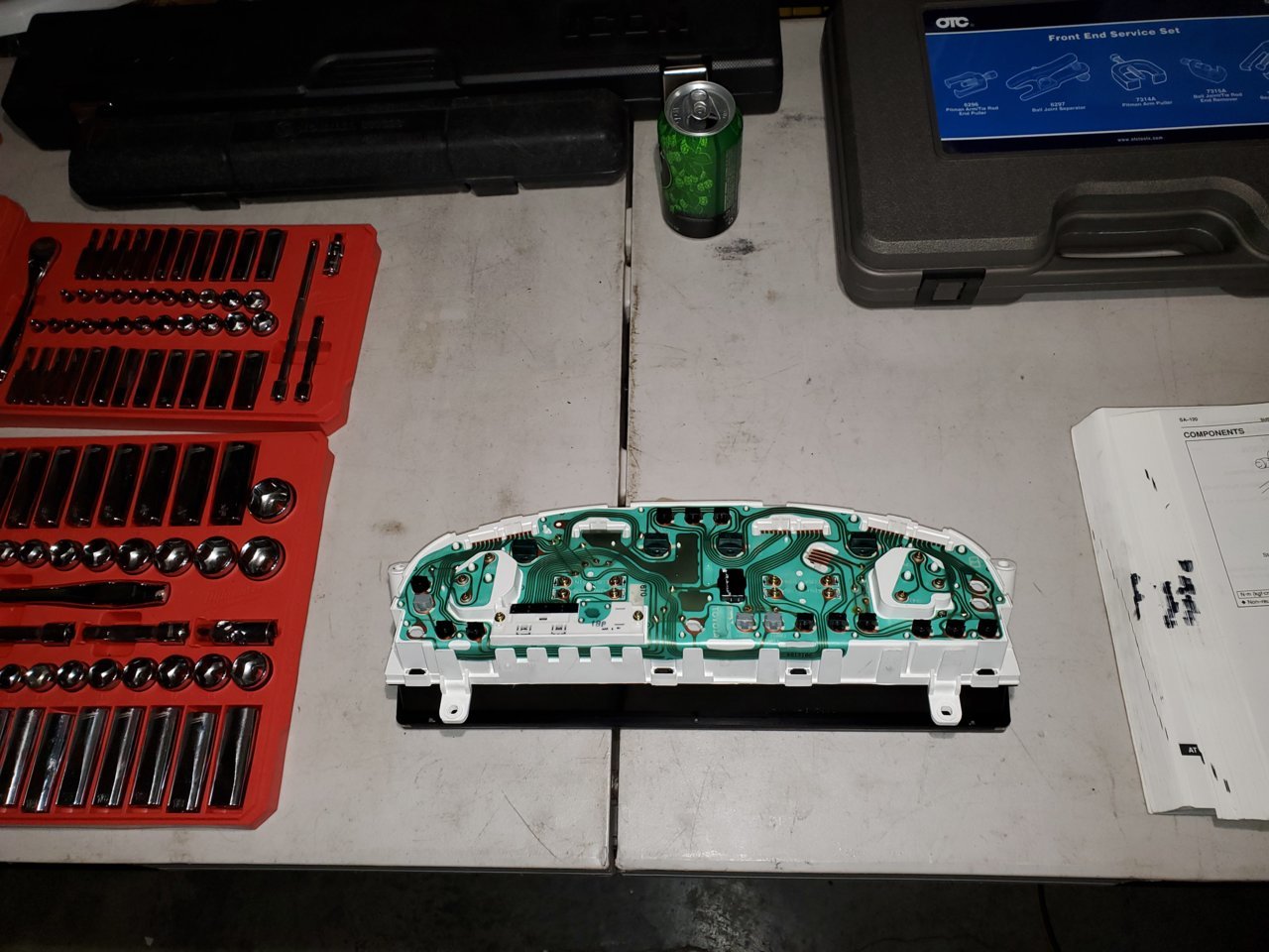

    Removed gauge cluster, replaced bulbs with LED's...
    Tested before reassembly...
    Removed steering wheel/shaft assembly...
    Made a shim for the tilt ball...
    Tack welded the slip joint...
    Reassembled the whole deal...
