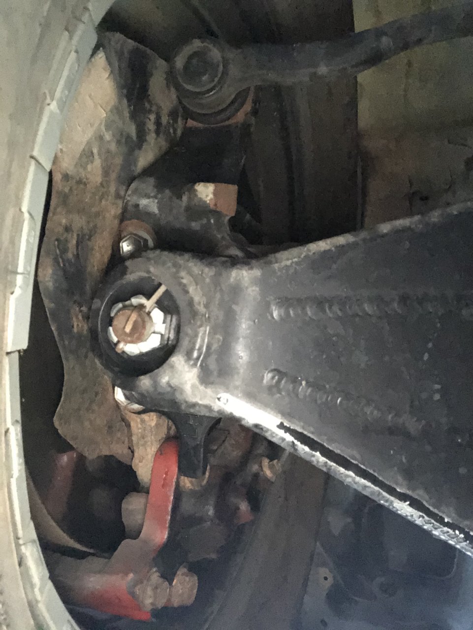

    This is what I was showing as far as threads after install and torquing everything down. I wasn't bottoming out and I was able to get proper torque on everything.
    [​IMG]Solo 13 by Matthew Jakobowski, on Flickr
    Since install, nothing has backed off and everything is still tight. Both cotter pins are still in place (see shitty picture below, taken 5 minutes ago).
    My guess is that when they designed these, they based it off of a 3rd Gen 4Runner and not a 1st Gen Tacoma. I know the LBJ's for these vehicles are different but I'm not sure in what ways. Right now, my guess is that the thread count on that one bolt with the castle nut is very different since I experienced none of the problems you are.
    If you need me to get any other pictures of how things are lining up, let me know.

    the only difference I am aware of is the Tie rod end stud is much smaller on the 3rd gen 4runners. Otherwise it is the same. Uses the same OEM LCAs and spindles.

    Maybe Solo fabricated your LCAs incorrectly. - Made the tapered hole too deep.
    I can't remember. Have you tried a different LBJ and had the same problem with the 2nd LBJ? If so, I'd say this is an error on Solo.
    I don't think it's in the "design" because @MattJakobs has been running them, no problem and from what I'm understanding the ball joint stud on 3 gen runners is the same as 1 gen tacos.
    At first I was wondering if the MT LCA was designed with a bigger hole to accept the solo LBJ... but Matt's experience kind of rules that out.

    So based on , the 3rd Gen 4Runner and 1st Gen Tacoma do infact have different lower ball joints.
    The part numbers are also different.
    For Tacomas:
    Left (Driver side) LBJ: 43340-39585
    Right (Passenger side) LBJ: 43330-39815
    For 4Runners:
    Left (Driver side) LBJ: 43340-39465
    Right (Passenger side) LBJ: 43330-39585

    I haven't tried another LBJ yet which is why I haven't contacted them yet.
    Right, thats what I was saying. The tie rod part is different. The actual stud to connect to the LCA is not different. The LCAs are the same.

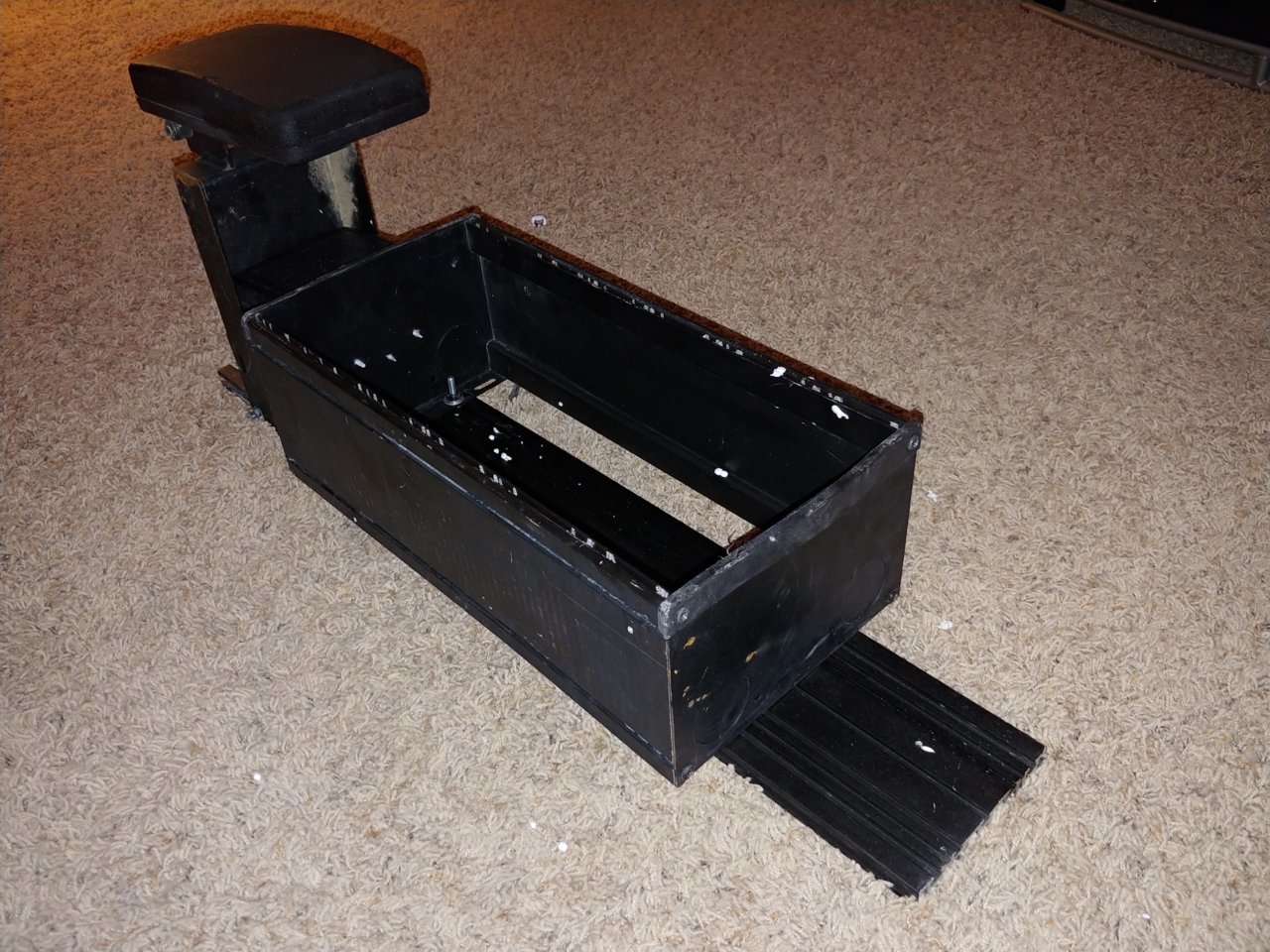

    Got a crown Vic center console for gauges, radios, and switches... Plus a good arm rest

    Gotcha, sorry I didn't pick up on this. Do you by chance have any additional pictures of your LCAs? I took a good amount of pictures of the arms before installing them. Doubtful, but maybe we can see if there's any super noticeable differences.

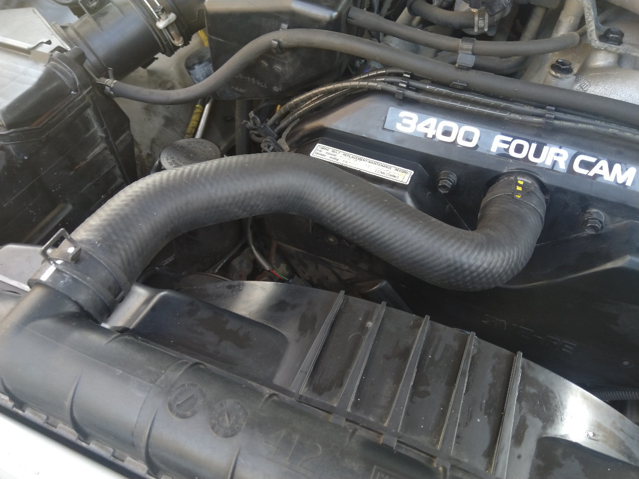

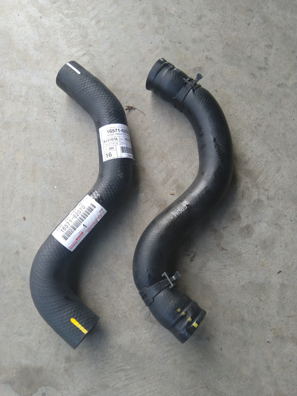

    Replaced my leaking upper radiator hose. Picked up a new hose and clamps at my local dealer for $41. I was surprised how much the old hose had deformed.

    Just because pictures are worth lots of words, here's the photo that shows the Taco (new parts below) vs. 4Runner (old parts below) LBJs and OTREs. You can see the different angle of the tie rod "ear," and the different size of the OTRE stud as well as a slightly different shape. From the post @JasonLee linked.
