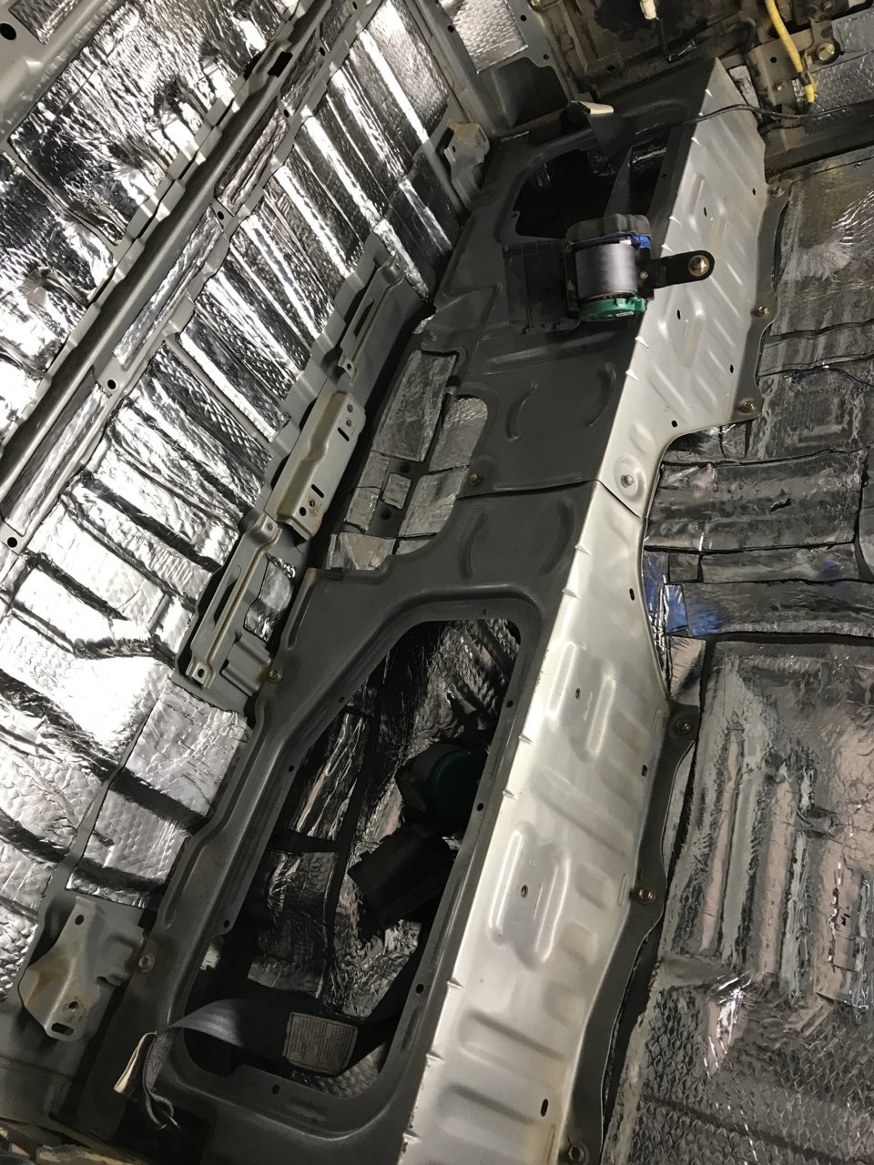

    About done with sound deadening. 32 sq ft covered all of this. Still have to do the doors and a few spots here and there.
    Should I add any to the boxes in the rear?

    Apparently the guys that have really gotten into this with their tacos found the most road/air/outside noise tested at the roof and doors. Dunno if you can do above the liner but while you have it apart man I would. Just because that's the biggest complaint of those who have done floors and sides. Your doing the doors still? Apparently the foil/butyl stuff keeps wind/air from resonating right? And then you should have a layer MLV that physically blocks the sound waves that are created and then your carpet or whatever. At least the car audio pros sites that's what I read. Biggest help for me on road noise and not exaggerating was changing to old man Michelin LTX M/S tires. I am able to stay sane now when driving longer than an hour:D:cool:
    Definitely let us know though your thoughts after you get it all buttoned up and tested

    Yeah, doing the roof will make the biggest difference. And doing a layer of the actual sound deadening material, usually a thin foam of some kind like Dynaliner or Noico green or red sound insulation, will block most of the actual noise as well as provide a layer of insulation, keeping the interior cooler in summer and warmer in winter.
    I need to do the roof of my Taco still, did the floor when I installed the vinyl flooring.

    Not really looking to pull the headliner but I'm already this far in.....I'll look into pulling it more tonight
    Edit: well just looked at @turbodb write-up and it's like 5-6 more bolts and some clips. May as well ha :bananadead:

    Sweet man, you're after review is gonna be the important one a lot of folks are gonna wanna here. Me included:D
    I really hope it all helps to make a nice noticeable difference
