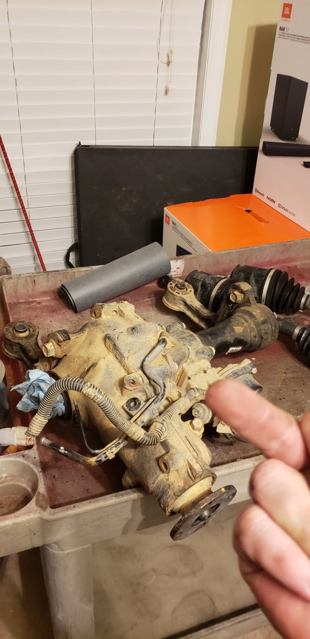

    Pulled this asshole today. Wasn't as bad as everyone says though. Going to send it to ECGS next week.

    Regear. And night as well make the financially sounds decision to add a locker I'll probably never use...

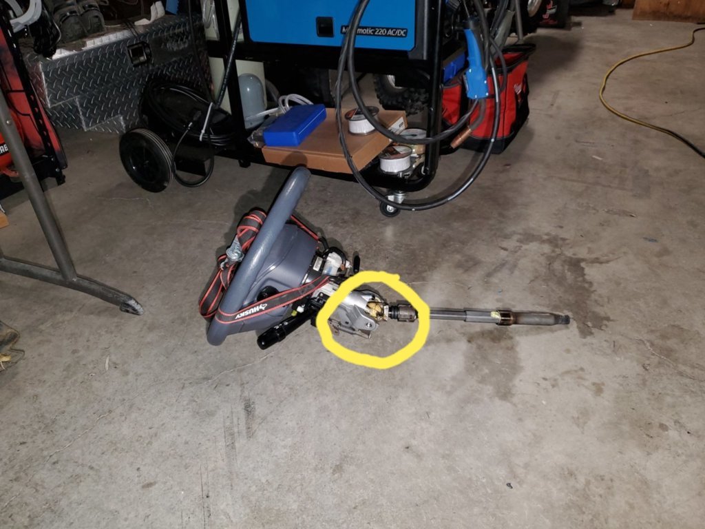

    Just for clarification, my steering was pretty tight and I didn't really "need" to do the tack weld mod or the tilt ball shim. I did notice a certain vibration over washboard stuff though. It was all attributed to the tack weld and I did the tilt ball as a "while I have it apart" mod.
    No problems with HVAC/vents though. Sorry, but I'm certainly not going to disassemble/reassemble components if I don't have a need. You know, if it ain't broke...

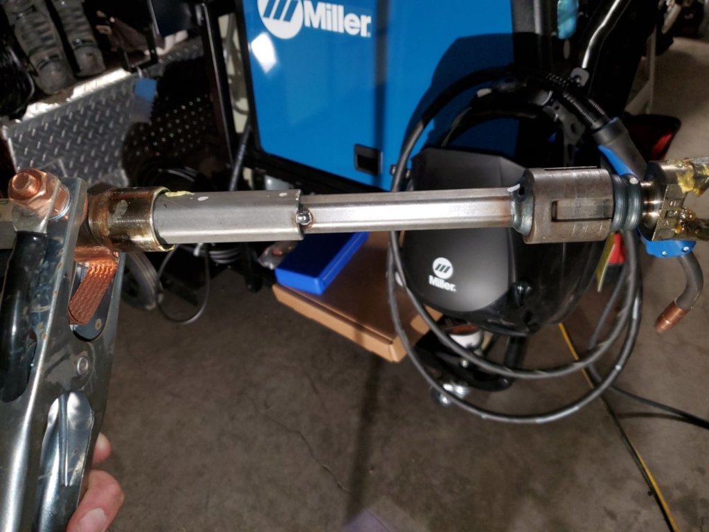

    I believe that’s where the slop was, in the slip joint. I believe that the shaft was not fully inserted the upper rag joint/u-joint and too far into the lower rag joint, at the rack. I haven’t had a chance to drive it again, not have I had anyone around to turn the wheel while I look from underneath. Once everything was back together, there seems to be a difference in movement. I don’t believe I’m having to turn the wheel as far before the wheels start turning. However, it does feel like there’s a slight catch when turning...like you hit a slightly stiff spot.
    FWIW, everything else checks out. Rack, guide, bushings, TRE, everything is tight. I started checking the upper joint after taking it to get aligned and trying to figure out the steering shake. With it on the rack and moving the steering wheel, there was noticeable slop looking up into the joint area. I say the joint area since the joint isn’t visible without taking the column out.
    tack weld mod has been done. Haven’t done the tilt ball shim, may do it just because now. I’ll watch timmys video.
    I didn’t really know what to search for, so I didn’t know if anyone had ran into trouble with this joint, or had seen where it actually went ‘bad’

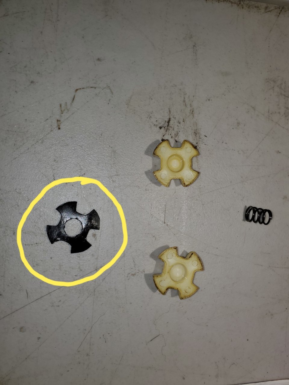

    If you watch the video from @Timmah!, it shows how to check the joint(s) in the column without assistance from anyone else. My tilt ball was pretty tight, and the shim made it EXTRA tight. It was actually quite the struggle to get everything back together. Made the steering tight AF though, just like it should be.
