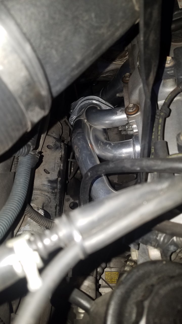

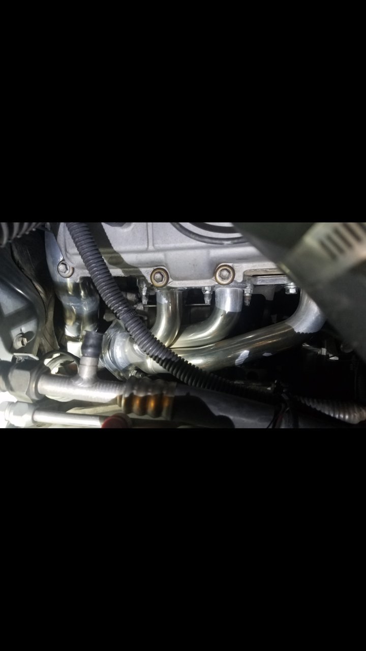

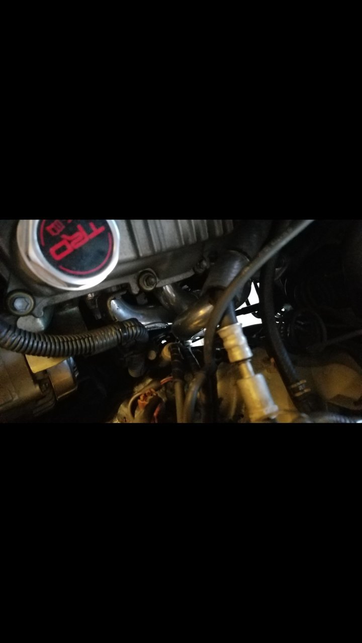

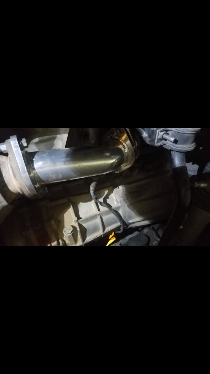

    Nice!
    Should just get rid of the egr.

    I would if there was a way, it would not pass emissions, I’m not sure if there is a record that shows it’s an EGR truck.
    I would hate to remove it all and the inspection says it’s missing and fails
