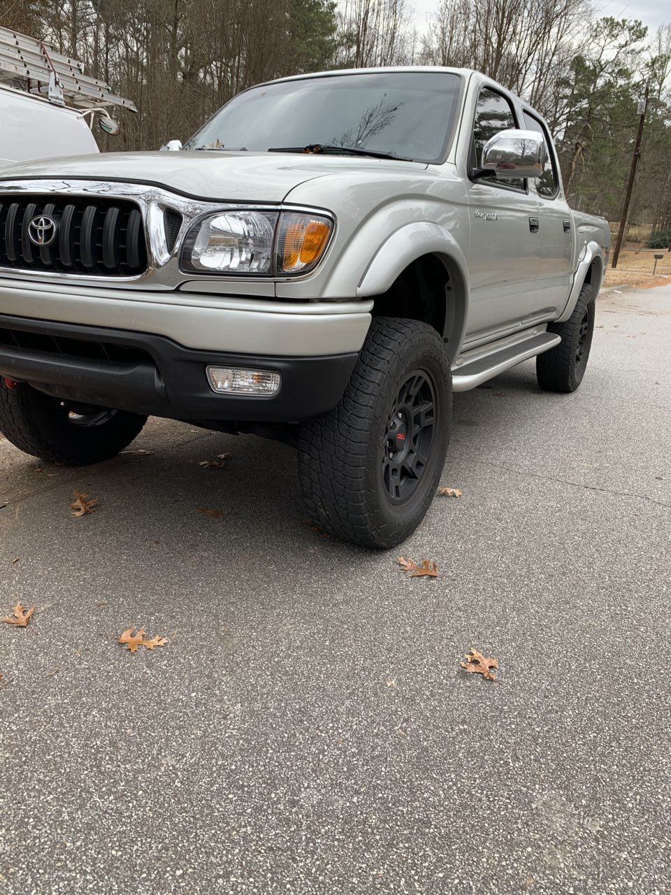

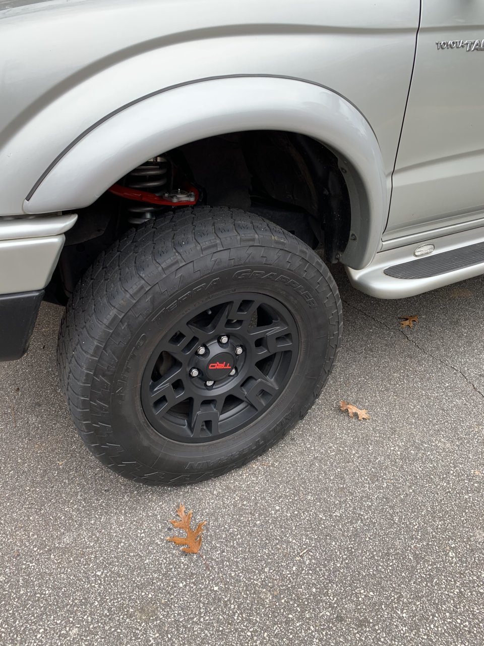

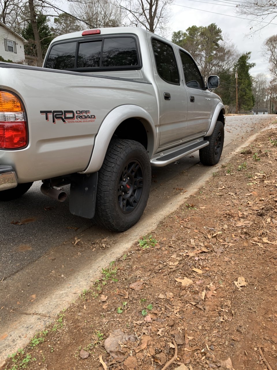

    Here’s a couple of picture of my 2003 trd off-road Tacoma limited. Purchased it about 6 months ago and right away I changed the suspension. It was horrible before. It was raised 3 inches in front and I think either 1 1/2 or 1 in the back. I changed the headlights and I’ve done many mechanical services to it. I did a upol raptor bed liner. But, Nothing inside though.

    All the little fine details on this thing, at least in pictures 10 ft away, make me think this thing is in really really nice shape. :cool:
    The body panels and pieces all look to line up true as if they've never needed to be removed. Which is a good thing cause you can never get it put back perfectly as it was original. If it has had work done on the body they did a really nice job... I doubt it though, it looks too straight to have had any body work done on it

    Yes it’s in flawless condition. Might need a paint job in a couple of years tho
