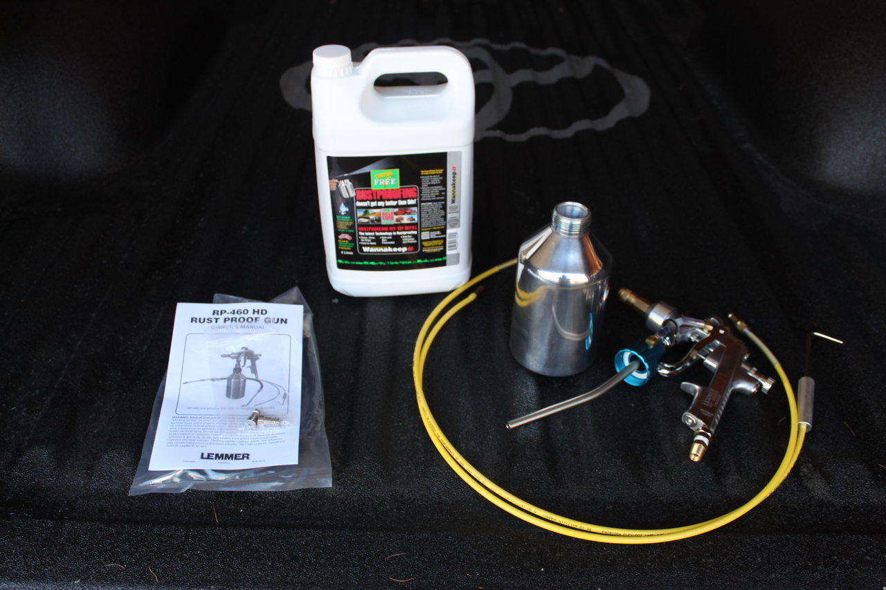

    i am putting it to the test currently on a weathered front suspension
    blurry picture of product ,needs air compressor to spray
    also putting it head 2 head with the FF in a rattle can
    this will be a most fun and interesting experiment (hopefully)

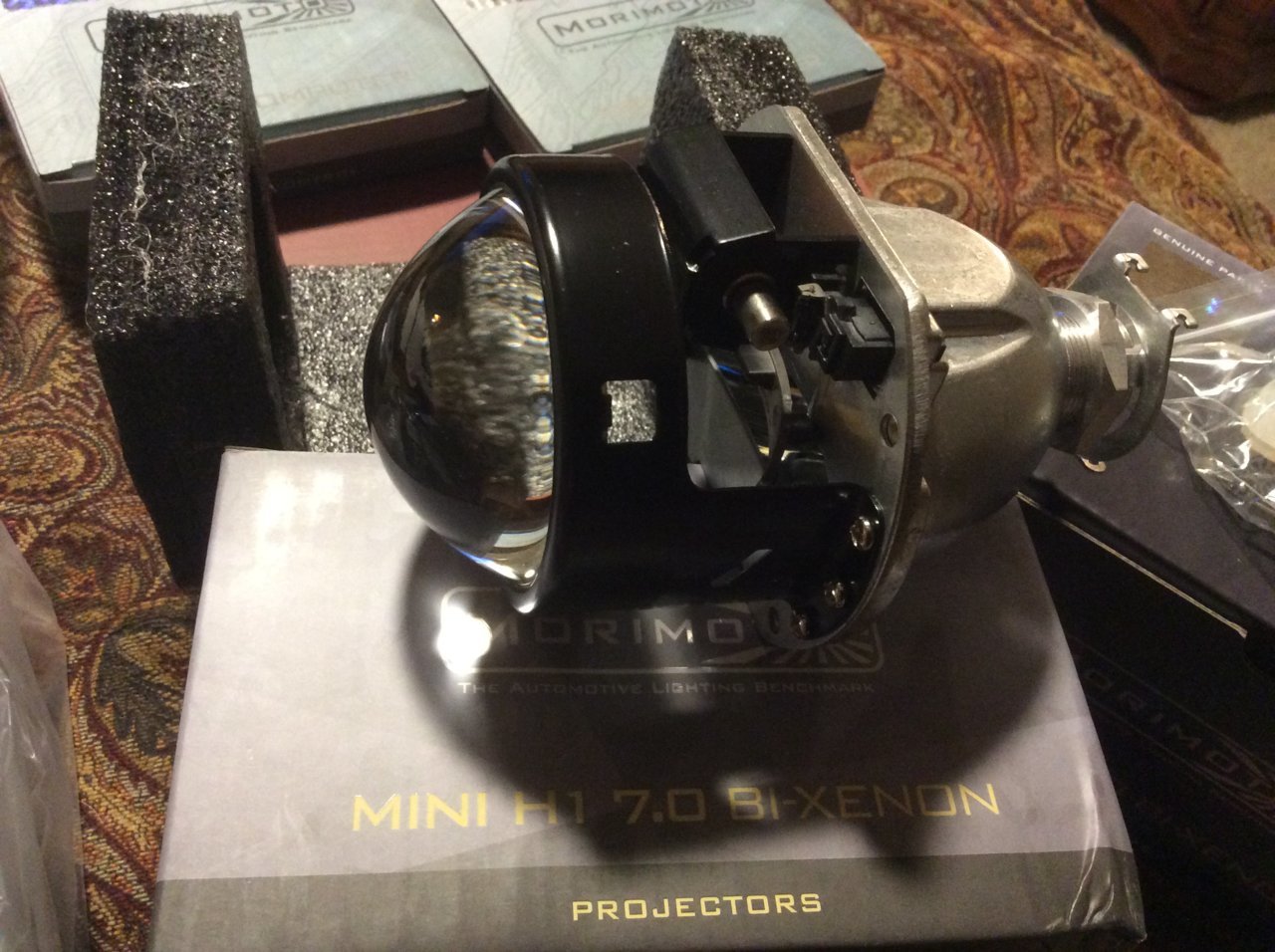

    2nd Black Friday special deal came in today, another project to start now that headers are done..
    Morimoto Mini H1 7.0 LHD Bi-Xenon Projector Light.
    IM finally going to have the powerful headlights lights the truck deserves like this below.

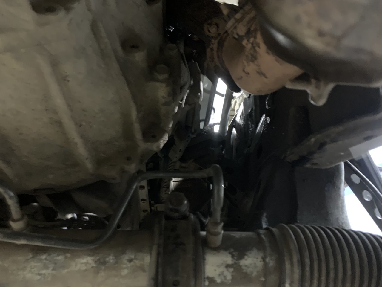

    Looks can be deceiving. With 2wd models, it's no problem getting the starter out from below. But, it's pretty common knowledge that the 4wd models aren't as easy. If it was as simple as taking the starter out from underneath, I think people would be doing it. I'm talking more from experience with 3rd Gen 4runners and maybe 1st Gen Tacomas are slightly different and afford more room. If somebody wants to show me on their 4wd 1st Gen Tacoma how they easily got it out from below, I'll be a believer.

    I think the 5 speed Tacoma is pretty easy from getting it from the underside,

    That's how I've always done it as well. Done it several times.

    I think same but it’s been a while. Had it out a bunch back in my puddle smashing days. Rebuilt the contacts too. I definitely never loosened a brake line bracket. But also a manual 4wd with no sway bar. That auto in the video looked like it had way more shit in the way.

    It's less Tacoma and more mod
    Last time I did it, with Mike on the Red head it came out the bottom too. Going out the wheel well was too hard to get an angle on

    I second this, you can pull the starter out from the underside on a 5speed truck cause there’s no auto trans dipstick tube in the way. If you pulled the dipstick tube and trans pan, you could pull the starter out the bottom

    Yeah, my experience on 3rd Gen 4runners has been with 4wd models with automatic transmissions.

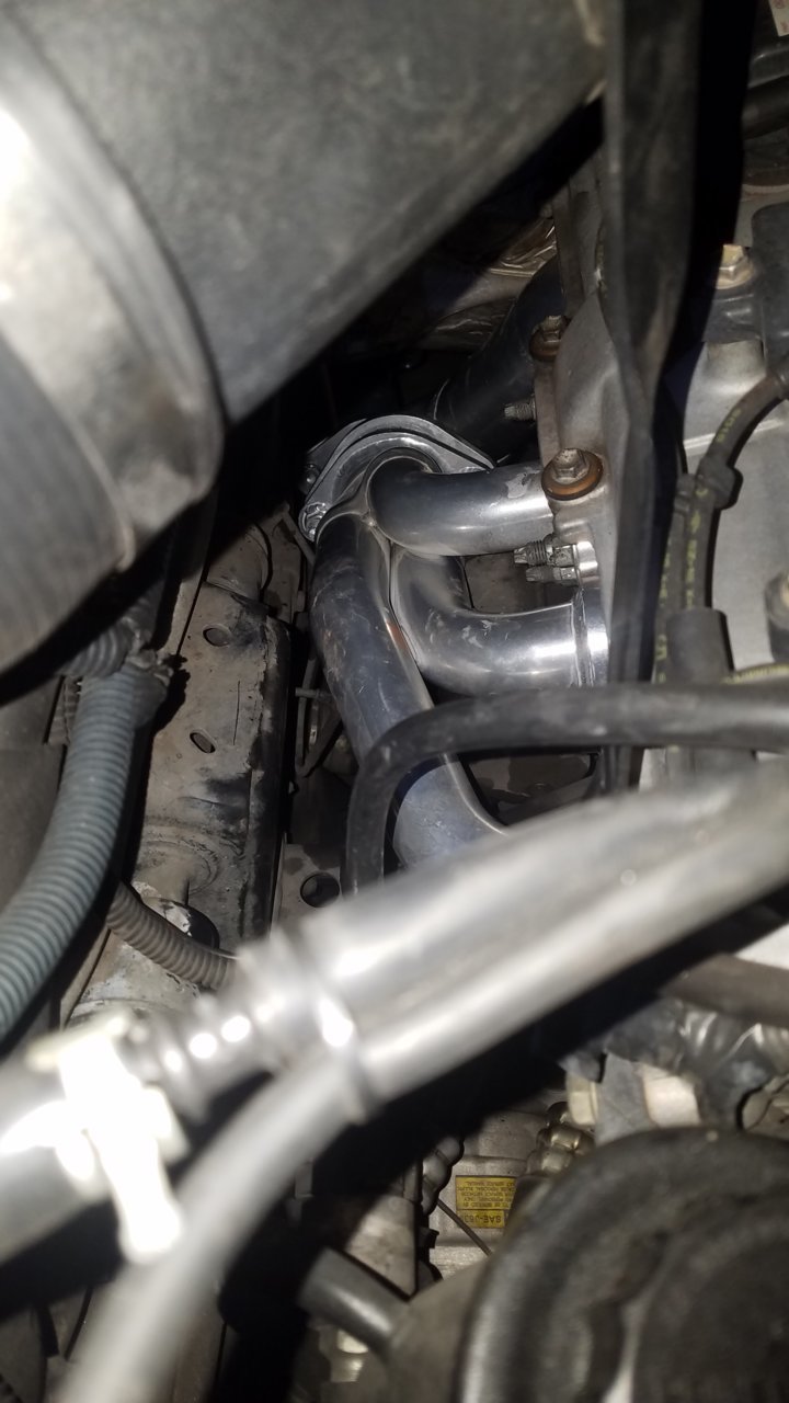

    Now, with a set of headers on that might be different tho.
    I will have to wait and see to cross that road.

    the tech I apprenticed under used to tell me horror stories about removing starters to do starter contacts on 3.4’s with TRD headers back in the day. I definitely took that into consideration, luckily I’d done contacts the year before, so all I did was inspect them and put it together

    My starter replacement with TRD headers was pretty easy.

    as I said they were just stories, I never had to experience it. From a glance it looked like a major PITA.
