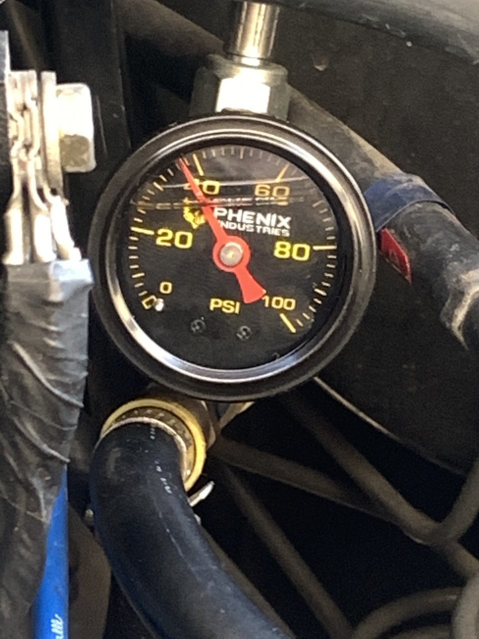

    Installed a fuel pressure regulator today. Reading at 37psi. Anybody else know what theirs is? Looking around online Gadget said it should be 43.5 and the FSM is wrong at 33-38.AFEDCCA6-4DA9-4FE9-A65A-FE2BD9157482.jpg

    If I remember mine was 42psi, BUT mine was failing because apparently
    under load it didn’t keep the pressure. So at idle it might look good but under
    load my be not at spec.
    I put a new one in and fuel trims came back to the zero area..
    What are your fuel trims?

    This what I’m chasing. Idle is high depending on the day and how I drive. As high as 12, they come down with higher RPMs but not as low as I’d like.
    Replaced all the vacuum lines. No help. So now I’m getting my injectors cleaned and I probably just go ahead and get a new FPR while I’m at it. I’m also thinking of replacing my fuel filter assembly with one that has replaceable elements.
    Almost everything is fairly new And OEM or Denso. MAF, Coils, wires, fuel filter, fuel pump, spark plugs, PCV.

    Just make sure your MAF IS 100 percent OEM.
    After going through 3 different MAF I went to the dealership and bought one and that also helped get me perfect readings.
    I had a DENSO MAF and two others that worked but were NOT keeping
    the trims correctly. There are SOOO many fake MAF.
    I would buy an OEM from the dealership and if there’s a difference, if not return it
