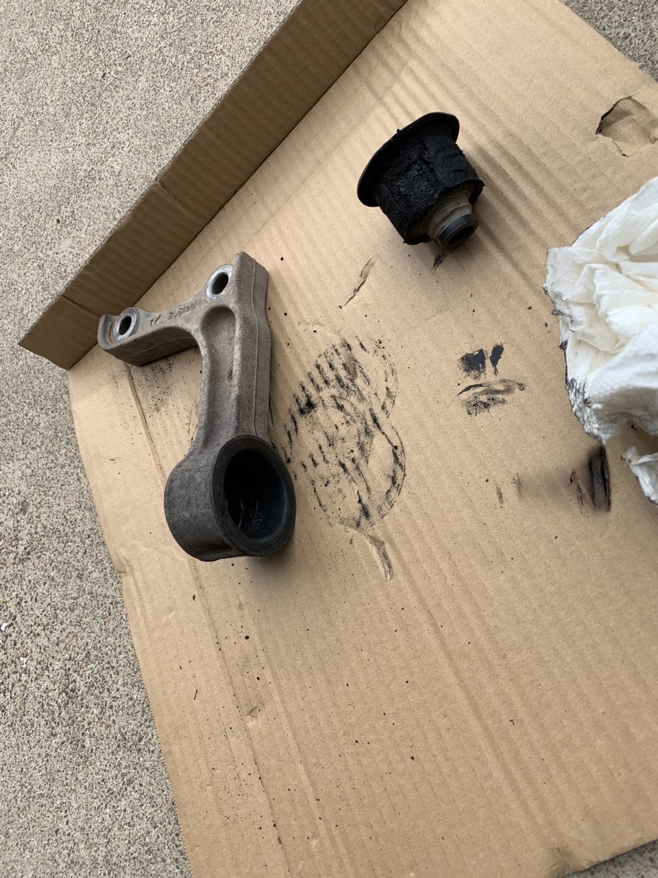

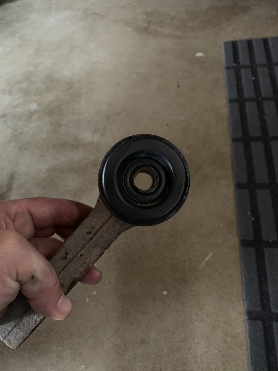

    It wasnt too hard. Time will tell how long these last.

    thats kinda crazy, glad my bumps havent split yet, and they have taken some solid hits. My driverside diff mount bushing or whatever theyre called was toast, since i dont have skids on right now I couldnt keep looking at shredded rubber hanging there when I had the durabumps replacements right there on the shelf

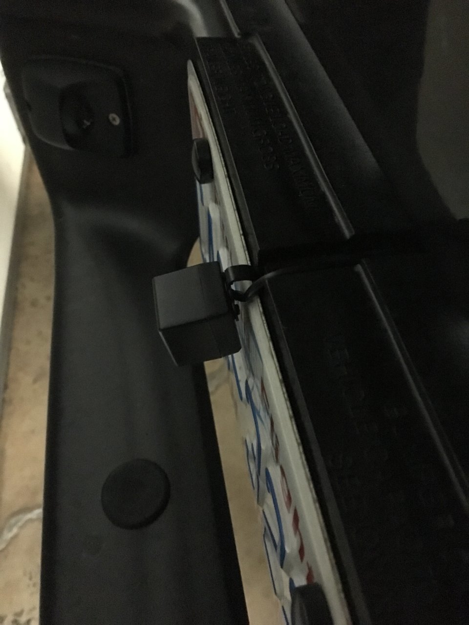

    Installed one of those IBeam license plate mounted backup Cameras today as well. Has nite vision. Pretty slick
