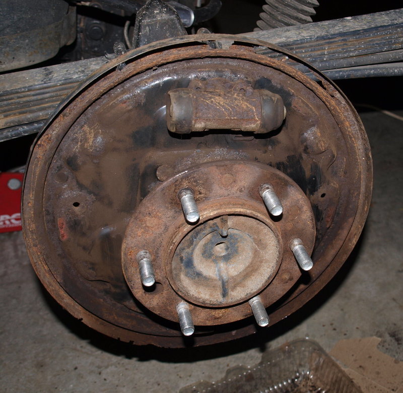

    You need to press the bearing and axle out of the bearing receiver cup, then pound the studs out.
    https://flic.kr/p/2gDn6z5
    https://flic.kr/p/2gDnSAy
    Basically the same process as replacing the bearing but just the extra step of pounding the studs out and then putting them back in.

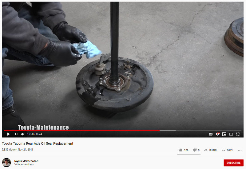

    Next step would essentially be to press of the various retainers, ABS tone ring (if you have one) and bearings. Essentially the same as doing rear axle seals (which I'd replace at the same time while you're in there).
    Here's my write-up of doing it, with links to part numbers, all the tools you need, and a step-by-step guide:
    nagorb, OneWheelPeel, Phessor and 3 others like this.
  13. Dec 12, 2019 at 6:39 AM
    CrustyTaco
    CrustyTaco Well-Known Member
    Jan 20, 2019
    #279940
    1,043
    Todd
    Louisville, KY
    04 Ext Cab V6 5MT 4X4 185k
    881/5100/Dakars 4R wheels / TBU / New frame
    That's an excellent write-up, thanks for posting it. I won't really have the space to store a shop press anytime soon though, so that might be one job I leave to the professionals.
    turbodb[QUOTED] likes this.
  14. Dec 12, 2019 at 8:04 AM
    turbodb
    turbodb AdventureTaco
    Feb 9, 2016
    #177696
    8,499
    Dan
    PNW
    2000 Tacoma Xcab 4x4 SR5 V6 TRD
    AdventureTaco
    I hear ya. You might see if you've got a buddy around with a press (or one who might want to go in with you on a press and then keep it at their place), or if you can take the axles to a shop to just do the pressing...b/c at least in my neck of the woods, a rear axle seal job (which is essentially what you'd say you wanted) is a costly affair.

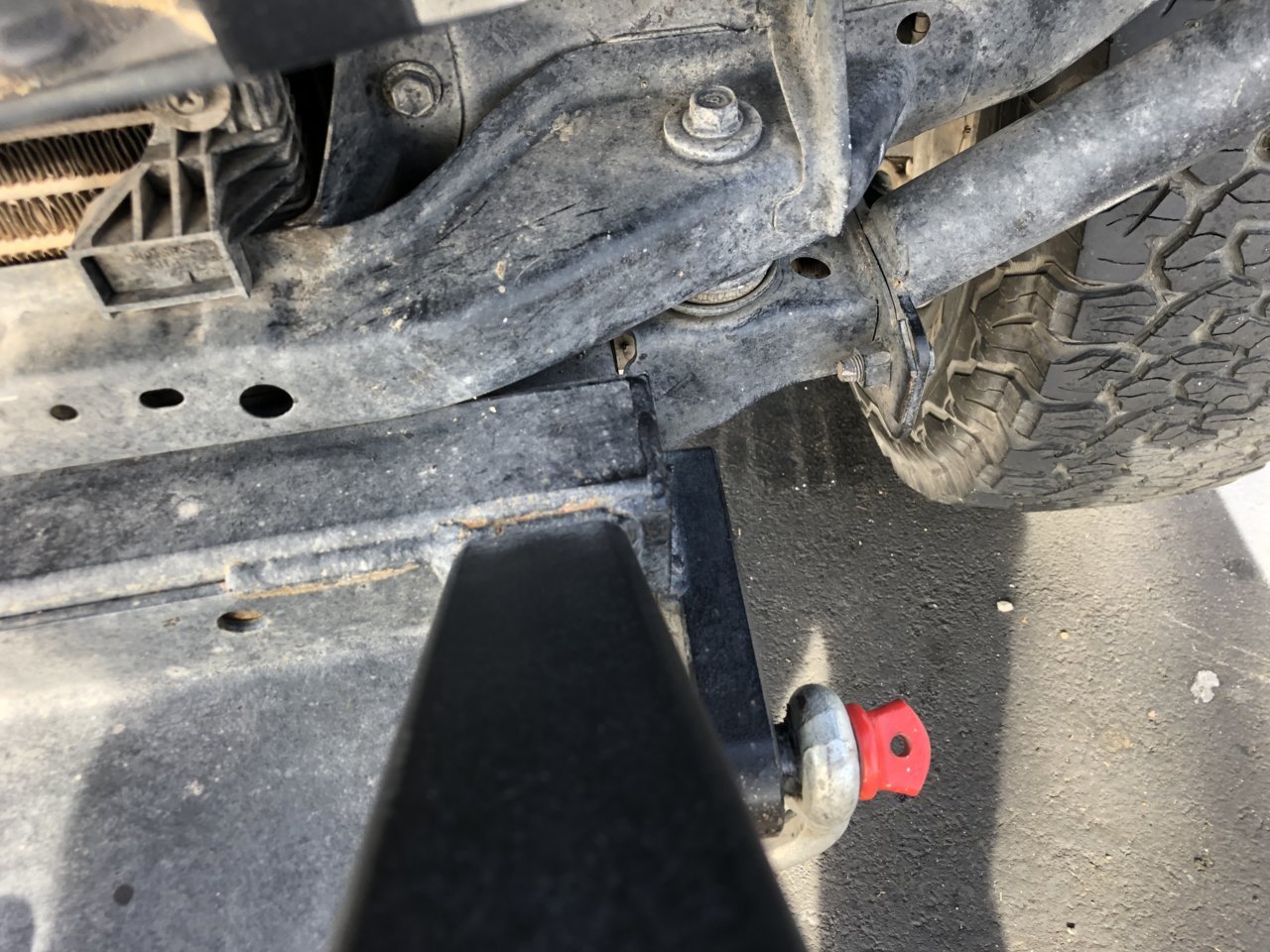

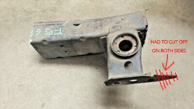

    Question for any of you 01-04 guys that have installed an All Pro front bumper (the Apex one in particular)
    Did your frame rail ends have this wing on them (marked in pic below)? Because my 04 does (or did I should say)...I had to cut those wing tips off for the bumper to fit, otherwise it blocked the bumper from sliding onto the frame rails.
    What's odd is that AP only states that this is necessary for earlier model year Tacomas, 01-04 should not require any cutting. Makes me wonder about my frame rail ends and why the heck they had those wings on them.
    Wasn't a big deal, I was able to cut them off with a grinder and then the bumper fit on as it should. It's sitting about a 1/4" higher on the driver side only because I installed it myself while balancing the 100lb bumper on a floor jack with 2 blocks of wood underneath...do not recommend. Have a friend help instead, lol. I need to loosen the bolts and even it out, but its on and I'm happy with it overall.

  16. Dec 12, 2019 at 10:34 AM
    Ace115
    Ace115 Well-Known Member
    Jul 2, 2016
    #191086
    1,553
    Andrew
    Tucson AZ
    '03 DBL CAB 4X4
    My ‘03 had those weird wings. I need to modify this section on my bumper but I did just like you and cut it off.
    SwampYota, xtremewlr and eon_blue like this.
  17. Dec 12, 2019 at 10:35 AM
    eon_blue
    Mar 4, 2016
    #180213
    69,573
    Azusa, CA
    Ok good, I feel better now...was afraid my 04 had something weird done to it before I got it. Odd that AP doesn't mention doing that in the 01 - 04 instructions. Only on the 1995-2000 ones
    cruiserguy likes this.
  18. Dec 12, 2019 at 11:18 AM
    Captain Magma
    Captain Magma Well-Known Member
    Apr 25, 2016
    #185258
    1,566
    Patrick
    Tucson, AZ
    2002 4wd DblCab
    Kings and desert pinstripes
    My 02 and 03 both had them. I just left them on with my trailgear bumper. I did kind of mush them inward during both installs, but not a big deal.
    eon_blue[QUOTED] likes this.
  19. Dec 12, 2019 at 11:59 AM
    cynicalrider
    cynicalrider #NFG
    Jul 25, 2012
    #83399
    17,128
    Jersey
    01 SR5 TRD 4x4, '23 Bronco Wildtrak, 2017 HSQV FE350
    Drop bracket lift and booger welds
    Chopped wings on my 01 as well.
    jubei, cruiserguy and eon_blue like this.
  20. Dec 12, 2019 at 12:22 PM
    cruiserguy
    cruiserguy Well-Known Member
    Jul 31, 2016
    #193416
    19,000
    Elijah
    SEKS
    2000 ext cab, 2.7L, auto, 4x4
    I thought I had read the opposite. That in general, in regard to the frames and fitting aftermarket bumpers, that the early ones will not need cutting and that the later ones 01 - 04 will need cutting for sure. The 98-00 I don't remember for sure what I read on that one, I wanna say that they didn't need cutting, but I definitely could be wrong.
