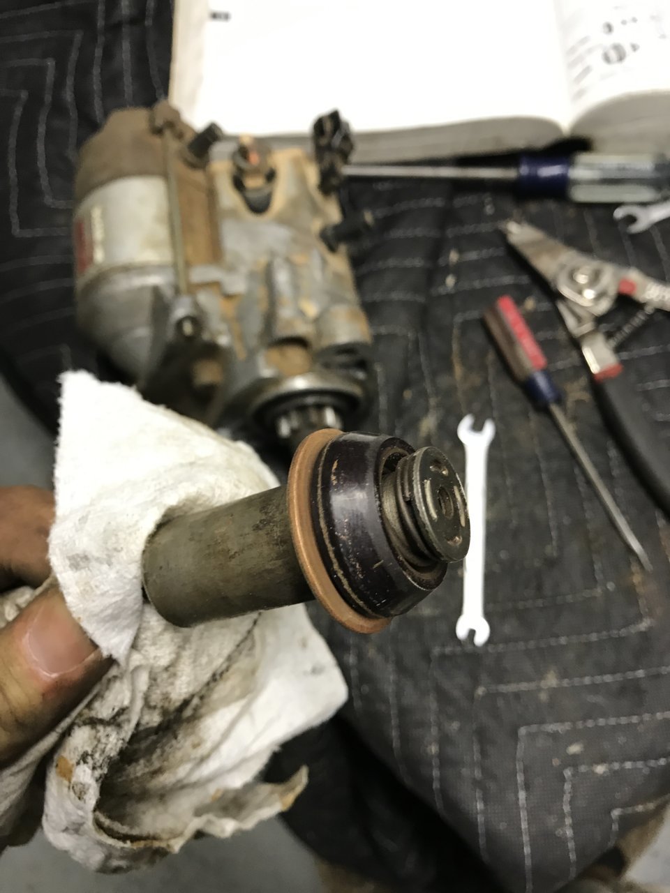

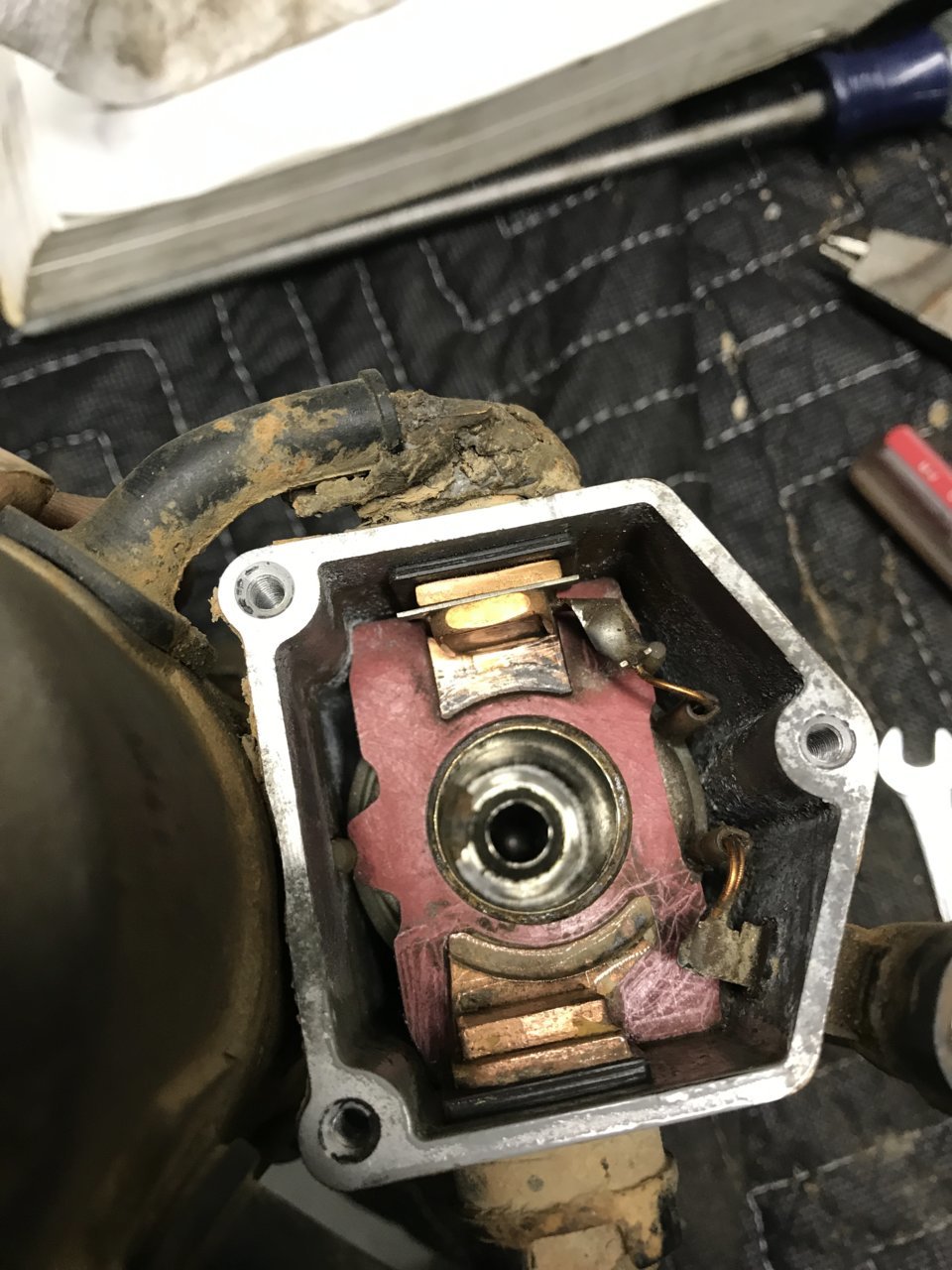

    What do you guys think? Put it back together or swap out the parts? I haven’t gotten them yet. But I did clean them up a tad
    Also my plunger was stuck to the top plate. Kind of think that was the issue

    Good looking man. The parts are cheap enough that I'd run to the auto electric house in town and replace em. That's the two contacts and the plunger. If you were wanting to run as is without replacing anything, I'd remove the two contacts and file the pitting out of them before reusing, same on the plunger surface that contacts those two contact pieces. You want a nice even clean uniform contact surface area. Be quick to do and would only help.
    I'd also check the bendix make sure it doesn't feel hitchy/notchy during engagement. I lightly lubed up a few things with silicone as mine was ever so slightly 'hitchy'.
    Looks like the OEM Denso starter so def worth taking care of instead of throwing in some reman. You'll reman it better than any of those mouth breathers that do the remanning for the ones the auto parts sells:D

    That's good to hear. Since it was so easy to get it in and out I threw it back in. Started up after one to two clicks and was fine. Drove it around a little, since then I've started it up twice without issue. I'm gonna monitor it since I've got that eBay rebuild kit coming in next week if it decides to shit the bad. But yeah I'm not gonna replace it with a reman since I've heard they suck

    Yeah that clicking is when the contact isn't quite clean enough to keep that plunger pulled down and then it finally does get solid enough contact and thus current moving through and you get started up:cool:
    Awesome man, as long as you know what's going on and what you're dealing with, you're good to go. You're a capable type DIY dude:D

    That's what I figured it was, so time will tell. Now just have to figure out why my font diff is leaking :annoyed: It never ends haha
