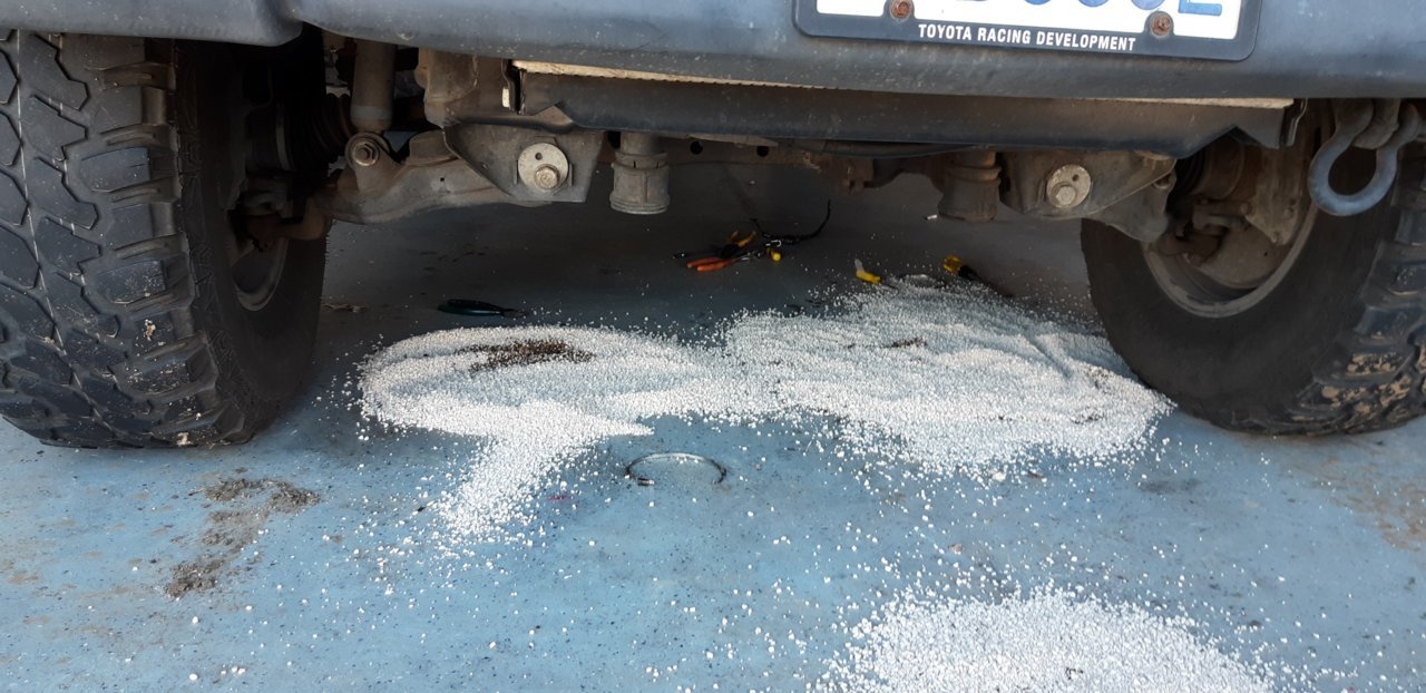

    Found the problem with my kids power steering. Rack is shot. Pulled the dust boots off the ITREs and a quart of power steering fluid dumped out.
    2 problems with that... The dust boots are to keep shit out, not in... our power steering racks take ATF (red) fluid, not Power steering (yellow) fluid.
    Used rack off a 2001 Tacoma will be here on Tuesday :thumbsup: (better rack guide than the pre 00s had)

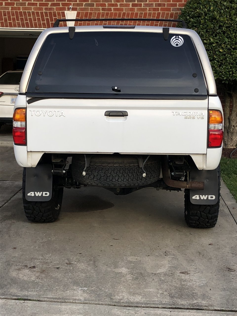

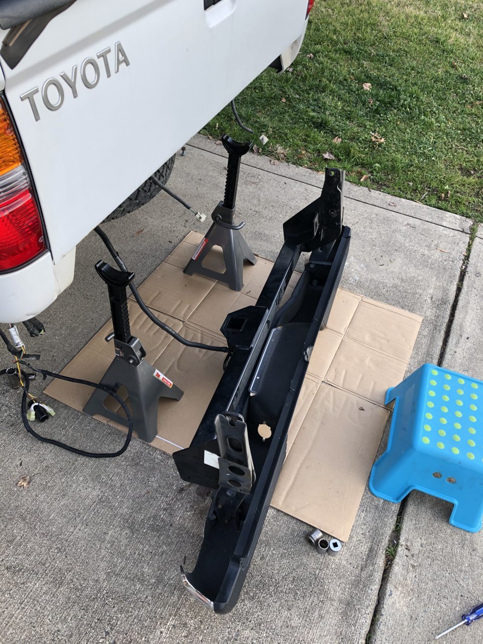

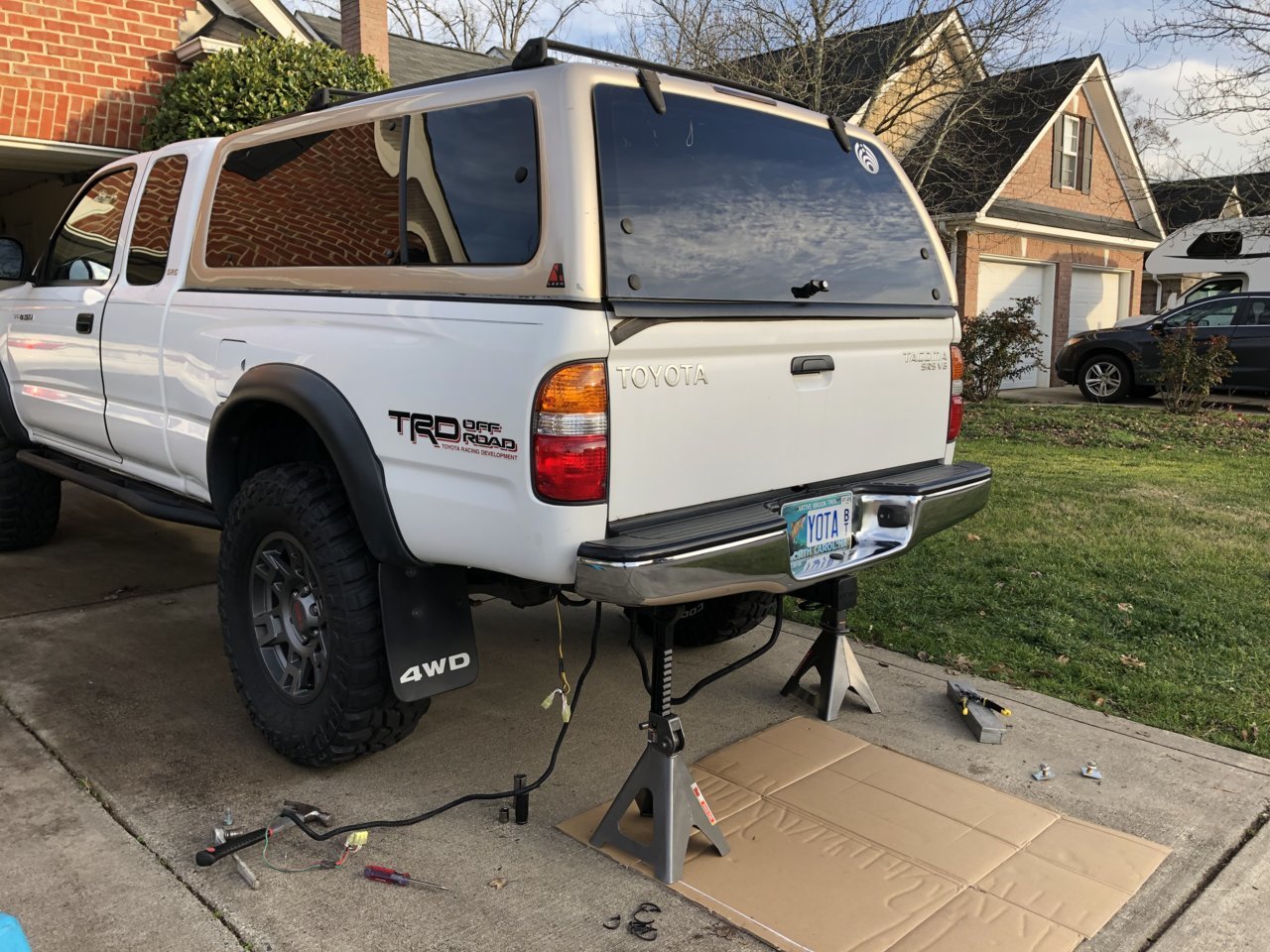

    Realized pretty quickly that me and the lil’ lady were not going to be able to put on this 111 lb. son of a bitch so it’s bumperless until I can get reinforcements tomorrow.

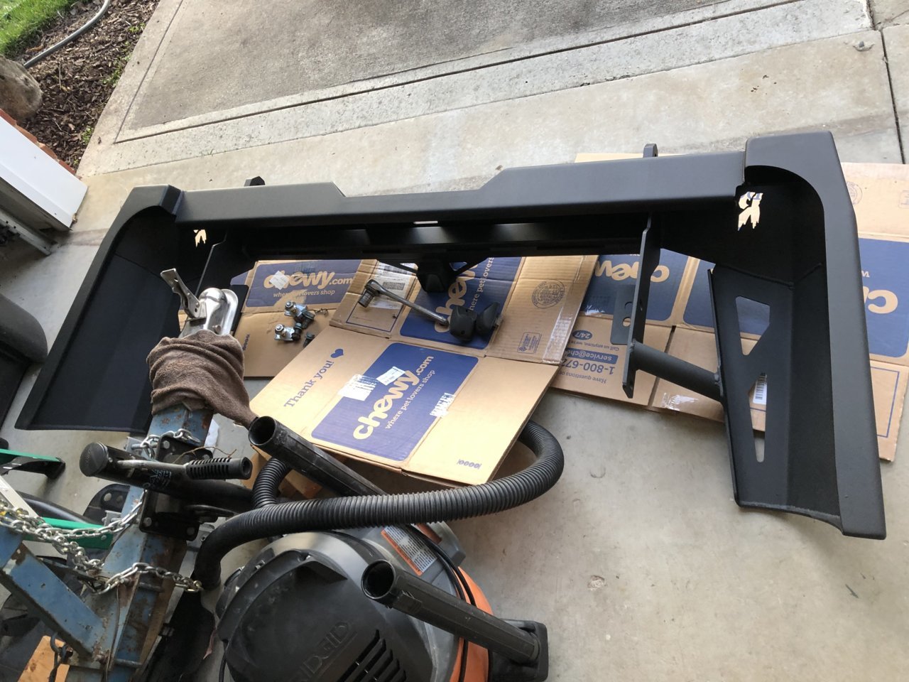

    NICE bumper man! :thumbsup:
    Wish you were on the Left side of the Country... I'd be there in a heartbeat to help.
    Actually no... I wish I was on the right side of the Country. I'd never wish for anyone to be in this shit hole. lol

    Haha, thanks man. I’ve been out there a few times, beautiful part of the country. Too expensive for me though. Hoping to have this thing on by tomorrow.

    I used my floor jack and a stack of 2x4 blocks to very sketchily get my bumper in place.

    I had my floor jack under it and a couple jack stands but it was not balanced well and I had her trying to steady while I lined it up. I could see it dropping on toes so I’ll hold off until I get a couple of guys to help in the morning.
