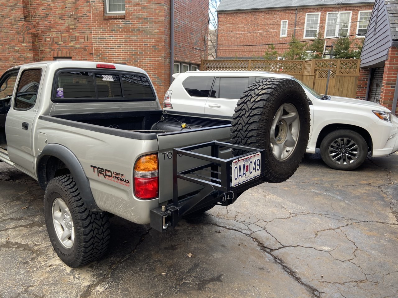

    Great idea! Awesome. You got to have a way to keep those Jerry cans out with the spare.

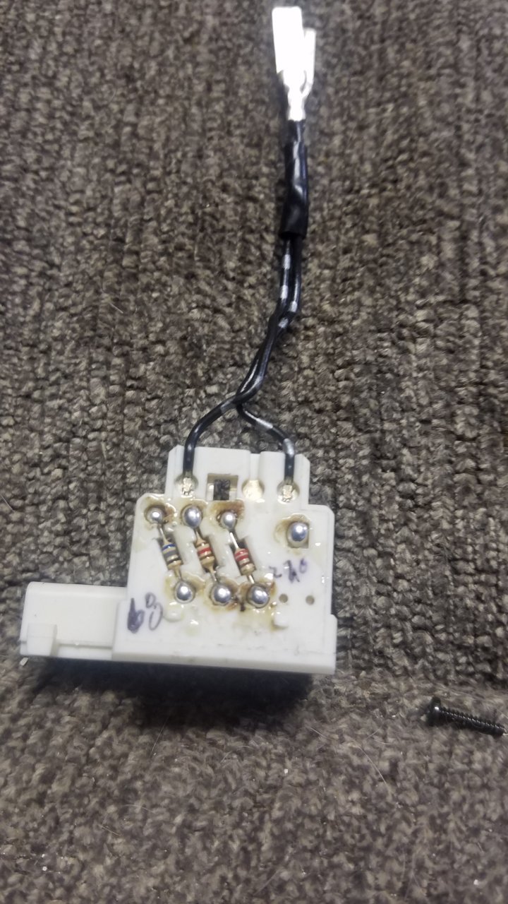

    Damn mechanicjon you've really got down into the nitty gritty with the 12VDC stuff! I remember that circuit board you made a few years ago for those lights, that still going strong?
    Looks like quality work man:cool:

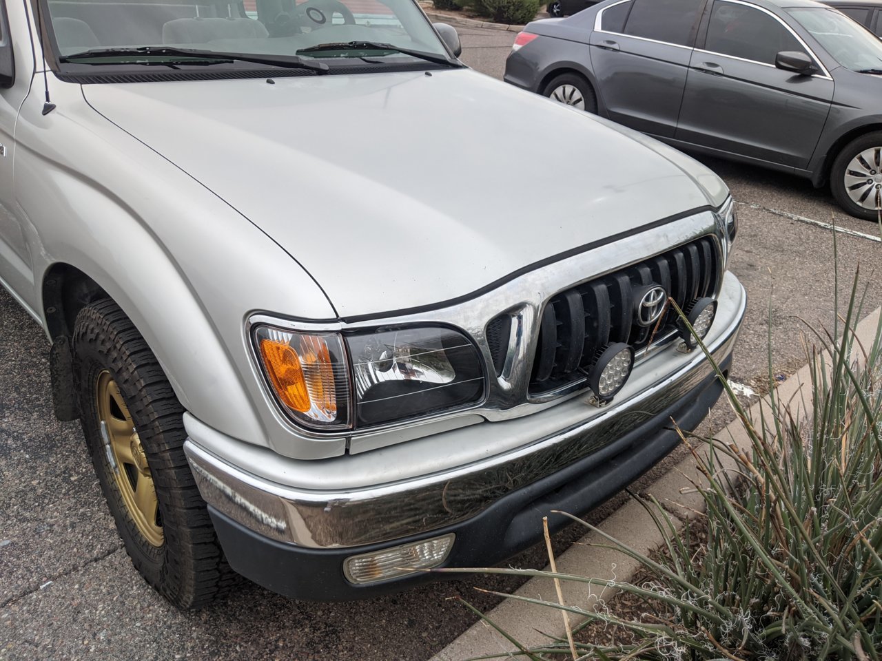

    Can't speak for him, but my gf got me the spec-d tuning one's from fleabay and they have been good so far. Prepare for a shitstorm removing the grille to install. Most of the plastic rivets will break, i ziptied mine up instead of replacing; much better lol

  17. Jan 1, 2020 at 1:07 PM
