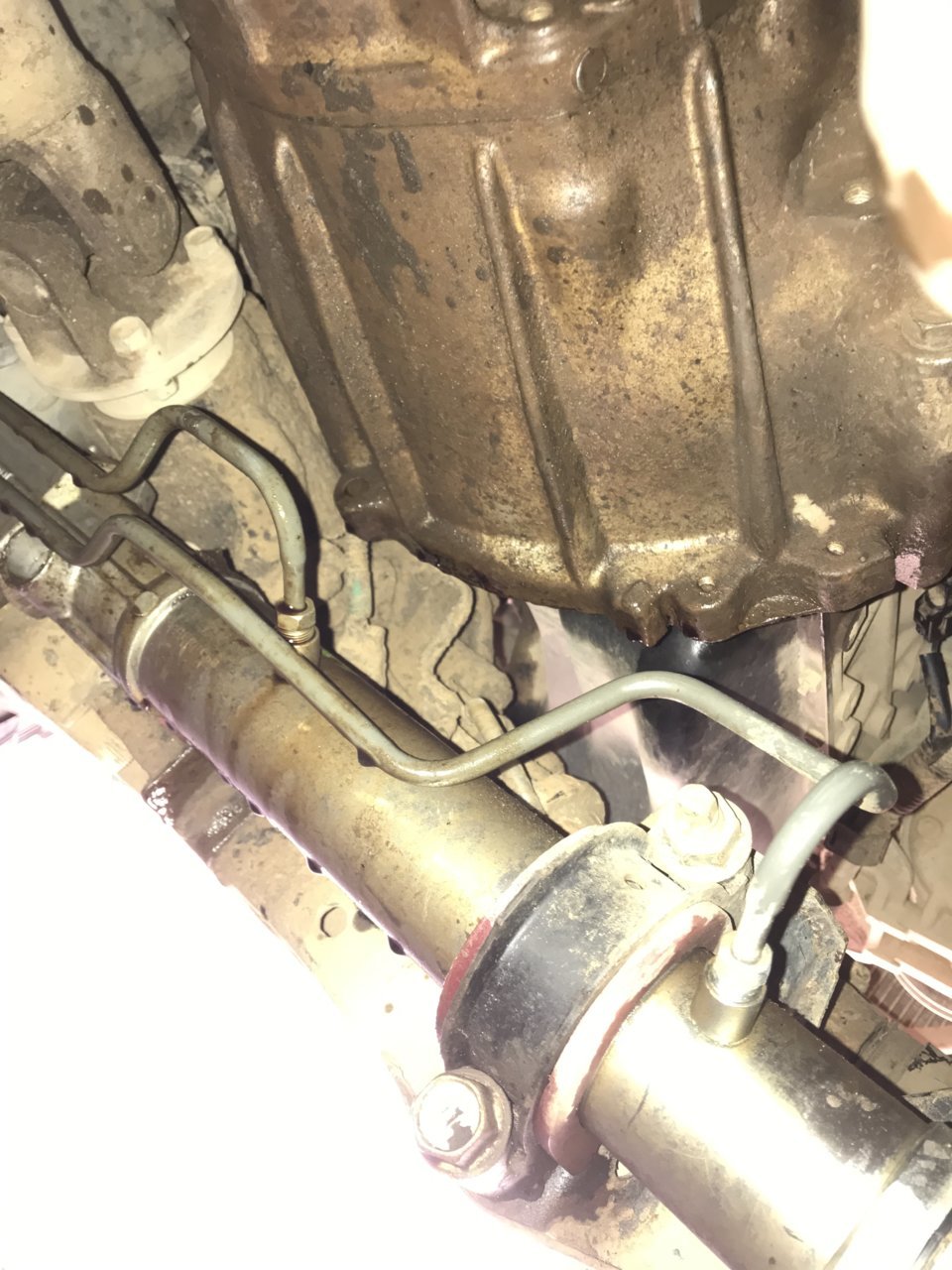

    If you're sure it's the rear main (and not coming from the rear portion of your valve covers, then running down) the rear main really isn't as bad as people make it out to be.
    ***edit*** That looks like oil to me, it's not red is it. If oil is coming from between trans and engine it is definate rear main... if those drips are red, I'd say your input shaft seal on your trans.

    Its 5-speed so no ATF. That’s what I was saying it doesn’t have an odd odor so I know it was diff fluid so it’s not a transmission leak.
    Nope it’s oil colored haha. My valve covers leak but not this bad, but with just a quick look I think it’s rear main. Will look more into it but I’ve got a business trip this coming week.....

    Ah gotcha. Looks pink/red in the photo so I thought maybe trans or power steering leak. But if it's engine oil then yeah

    Yeah the pic isn’t very good, but it’s definitely oil so off the find some write ups and order parts

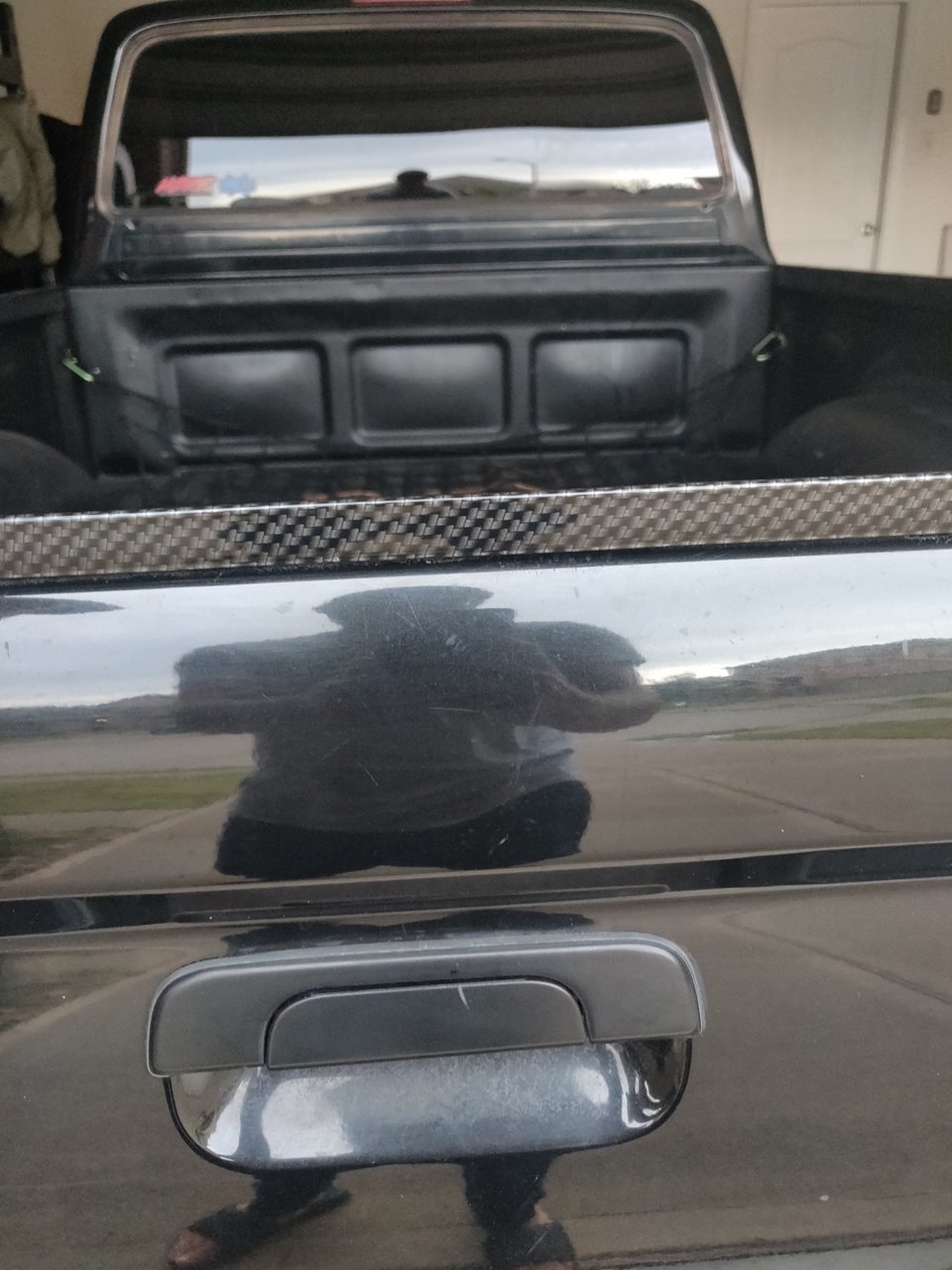

    Just ordered me one of these carbon spoilers and also a little carbon wrap to do the chrome on my door handles and I have a roll big enough to do a hood or roof wrap with.

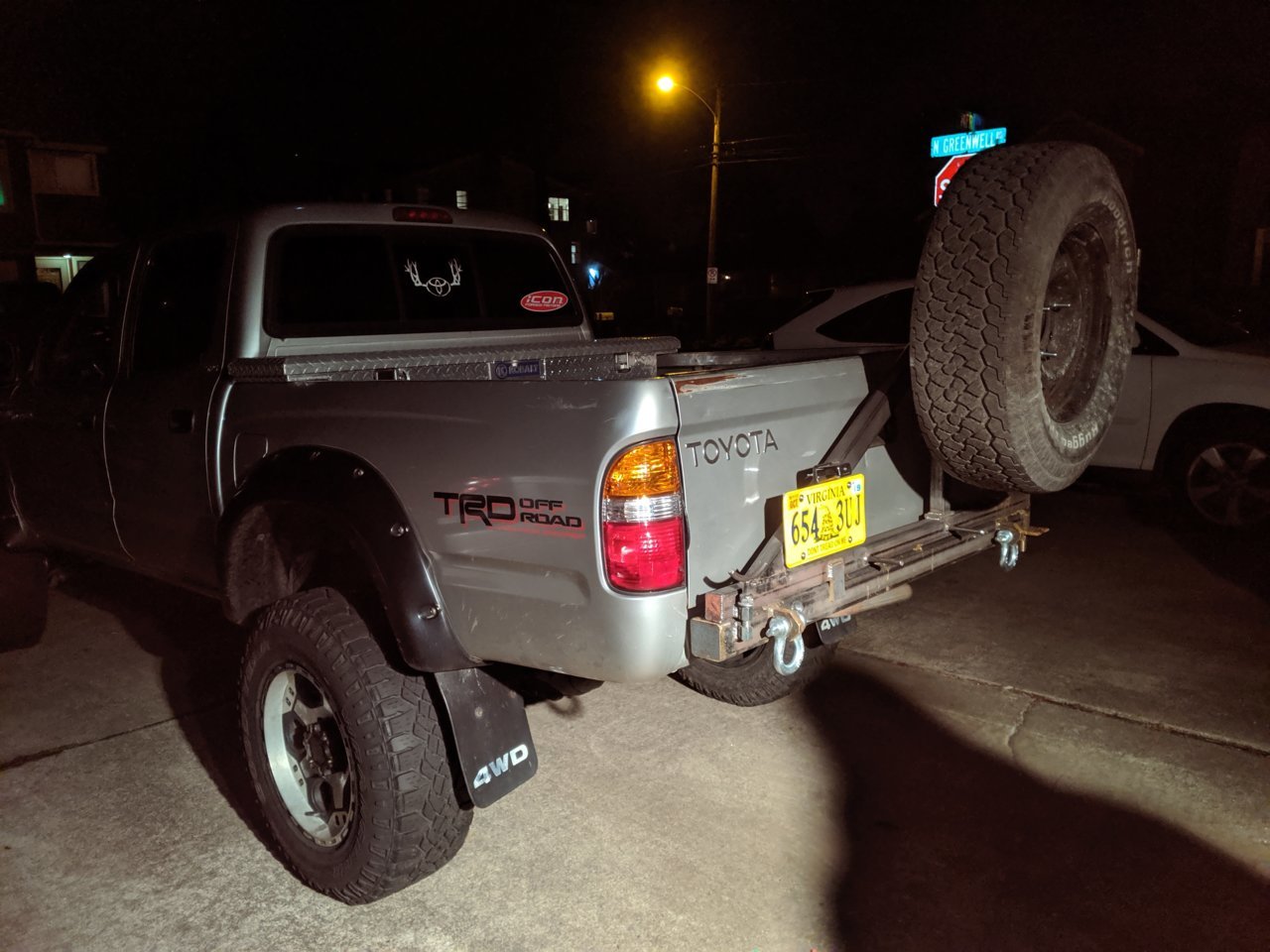

    Finally Have gotten close to finishing this rear tire carrier . Need a paint job and to get the jack studs threaded but what you all thinkIMG_20200105_192152.jpg
  17. Jan 5, 2020 at 5:17 PM
    Fernando
    Fernando Hammerdown
    Aug 25, 2012
    #85507
    23,448
    Fernando
    Sacramento
    04 Tacoma DC 4x4
    Too many, See Build
    Looks good dude
