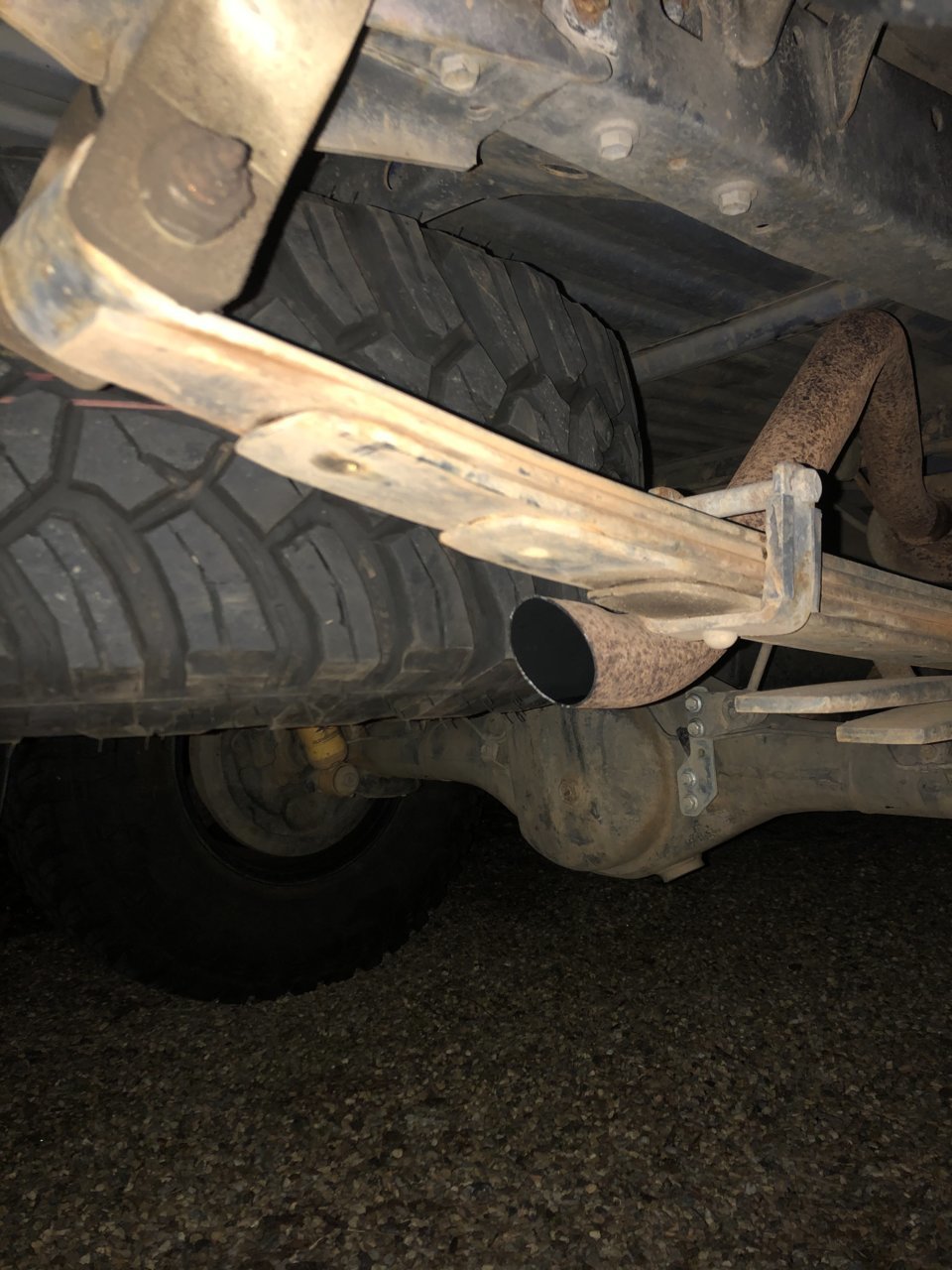

    Rotated my tires and chopped my exhaust just before the leaf spring.
    Hopefully it doesn't hurt the spare tire being that close.
