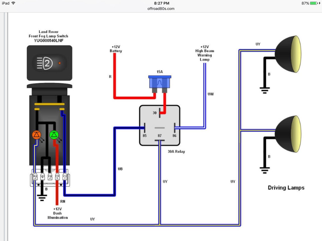

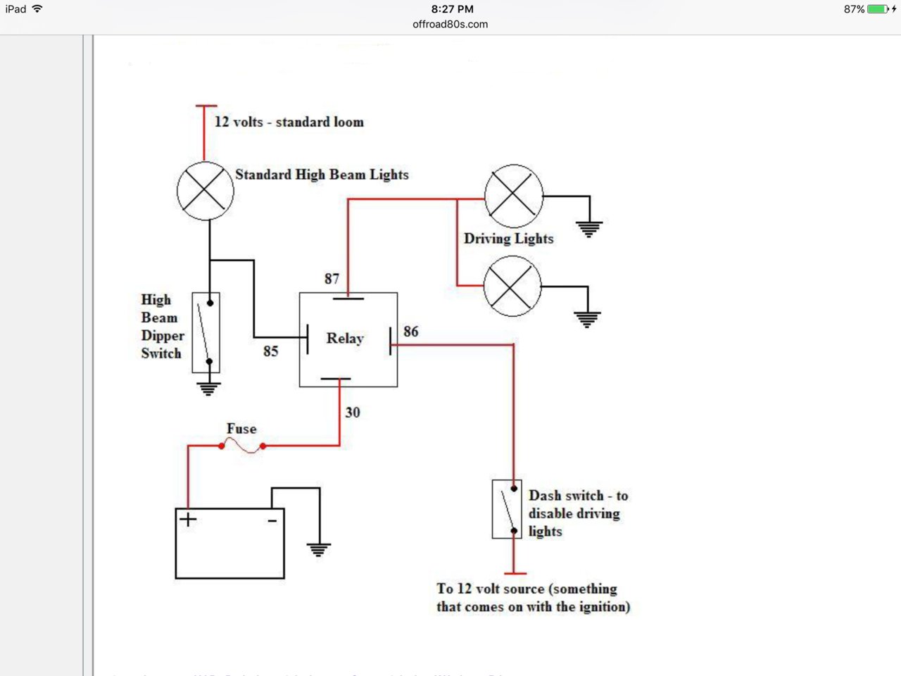

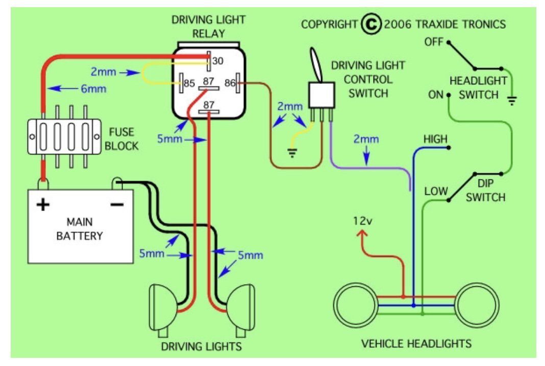

    Be careful with some of those diagrams, they are not all the same.
    The green one is mostly correct, but it assumes that you have a relay that does not have an 87a terminal in the middle. Just connect both lights to the 87 terminal.
    The thing to keep in mind with 1st gen tacoma headlights is that they are ground triggered. You always have a 12v+ signal at the headlights, the high beam trigger that people keep referring to actually gets connected to ground through the headlights switch. If you have dual filament (H4) stock headlights and tap into this circuit, you will actually send power through the low beam circuit as well. This is due to the fact that the high beam indicator on the dash works through the low beam filament (confused yet?).
    The best way to trigger aux lights from the stock high beam is to ground trigger your relay for the aux lights. This ground wire from the aux light relay just needs to tap into that high beam wire (which is only connected to ground when the high beam stalk is activated).

    The other confusing thing is type A vs Type B relay. https://www.12voltplanet.co.uk/relay-guide.html
    The thing to remember is that a relay is just an automated switch.
    The pin numbers are the same, but 30 and 86 get their locations swapped. 30 and 87 are always the switch, 85 and 86 are always the coil. When the coil gets energized, the switch closes.
    87a just does the opposite of 87. 87 is NO (Normally Open) and 87a is NC (Normally Closed).
    30 goes to the battery and 87 goes to the aux thing you're turning on. These could also be connected to ground if you had your aux thing supplied with 12v constant from the battery. Just think about it like you are moving the location of this switch to the ground side of the light, as opposed to the positive side. It's still usually better to have the relay on the positive side to limit the length number of constant hot circuits.
    86 and 85 can be interchanged, one gets power the other gets ground. You can then put a switch on either side (power or ground). These are what automate the switch. In this case your switch is the high beam switch ground, so you connect it to the ground side of this relay.
    Make sense?

    Yes I meant 87, I'll correct my original post.
    If you have 86 hooked to 12v+ then yes, connecting 85 to the high beam wire will trigger the lights.

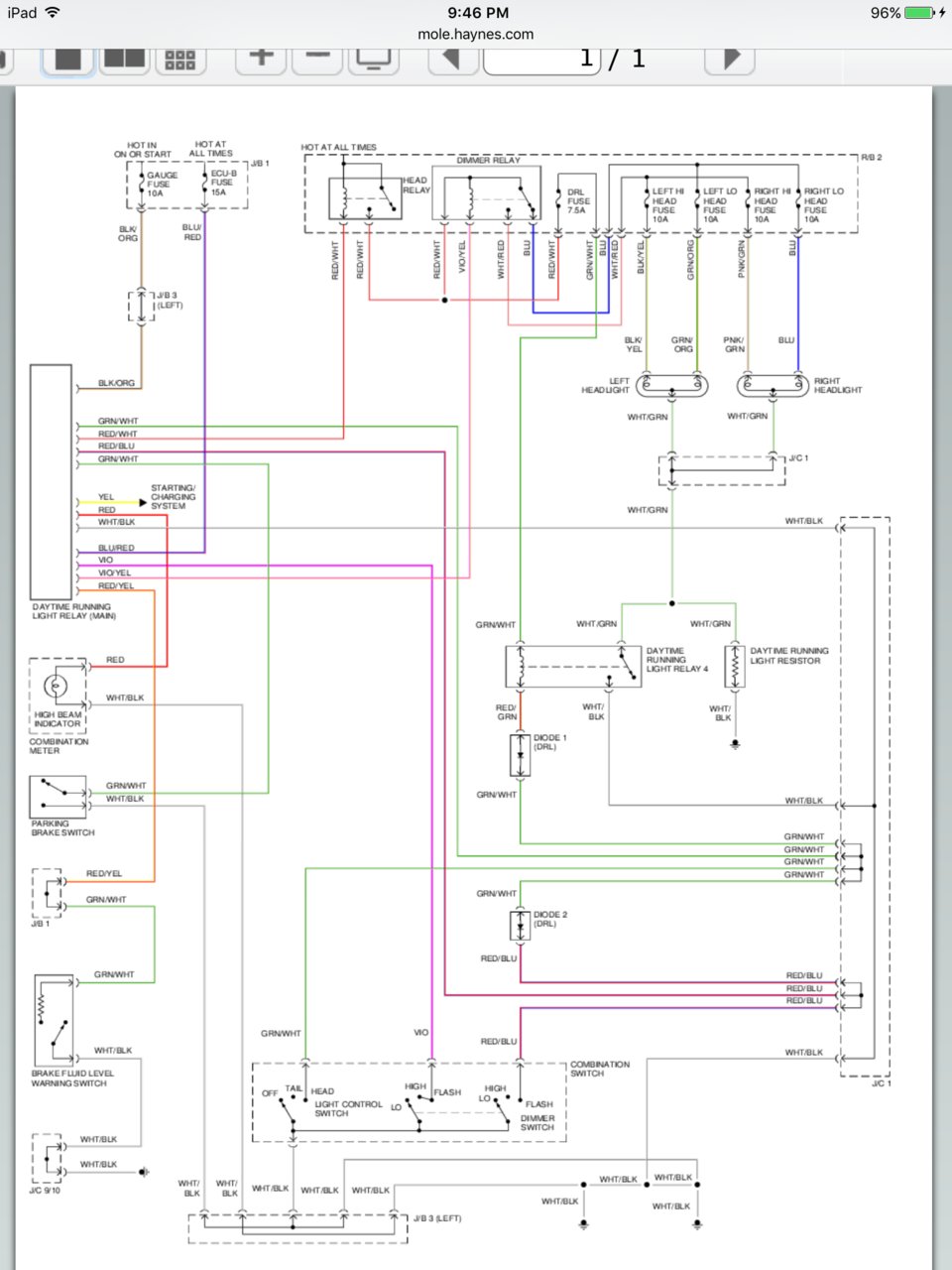

    Easiest spot is at the headlight. You can also find it near the headlight stalk.
    Red-Yellow (R-Y) is the high beam ground
    Red-Green (R-G) is the low beam ground
    Red-Light Blue (R-L) is 12v+
    If you look at the diagram attached you'll see that the high beam indicator is actually on the low beam wire. When the high beams are activated, power travels through the low beam filament and to the dash indicator. It doesn't illuminate when the low beams are on due to resistance. This is also why the high beam indicator doesn't work when you put in LEDs or HIDs, because there is no low beam filament for the power to travel through.

    Id recommend still having a switch in the cab that is separate. It is still technically illegal to do this and if you have the switch you may have times where you want the brights but not the spots. That and it can get you out of a huge ticket if that every happens.
    Very easy to do. Just have to run the wire you tap from the Hi Beam into the cab onto a switch and then back to your relay. Its just ground so it's not super dangerous either.

    Just get a SPDT switch and use the high beam ground and chassis ground. One position turns on with highs, one position turns on anytime, one position is off. That's how I have mine, except I used a relay to get 12v positive when the highbeam is on so I could easily use another relay in my bussmann rtmr to power the lights.
