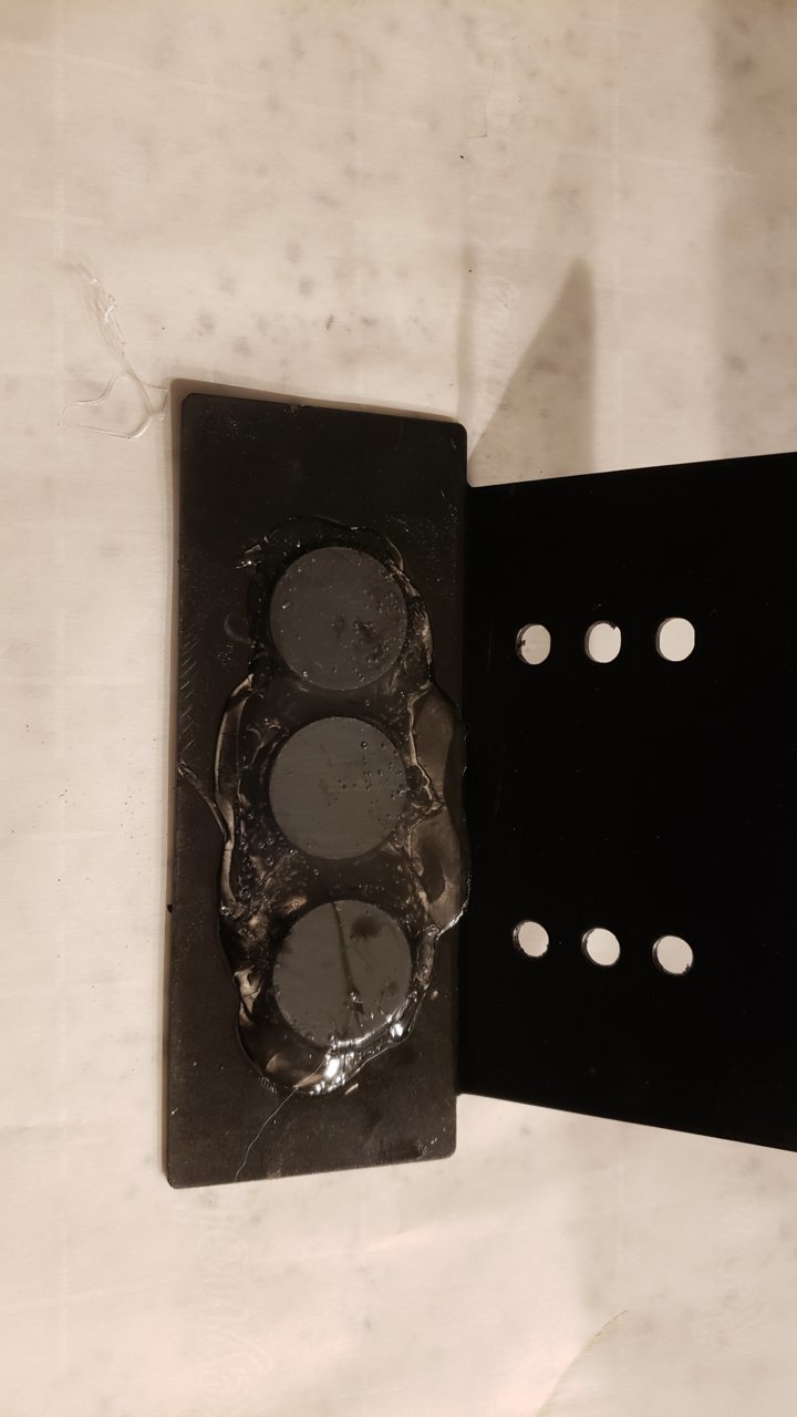

    So the Scanguage - Ultraguage - Torque App discussion from yesterday got me thinking. So I decided to figure out a different mounting location for the phone I run the Torque App on.
    I previously ordered a switch panel from Paranoid Fab... I requested the switch cut outs NOT be cut out, and they happily obliged. (Didn't know exactly what, if anything, I was going to do with the mount when I bought it)
    https://www.paranoidfabrications.co...products/1st-gen-tacoma-ashtray-switch-holder
    So, I was working on some other stuff, and I decided to give something a try.
    I had some 1 inch round magnets. So I drilled 3 one inch holes in the mounting bracket. Then I used some Automotive Goop to glue the magnets in the holes flush with the front side.
    Here's the front
    Here's the back

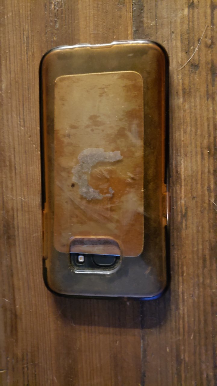

    Cut a piece of 16 guage sheet metal and put it inside the phone case. (This is the same princple my magnet dash mount works on, but this piece is bigger to cover all three magnets... and also, now I can use the dash mount for my regular phone)
    The paint ran on the front face of the mount... but it turns out it wont matter. I ordered some textured rubber adhesive sheets. I'll cover the face of the mount with one of those. Between the magnets and the friction on the rubber, the phone should be mounted solid.

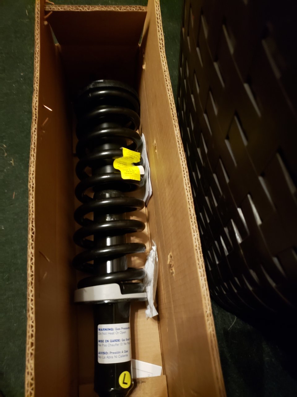

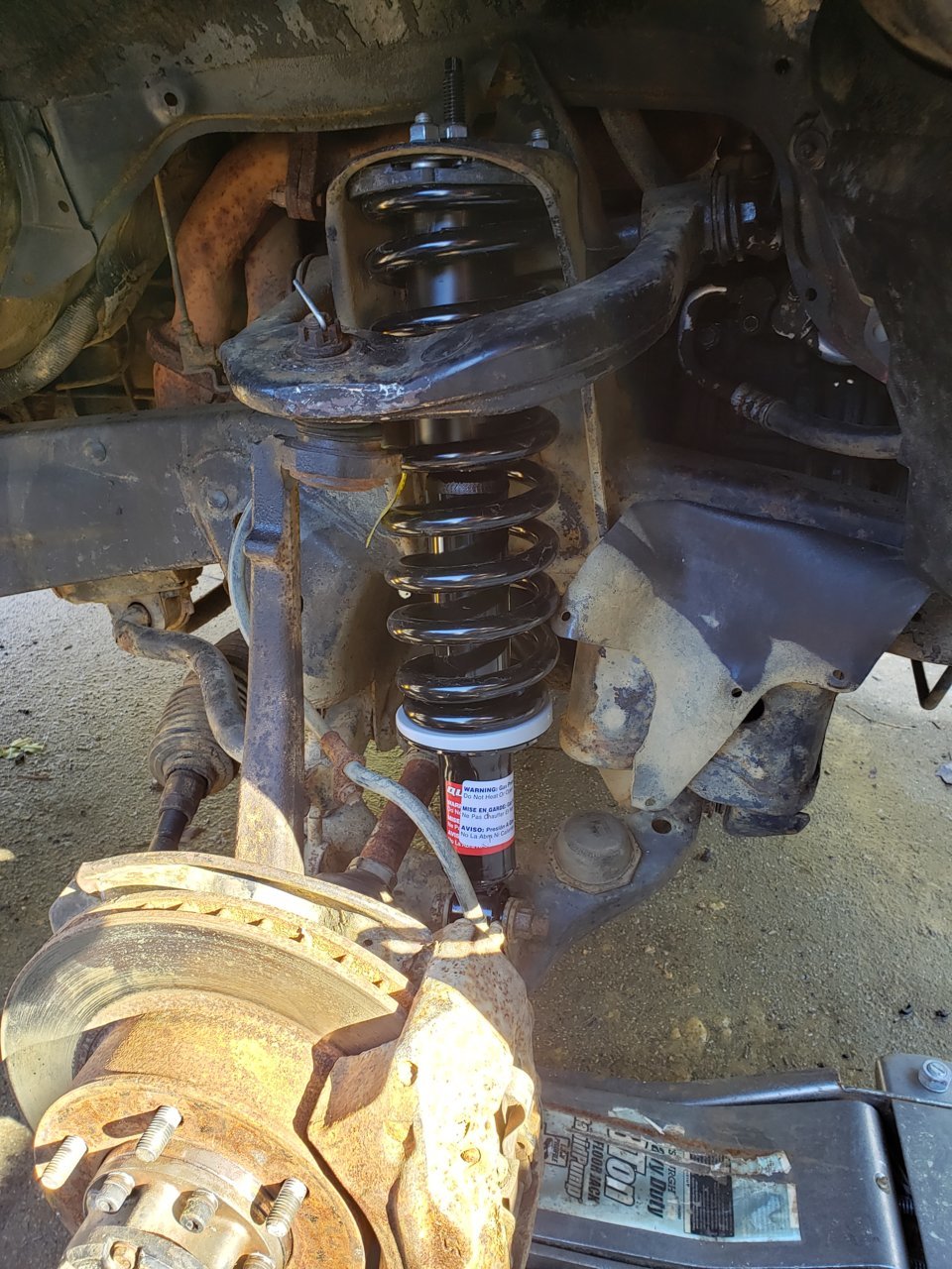

    Bought this for my stepdad and put new front end on it. It’s v6 5spd 4wd with 160k. And I got to show the progress on my second gen
    8B76CE1A-4308-4FD7-98A6-6110ED7DFAA7.jpg 9434E487-708A-4AA1-A327-FC6129AAA125.jpg
