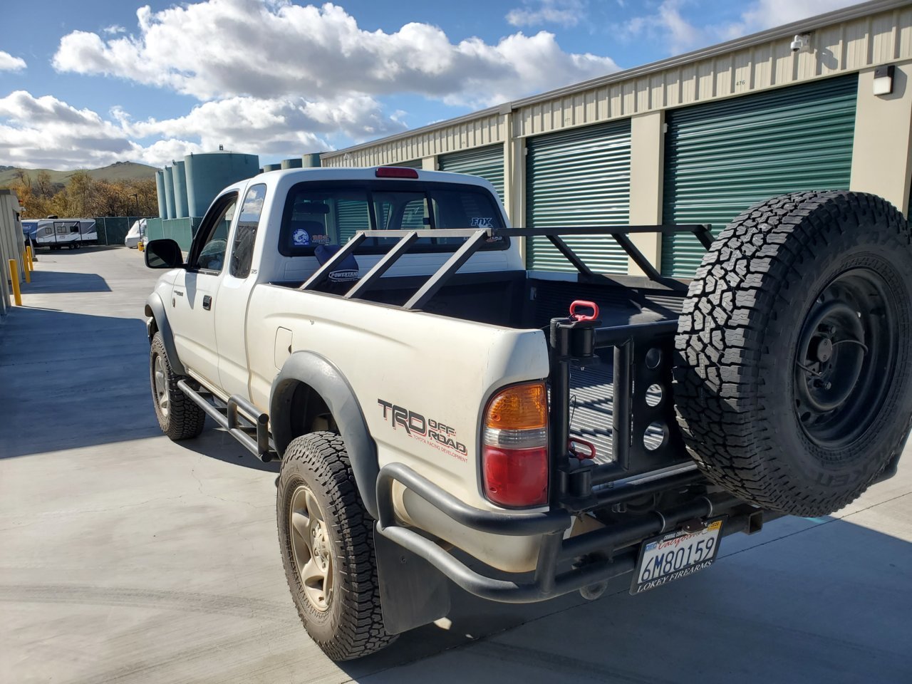

  9. Jan 13, 2020 at 9:13 AM
    Kwikvette
    Feb 27, 2019
    #284735
    81,614
    Fresno County
    4 run, 2 don't
    Man that looks sexy.
    My ARB is sitting against the side of my house :pout:

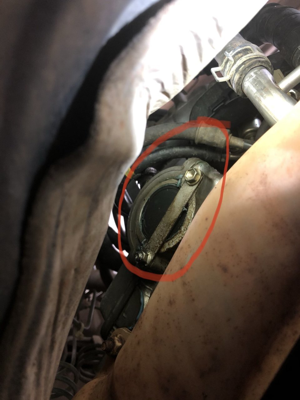

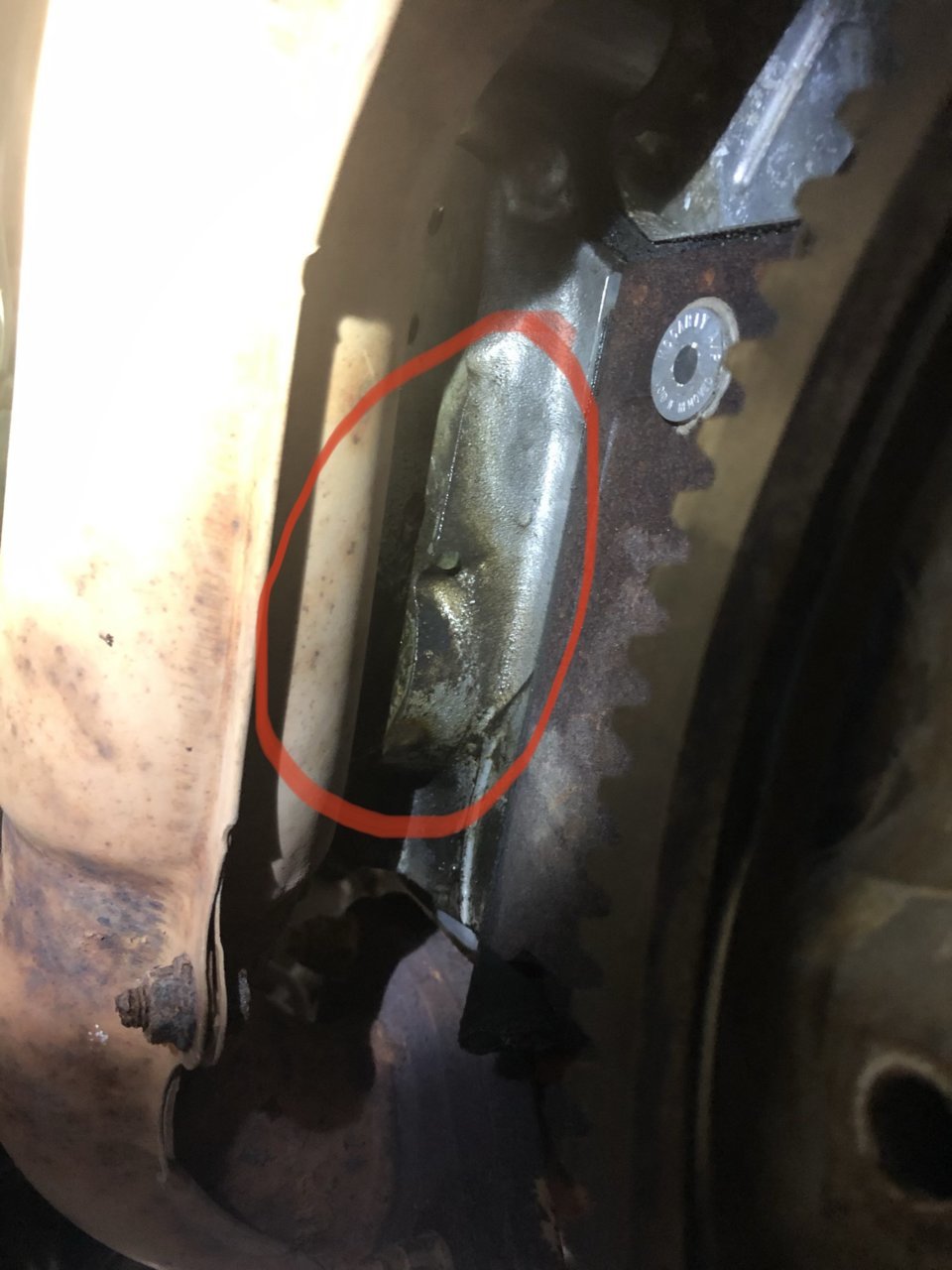

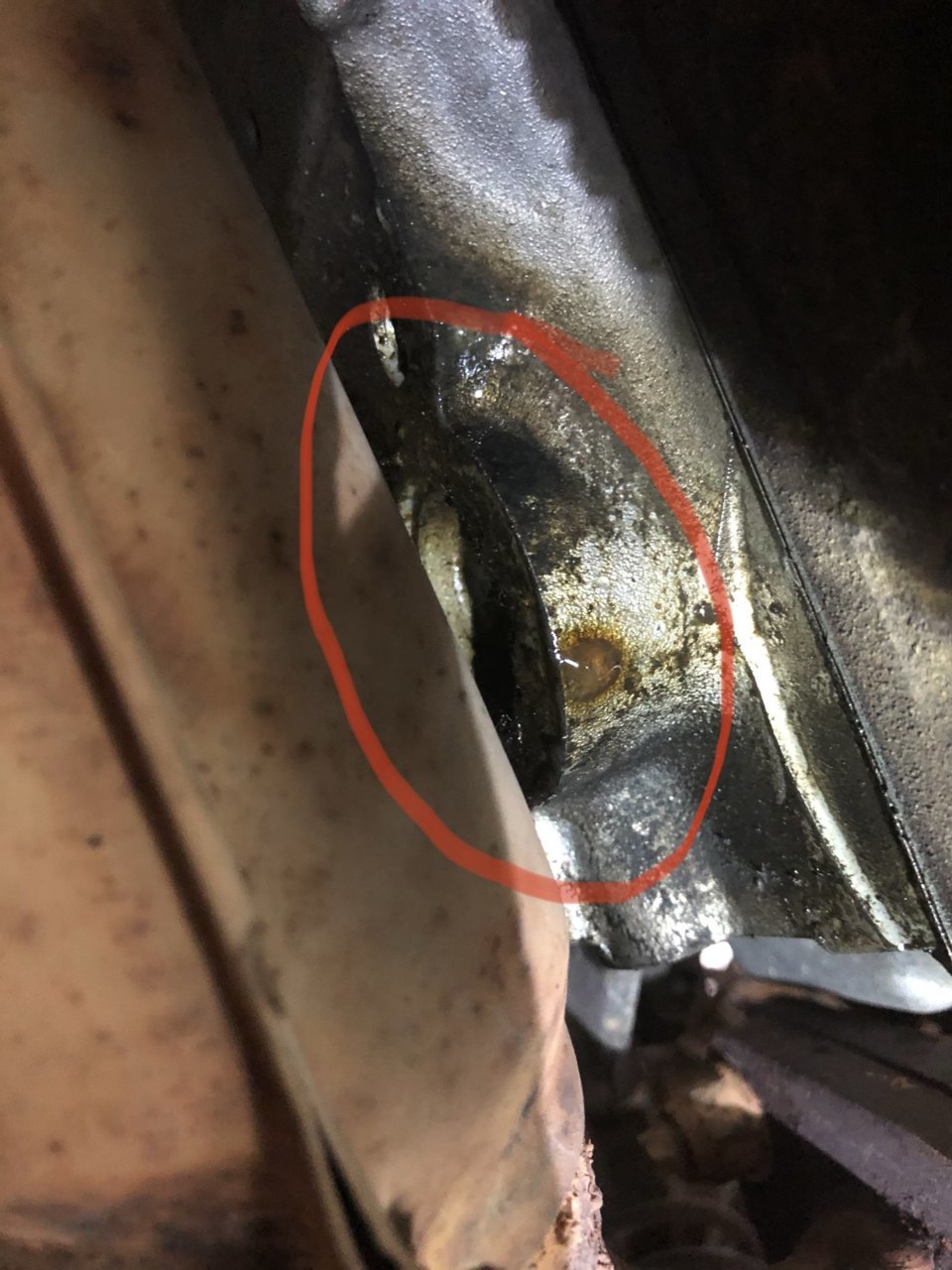

    Dropped my transmission this morning to replace the oil pump seal. While under the truck I noticed a very small puddle of antifreeze...keep in mind the truck has been sitting in the same spot on jack stand for over a week now. My first thought was that my heater valve must be leaking again, maybe it finally found its way to the floor somehow. Upon further investigation the heater valve is dry as a bone. The coolant appears to be coming from the back of the driver side head? I looked all over up top, and haven't found anything. What is this that's leaking? Or where else could the leak be coming from? It's certainly coming from the drivers side

    Good chance it’s the coolant bypass pipe leaking. Under the intake plenum. They leak and fill the valley up till they leak out the back of the block

    This. Mine was leaking coolant in the same spot, ending up being the coolant bypass pipe. Not the easiest job, but definitely doable. If that is the issue, make sure to replace the knock sensor wiring harness while you're in there, they tend to get brittle.
    Edit: @kuntry09

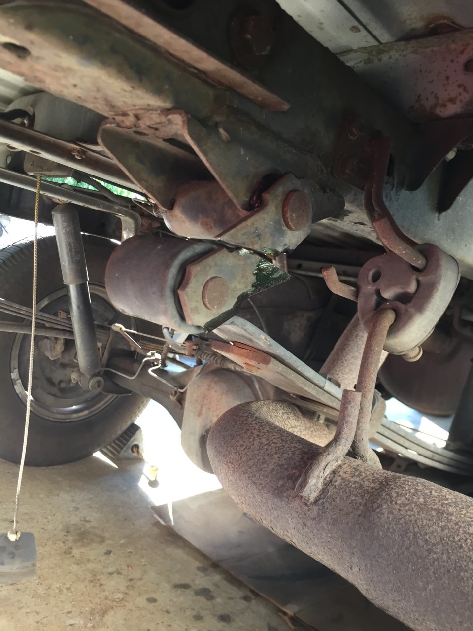

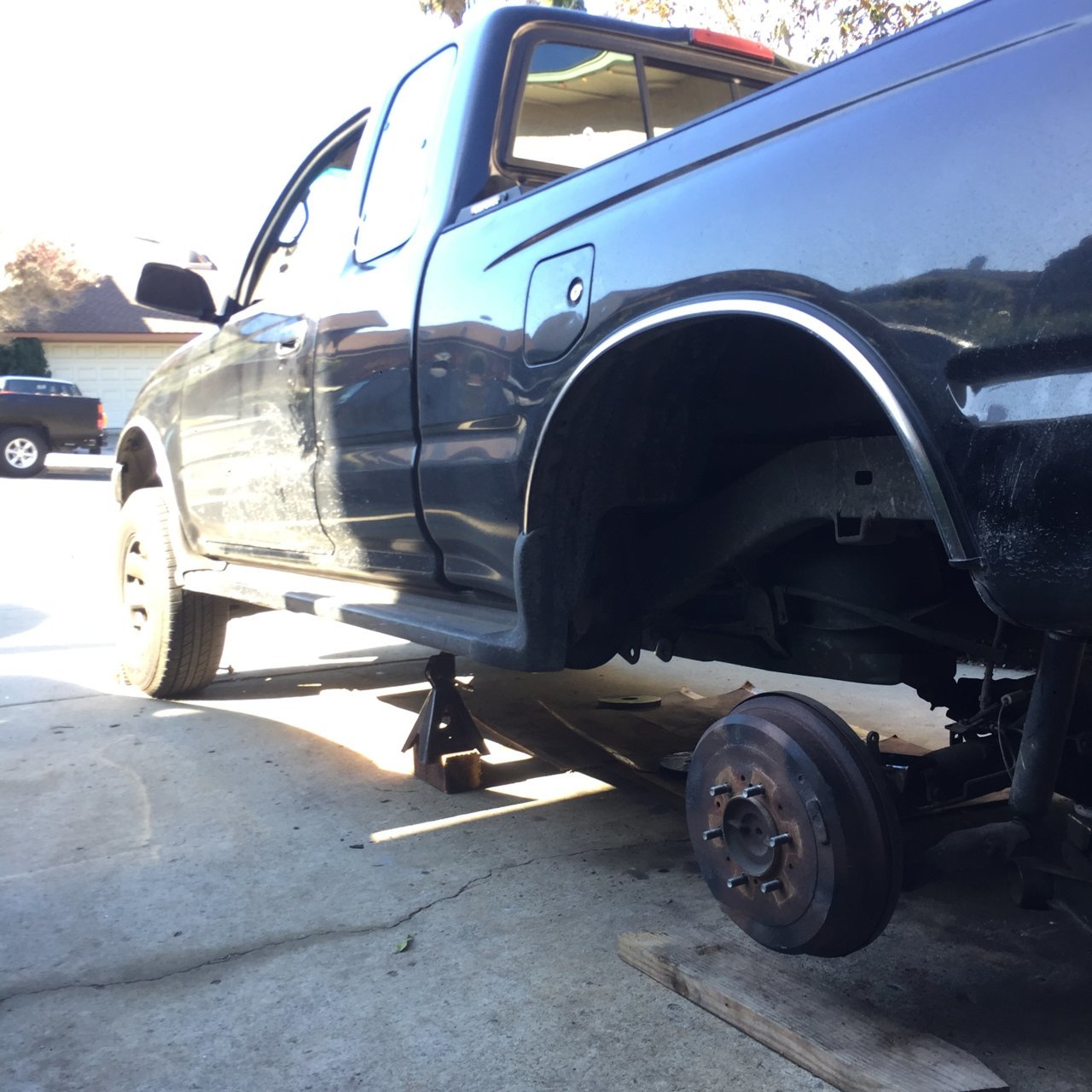

    Replaced old/broken leaf springs w/ relevant hardware and rear shocks this past weekend. First time really working on vehicles mostly by myself (with some friends' help). It rides much better now.
    Edit: pictures
    Also I snapped my parking brake cable last night so that’s fun. It was rusted out.

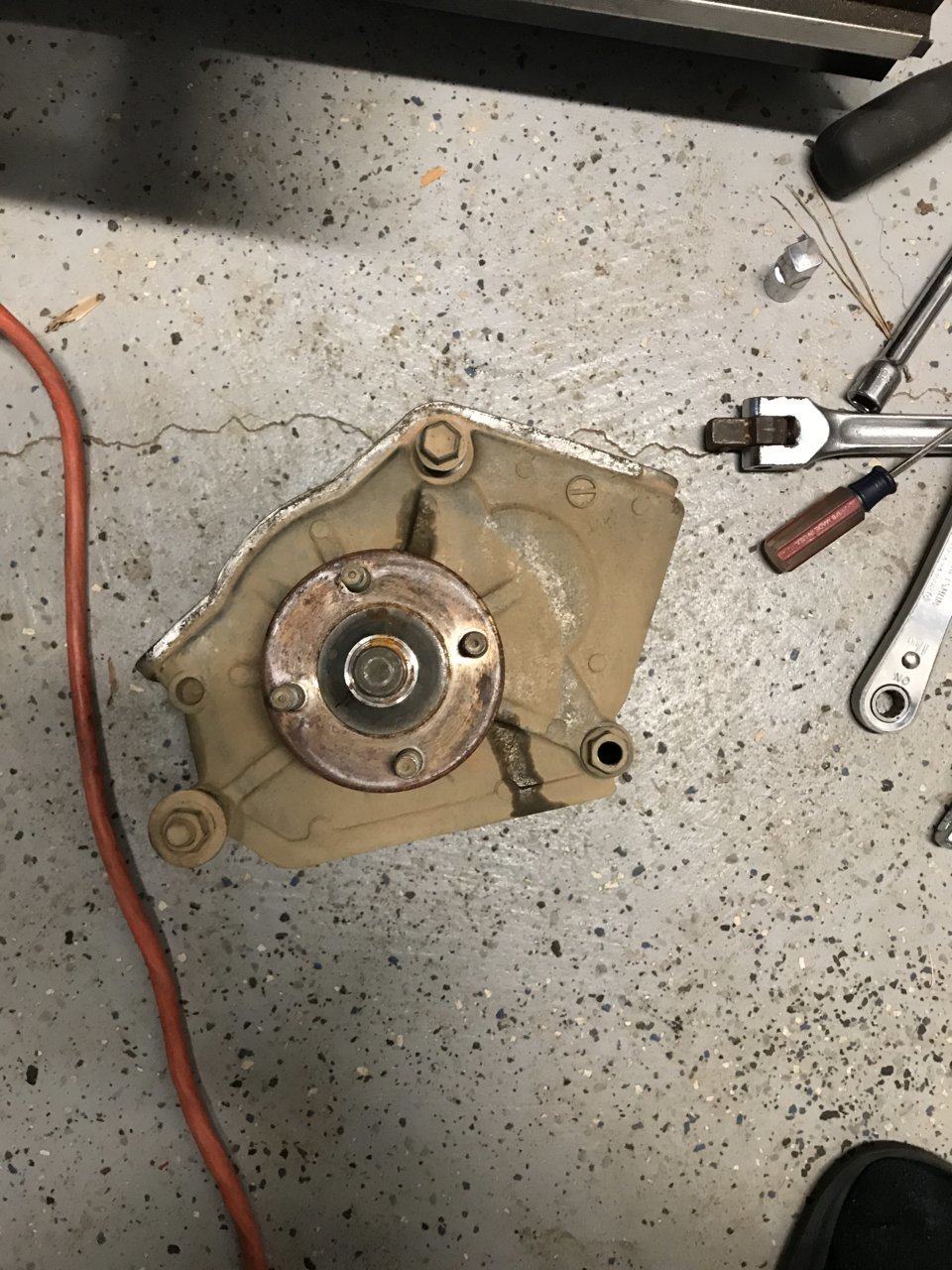

    Parts are coming in my clutch replacement
    Also took the fan bracket off and now waiting for the new one to get here, hopefully it fixes my squeal. Took the belts off this weekend and it went away so :fingerscrossed:
