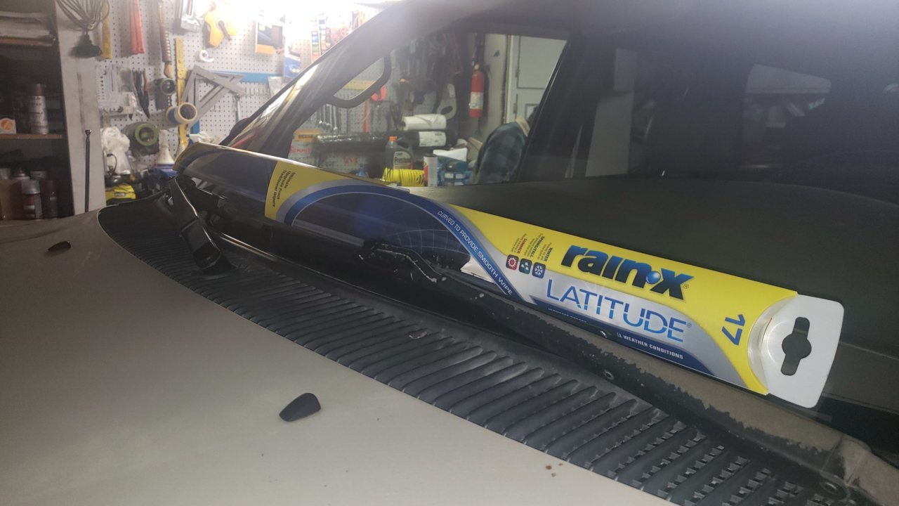

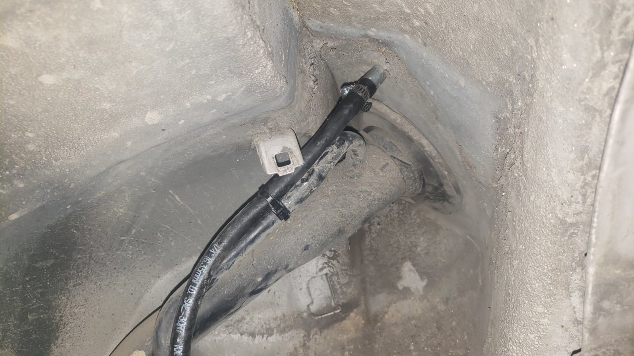

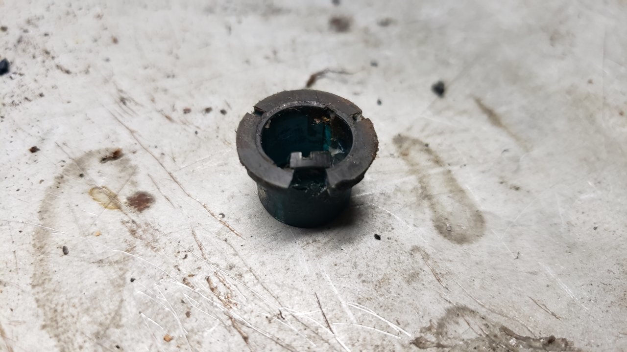

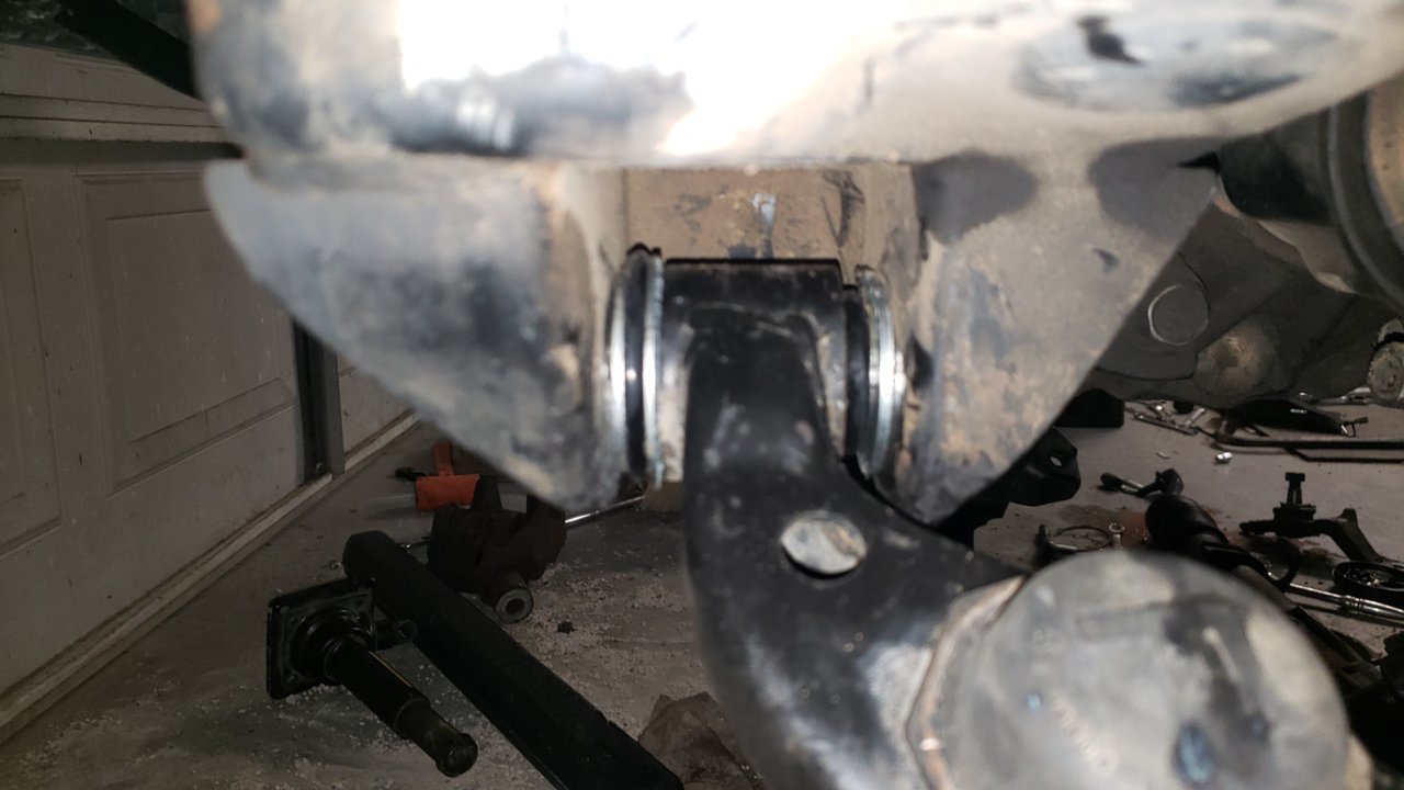

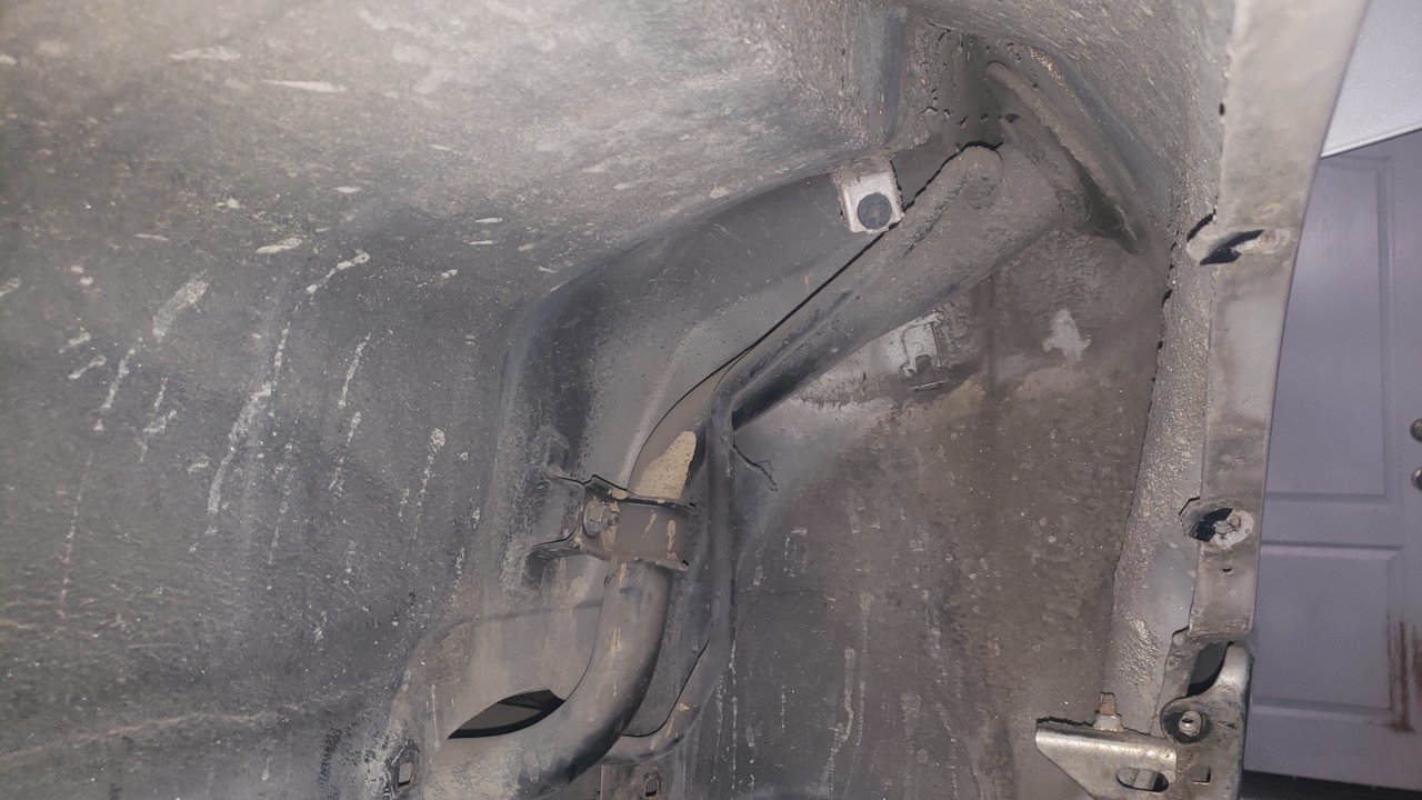

    Small steps are being made on @RobertsT4R
    Whiteline bushings done
    Replaced the bushings in the auto shifter. Feels brand new now.
    Did the diff breather
    And finally replaced the wiper blades
    Still waiting for the Tcase drain plugs to arrive, to change the oil in it... need to grab some more 80w 90 tomorrow so we can change out the rear (for some reason I only have 2.5 quarts)

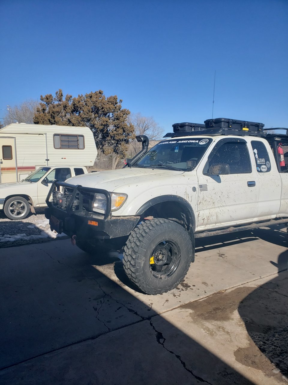

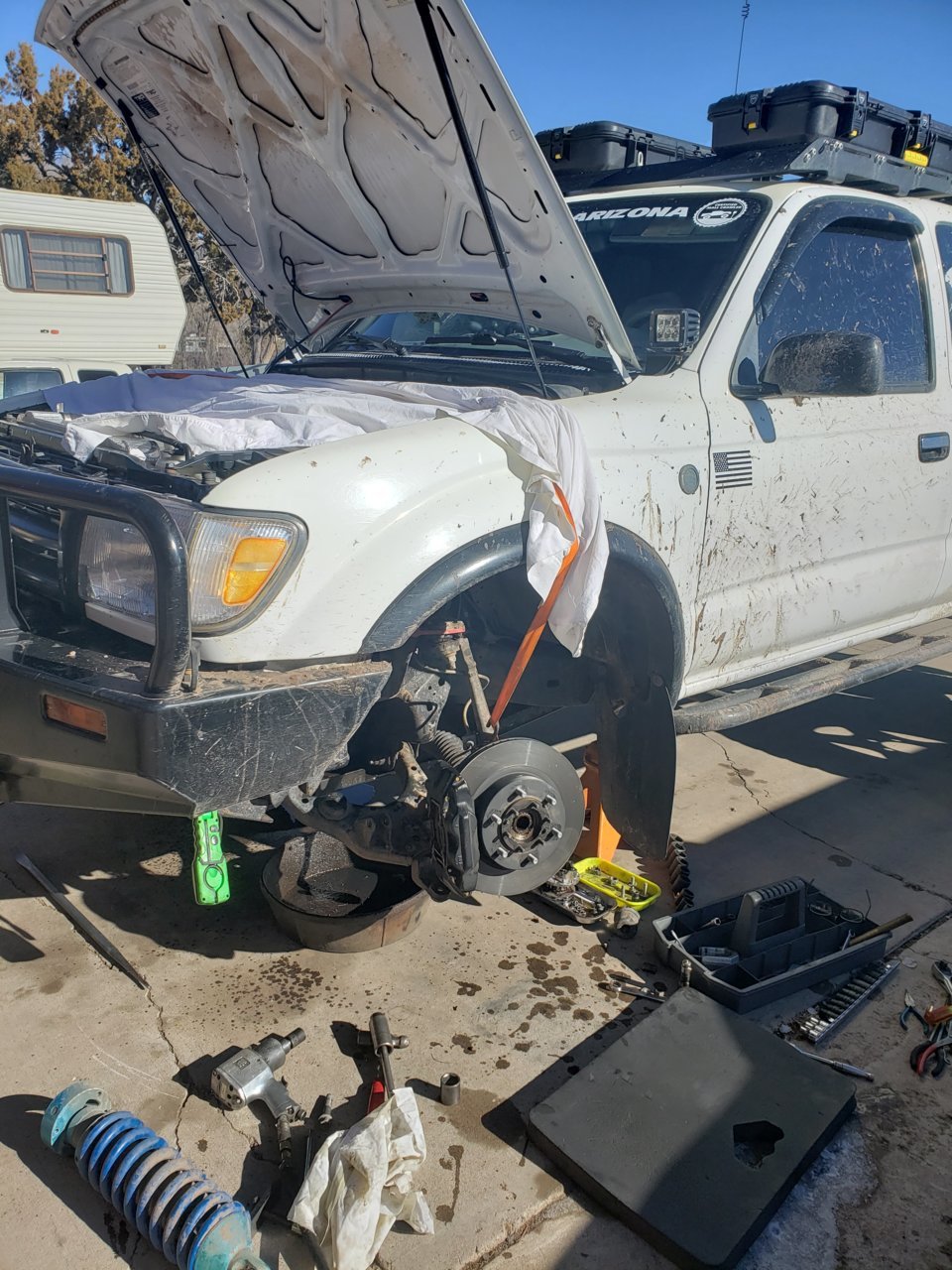

    So I rebuilt the front end this weekend. All new MOOG LCAs, LBJs, Inner/Outer Tie Rods and SPC Cam alignment bolts. The whips minus the Wifeys Subaru Outback.

    Out of curiosity, did you have any front to back movement in the shifter? The new bushings took care of 100% of my side to side movement, but only a little of the front to back. Looking at it I think it's just slop in the linkage, but couldn't figure out where to tighten it up.

    Yes, there was front/back and side/side movement.
    Did you replace 2 bushings or all of them? We replaced 4 of them. Also... some of the the front/back slack can be taken out, a bit, at the linkage... here
    You don't want to go too much on the linkage or you'll have problems with it going all the way in to park... Just loosen the nut, take out the play, and tighten the nut back down.
