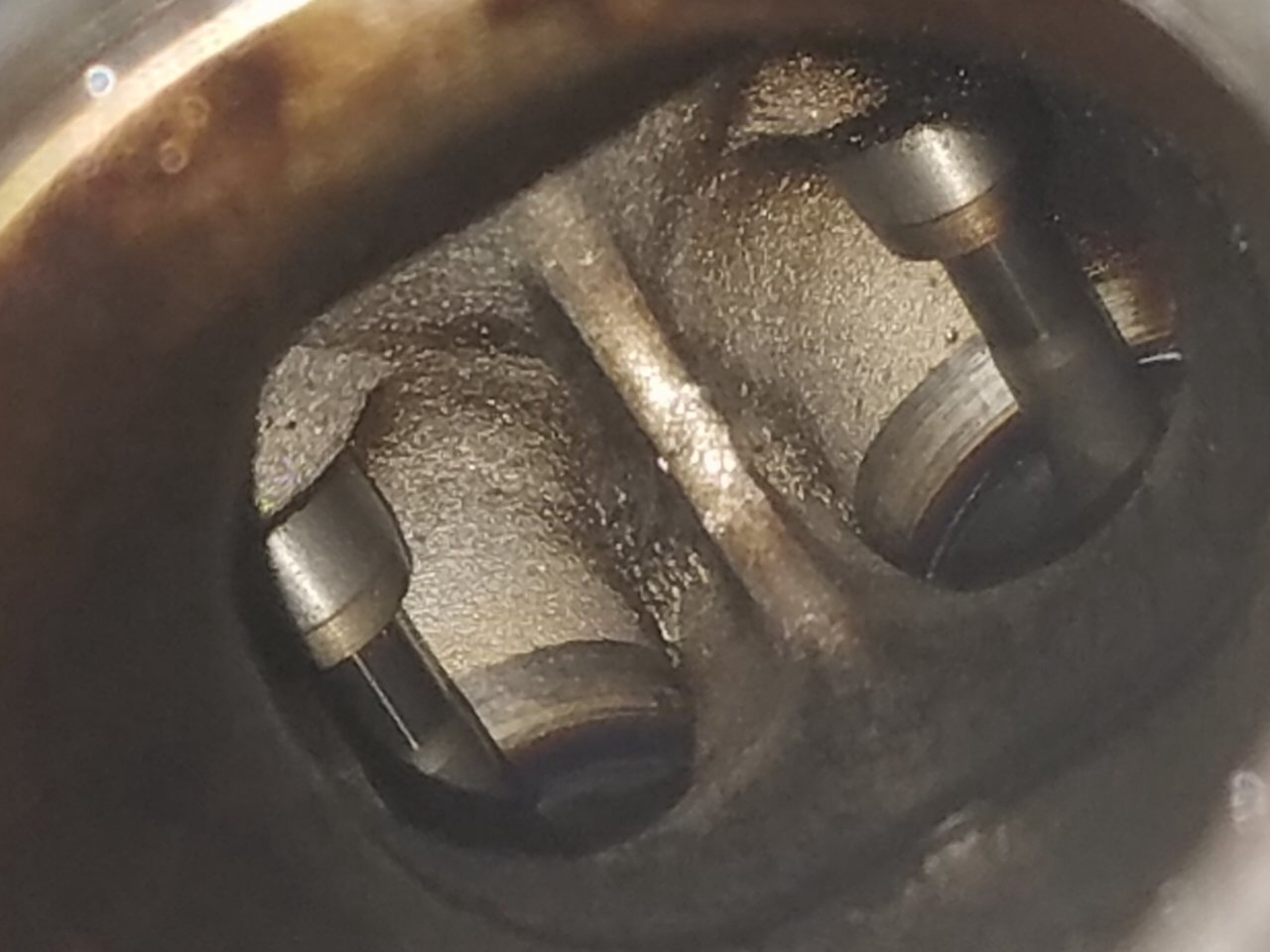

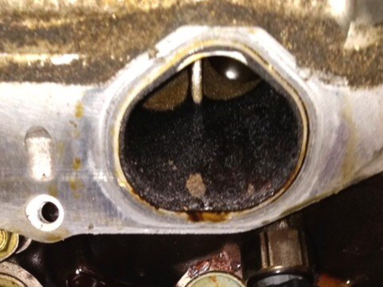

    Speaking of cleaning,
    Nows your time to clean the valves with the plenum removed,
    If you have carbon build up it will cause bad gas mileage and lean issues and ping.
    My valves are squeaky clean because of the methonal kit I run unlike this other 3.4 motor that is choked with carbon.
    Get a flashlight and take a peek in there, if they are full of carbon Marvel mystery oil will Dissolve the carbon overnight

    I'll see what I see, I guess! I get great mileage and I use Techron products regularly. If they are gunked up how would you apply MMO?
